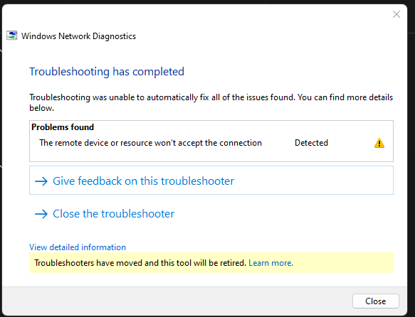

The Error I get:
If I click on Diagnose and let it run for a while  this shows up:
Anyone got an idea what I could try?

The  troubleshooter still gets me the following error:
If I do the same with a known wrong IP to cause the same error message it gets me a different result:
So it is detecting something.
That looks like it might be a port issue.  SMB uses porrt 445.  Is there a chance it's being blocked somewhere or in use by a docker or VM somehow?  It's very close to port 443 used by https://.
