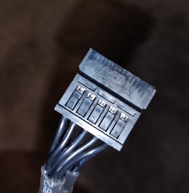

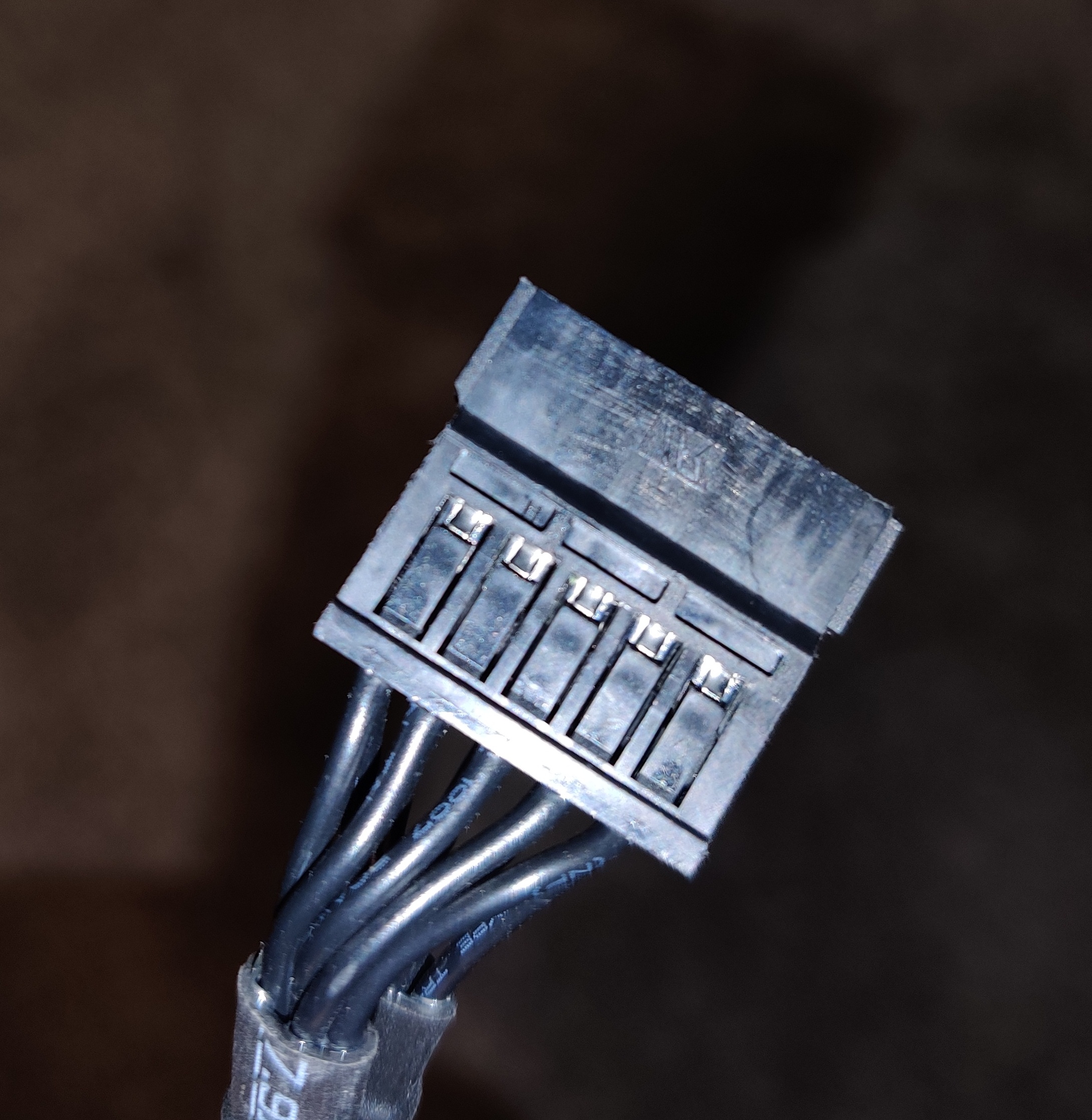

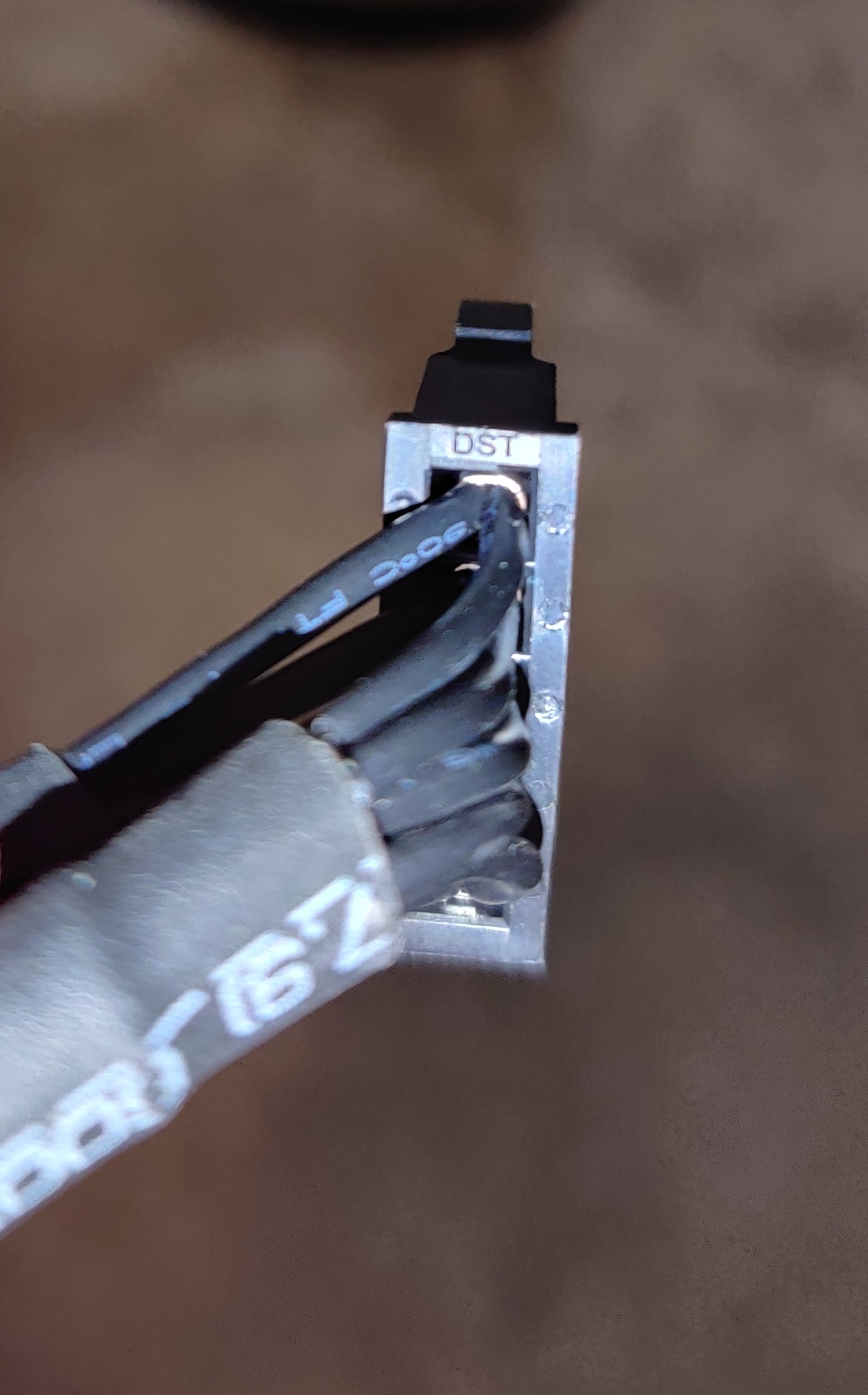

  9. Websleuthing for different kinds of PC parts is turning out not to be my forte. I think I found what is an example of the safe alternative where everything is crimped into round terminals and wires to each SATA are doubled up to daisy chain into the next. Ideally I'd like to either find a cable assy with more SATA connections or the parts needed to make my own. I've found round terminal crimps and PCIe 6 pin latched connectors, but I can't seem to find the SATA connectors that accept these round terminals. I'd like to use the PSU I have. Can you provide direction to either the cable assy to purchase or the SATA connectors that accept round terminals? Excuse my inability to think straight on some of this, I'm sick. I thought to look at the manufacturer and found 4x SATA. The cables that came with my PSU are 3x SATA. I think these, like the example I posted abive, are in-line with what you are talking about - see close-ups on my 3x SATA cables.
  10. After more reading and watching, I was thinking all my splits was not a smart way to do this. Thank you for your insight. So a few questions: What do you mean by slip fit connections? Is this video from WilluDesign the proper guide for making SATA connections? If so, I'll just look up ratings for 18awg wire and base max HDDs per cable off that + a safety margin. Split fit connections at the PSU....the PSU cables, which are from EVGA, have the locking tab to hold them in place. Is this not ok?
