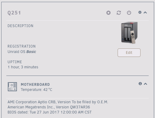

Several years ago, I use TS-851 with Unraid, but due to J1800 rather low end, so upgrade again ... again and retire for longtime.
Few weeks ago, I change my last QTS to Unraid, it is TS-251+ ( J1900 )

I have same problem and this not happen on TS-851 ( different BIOS version, but still  QW37AR3X ), I update TS-251 BIOS ** directly under Unraid ** from QW37AR32 to QW37AR36 then fixed this problem.
https://forum.qnap.net.pl/download/ts-x51-ts-x53.207/
You can download different version BIOS at below post
https://forum.qnap.com/viewtopic.php?t=133898&start=15#p707545

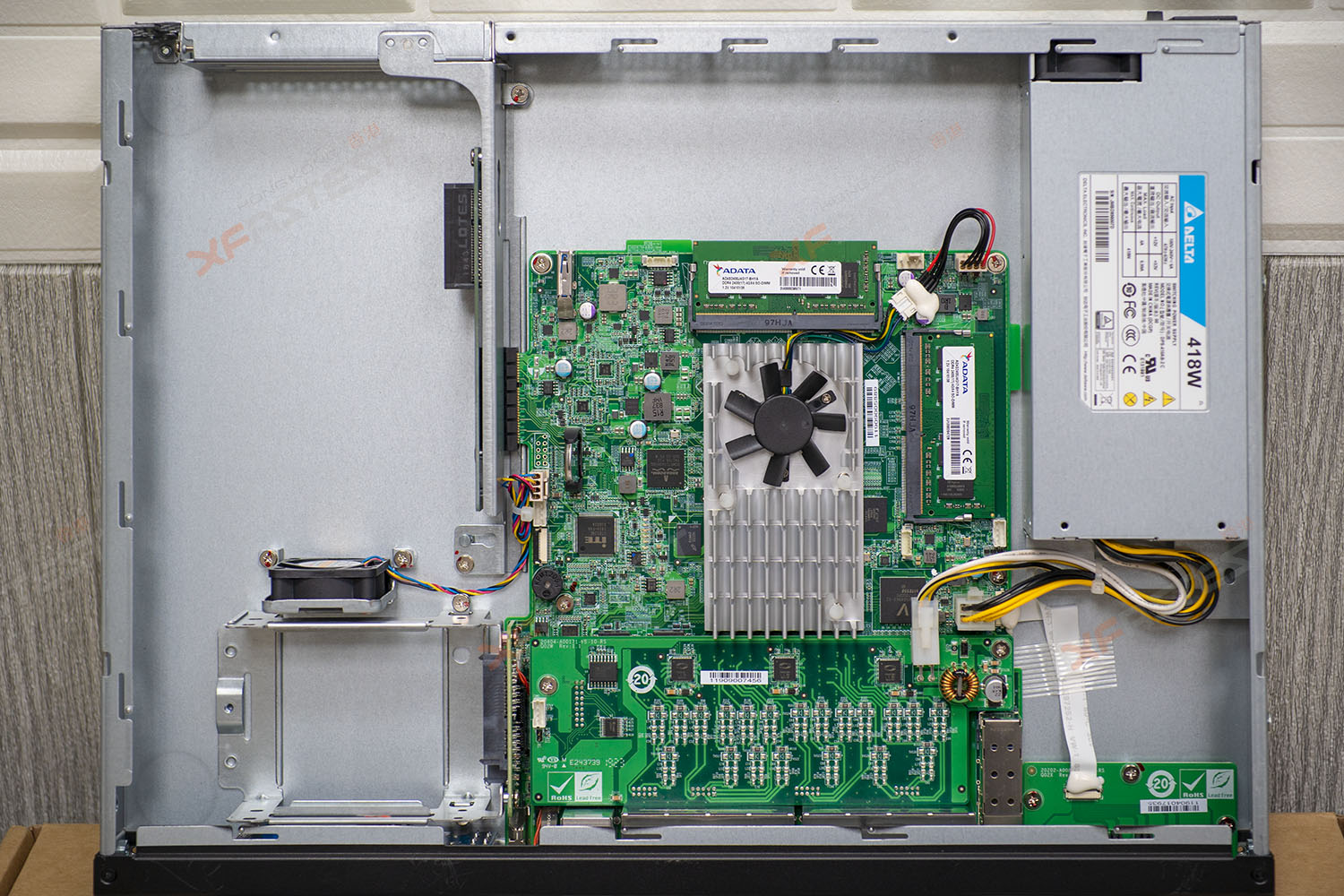

I recently bought a QGD-1600 Switch/NAS  (https://smile.amazon.com/QNAP-QGD-1600P-4G-US-16-Port-Celeron-Processor/dp/B07ZGJMXWR/ref=sr_1_1?crid=3NARAMQ515GPJ&dchild=1&keywords=qnap+qgd-1600p&qid=1614399897&sprefix=qnap+qgd%2Caps%2C171&sr=8-1) and was also able to boot up Unraid, I now have an Unraid NAS and a POE Switch in one box, the cool thing is that because the server has two separate cpus/logic the switch operates as original booting up QSS (QNAP switch sw) while coexisting with Unraid on the Host side.  Have not yet committed to Unraid but will start playing to see if I completely switch over.
That's great machine, have PoE++ (802.3bt、60W) and PCIe slot, drawback was support 2.5" disk only.
Yes, the limited disk support is a drawback.  I am looking for a SAS expansion option to add additional drives, suggestions are welcomed and appreciated.
LSI HBA are recommend, but those PCIe slot was Gen2x2 so 9200-8e already enough. It has a small fan at PCIe slot area so cooling shouldn't a issue.
Low power SATA controller addon card also a good choice.
Another through, in PCIe area install 3.5" disk ( one or two ) then use SATA cable extend to SATA socket, full-length PCI have 4.76". But you need provide the necessary power ( 2.5" should only have 5v and you need provide 12v ).
