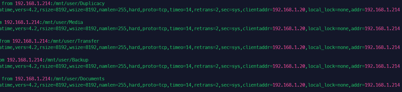

  5. Back to this for anyone having issues. The nolock didn't work, still had issues if I wanted to use the cache drive and the mover ran. I have ideas that maybe the mover tuner was causing issues but it was not the issue. I stopped having any issues related to stale file handles in ubuntu but Plex (running in docker) was having issues where it would happen inside the container. The fix? Mount the nfs shares using docker volumes. I'm sure there is probably something else that could fix it, NFS is probably mounted by docker using some specific parameters to alleviate the problems I encountered and docker volumes are probably better, bind was just simpler (or so I thought) at the time.
  6. For anyone running into this, plex specifically seems to cause this issue. Adding 'nolock' into your fstab on the client side fixes this... so far.
  7. if anyone has any idea of what I can change, would appreciate it! Not using a cache drive and it's... meh to say the least. Thanks~!

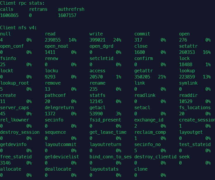

  8. I blew away my config for unraid and then redid everything. When the mover runs it causes the same issue. Everything using nfs 4 as far as I know. It does seem strange that it's just the top level of the directory has a stale file handle. Also to confirm with screenshots nfs4
  9. It shows me using nfs v4 in my client, but I'm not sure how to check in Unraid. I assume it has to be reciprocated so it's the same on the other side. One thing to note is that my shares look like this And I can cd into the Media folder and then into the folders under it if I know the name. But can't auto-complete or anything. Ya, it shows "Client nfs v4" just as my nfsstat -m shows it on each of my separate mounts as 4.2

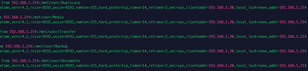

  10. Bump, maybe someone has some insights or something I can run to fix it! edit: (without removing the mover), if I don't have cache while moving these large files it affects the entire system and if the transfer take too long, can't play any media with my media server. So if possible a solution without that would be awesome... I'm using the mover plugin, not sure if plugin.old is causing this? it's showing up in my logs.
  11. These are the flags for all my mounts on my client system (ubuntu server) using nfsstat -m Flags: rw,relatime,vers=4.2 It's actually really weird I know about it because in my plex container I get the error: Please check that the file exists and the necessary drive is mounted And within the plex files it shows as: Dec 06, 2022 04:46:25.428 [0x7fba5a989b38] ERROR - [Req#47f3/Transcode/Req#4806] Couldn't check for the existence of file "/data/media/music/2CELLOS/Dedicated (2021)/2CELLOS - Dedicated - 07 - I Don't Care.mp3": boost::filesystem::status: Stale file handle: "/data/media/music/2CELLOS/Dedicated (2021)/2CELLOS - Dedicated - 07 - I Don't Care.mp3" I have these mounted on all my other containers just fine... so maybe something to do with. Also just now after I've written the above I had a stale file handle error, the docker containers were able to access the media just fine. But in a ssh session with my server it would consistently show stale file handle when I ls in the Media mount. And it would show ?? ?? ? for all the permissions instead of drwxrwxrwx, 99 users. I just did a reboot and it seemed to fix it but still annoying. Don't see anything in the logs for unraid but I'll upload the latest. tianding-diagnostics-20221208-1151.zip Edit: The weirdest thing is that on my client system, I can access the media files just fine through my docker apps now. Plex even works fine, but through the commandline using 'ls -la' it shows as stale file handles and I can't view it at all. I only run a single docker container on this and have minimal configuration so I'm ok with just resetting it all and start fresh with 6.11.5. But if there's a setting I can change that would fix it, it would definitely save some time.
