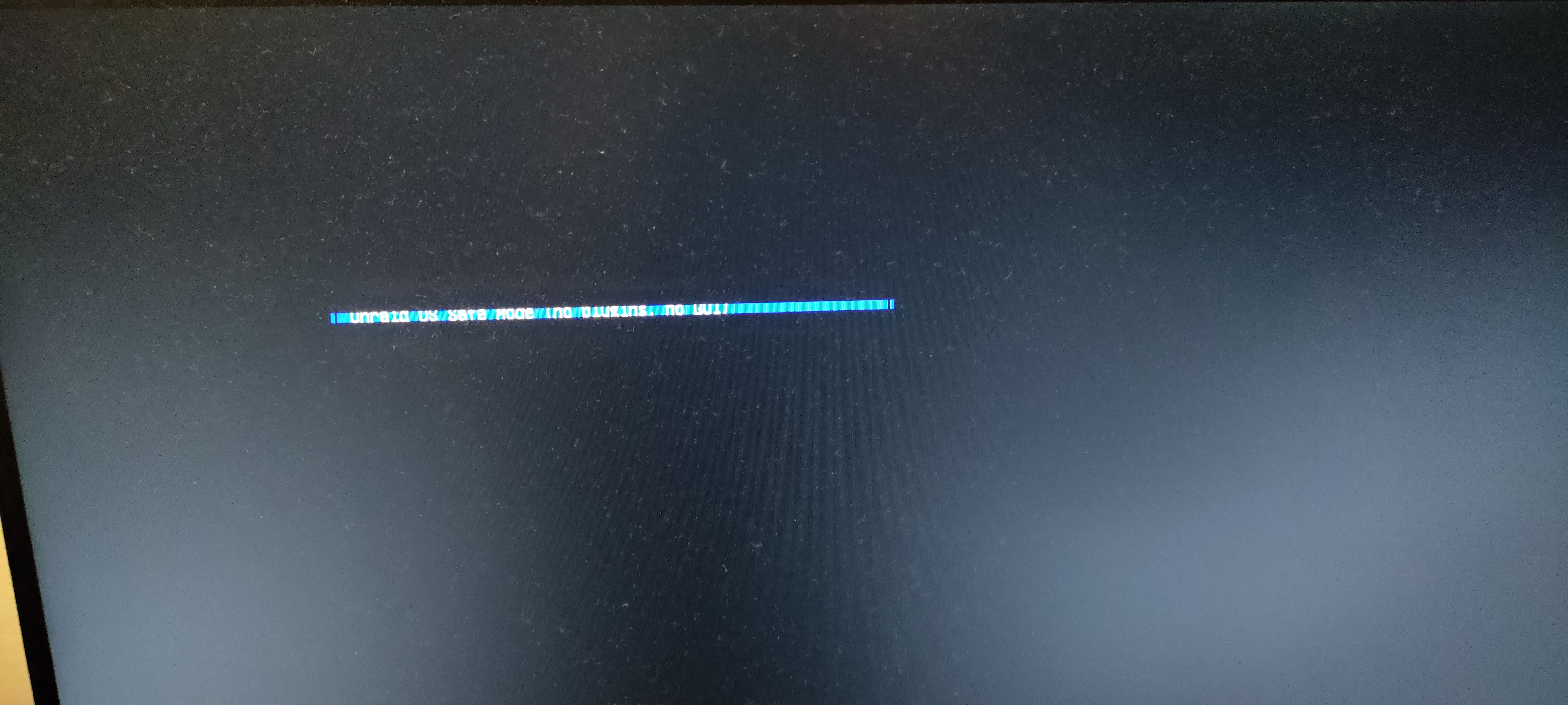

  7. Thanks for the clarification. I've connected a keyboard and monitor, but all I have on the display is in the attached photo. Text is: "Unraid OS Safe Mode (no plugins, no GUI)." There's no Linux command line and the screen doesn't respond to any input. I've seen this screen before and I figured it was normal after booting into Unraid without a GUI. I also have a couple Docker containers using my GPU, so that could also explain it.
