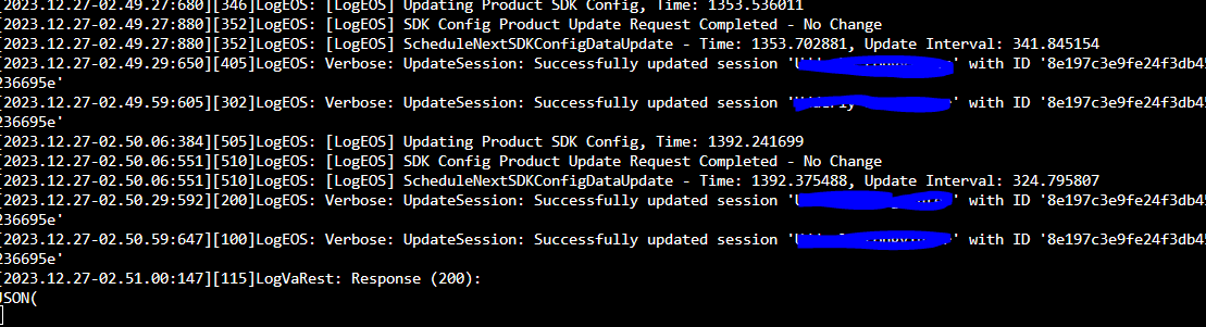

  7. I'm unable to connect to a Longvinter server. I believe I have forwarded the right ports. I even tried stopping all other containers to prevent conflicts. The server shows up in the browser. I get this message after a while when trying to connect. The log window seems to show the server running so I'm not sure what I'm missing. I'm able to connect to random other servers, both official and unofficial. Let me know if there is anything else you need to help troubleshoot.
