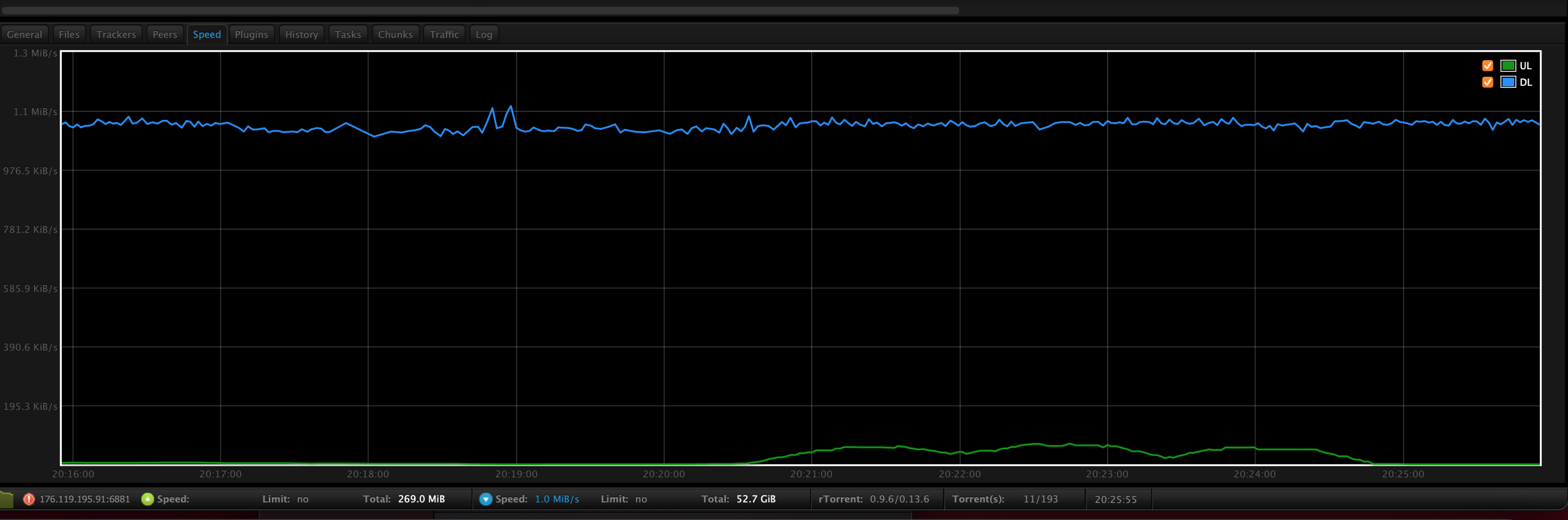

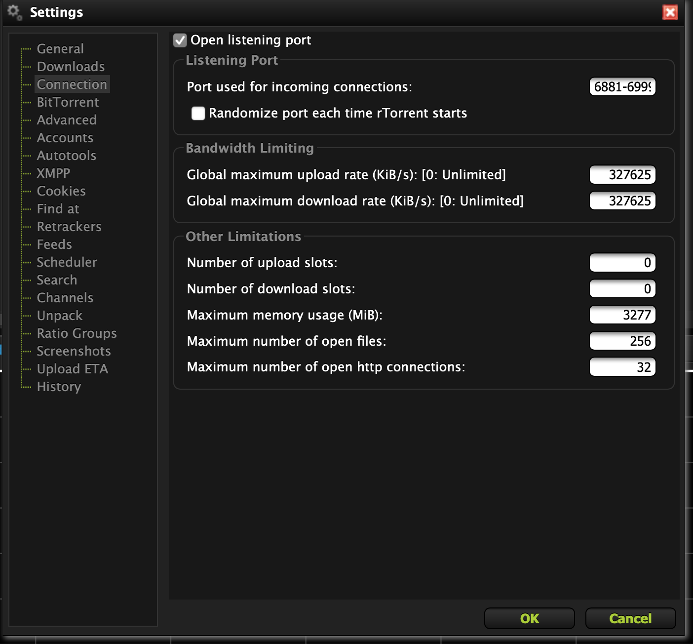

  1. Hello, I have encountered a very perceuliar issue which has been difficult to diagnose and has repeated itself twice (I reinstalled Unraid after a server rebuild). In short, I use a NordVPN account and this docker but encounter what seems to be an invisible 1MB/s (almost exactly 8-9 mbps), I have 100% double checked I have no limit set within rtorrent, and if I remove the openvpn config it goes back to normal using all my net connection. However if I connect to exactly the same VPN Openvpn profile manually on my MacBook, I can obtain full speeds as expected (40-50mbps. Can anyone point me in the direction of how I can rectify this please? Let me know if there is anything further I can provide to help investigate it. Please be gentle as I am an Unraid novice

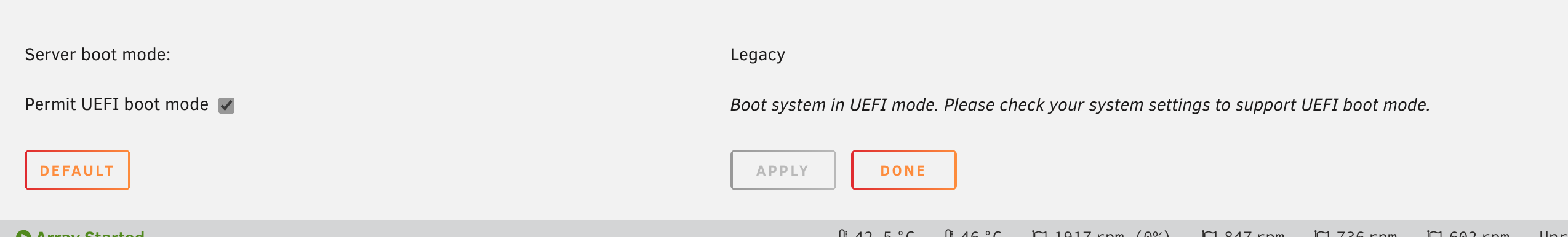

  3. Heya bud, Unticked the box, rebooted, no settings changes required in the bios it booted fine, however GPU is still not showing
  4. Untick that, then reboot?

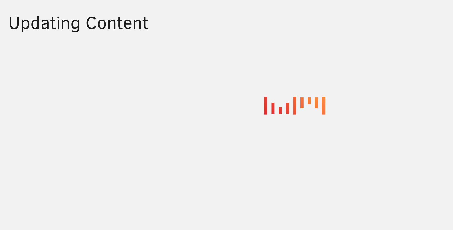

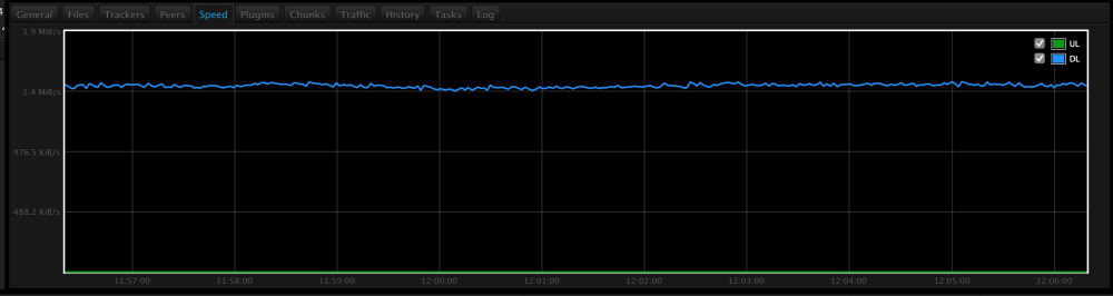

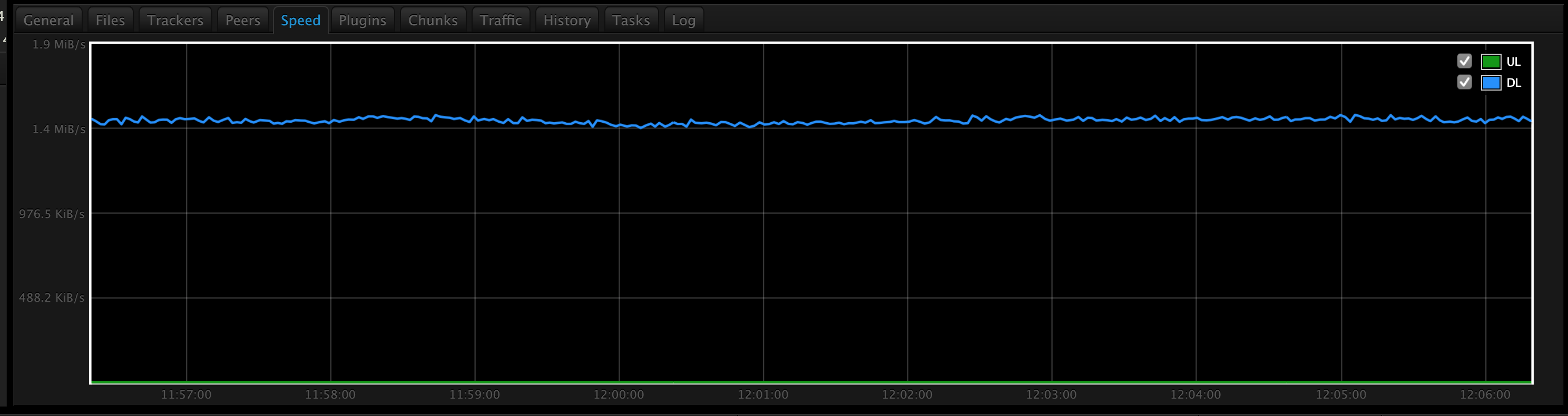

  11. Just heading out shopping for xmas, ill do it once im back in a couple hours bud, appreciate the quick response though
