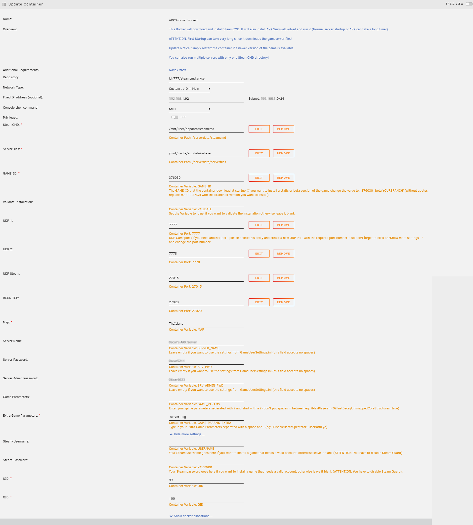

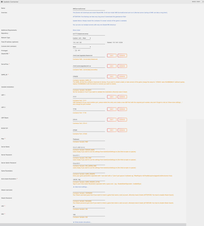

  2. okay so if its opening all ports to that IP on br0, why can't I find it on my local network or get it to connect to the server in the server browser? I have nothing else fighting to use those ports, and my LAN firewall should let local things talk to eachother, so why doesn't it?

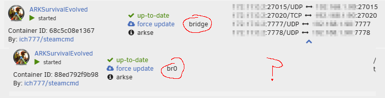

  3. okay, the main reason I don't want to use the bridge is because I want each of my servers to use a different local IP address so I can manage port forwarding from my router better. I don't want to expose my actual UnRaid server's IP address to the internet at large by various ports, id rather just expose the virtualized docker and the one or two ports it needs to minimize damage should something happen so I'll just say it, my UnRaid's IP ends in .90 and sequentially from there every docker I have on it is increased by 1 for example my MC server is .91 and I want the ARK server to be .92 the only way I was able to do this other than adding additional physical network adapters was to use br0 (at least that's what my friend who helped me initially set it up said) I want to just be able to go to my router and make a rule saying go from public IP port 27015 and go to internal IP ending in .92 and call it a day. I don't want to expose my actual unraid's IP because that feels like more a vulnerability right? and sorry, I didn't quite understand what you meant by not exposing the ports in the docker until now. I tried messing around with it on the binhex server and got the result you said I would. sorry I didn't get it right away, I'm still at the stage of re-learning how docker works every time I add a new docker. I've attached a image of my docker template, its pretty much default other than deleting and re-adding ports like I've seen people mention on here (I think I did, I've deleted the docker and reinstalled it several times so I can't tell if I've done it on this one yet) I tried adding the IP and port in the steam server browser and I get absolutely nothing in this current config.
  4. really? because it works just fine for br0 on my minecraft server/it shows me the app to host port mappings just fine. in any case, I can't even get it to show up on LAN. steam just says no LAN servers and I can't tell what I'm doing wrong. is there an official setup guide somewhere I can reference? I'm flying by the seat of my pants and appear to be failing miserably
  5. why does the server refuse to connect if I use a custom network adapter? I want to use my custom br0 to give my ARK server a custom local IP but every time I do that, it refuses to map the ports to the IP. its worked for the other dockers I've been running but for some reason it refuses on this one. I'm not sure what I'm doing wrong
