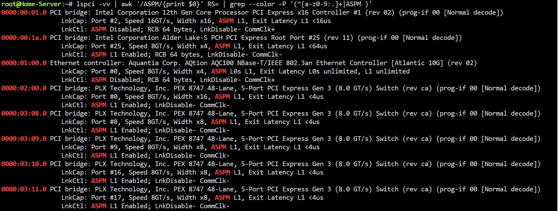

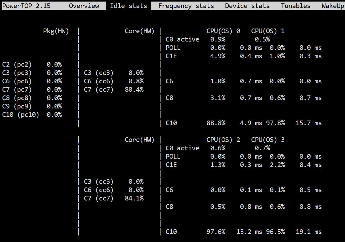

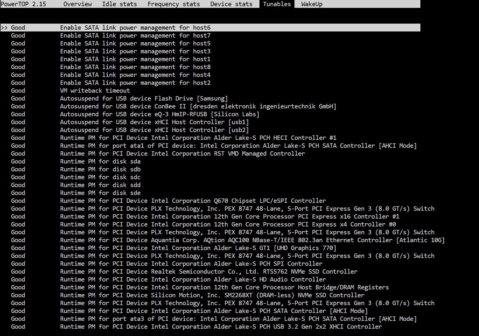

  1. Hi everyone, I updated my server and paid attention to energy-saving aspects when selecting the hardware. I got myself an HP Elitedesk 800 G6. I replaced the CPU with an i9-12900 and added 16GB of RAM. Initial tests with an SSD showed very good values of approx. 5-6 watts. Of course, an SSD doesn't do much on its own. So I expanded my setup to: - 4x Sata HDD 2x 18TB1, 1x20TB Toshiba and 22TB Seagate Parity - Plex 8747 4-slot SSD card (equipped with 4 SSDs) - 10GB ASUS XG-C100F network card - 3 fans for CPU, HDD, and SSD Unfortunately, I can't achieve any C-states at all now. Consumption is now 55W. I find that to be a lot when all HDDs are idle. Through the thread, I found out that the chipset of the 10GB NT card outputs ASPM Disabled. I then removed the card, but that didn't make much difference. Still C-State 0. I read here that Intel cards enable better C-states, but that wouldn't help because I can't achieve better states even without a card. Can someone please help me? I'm desperate.
