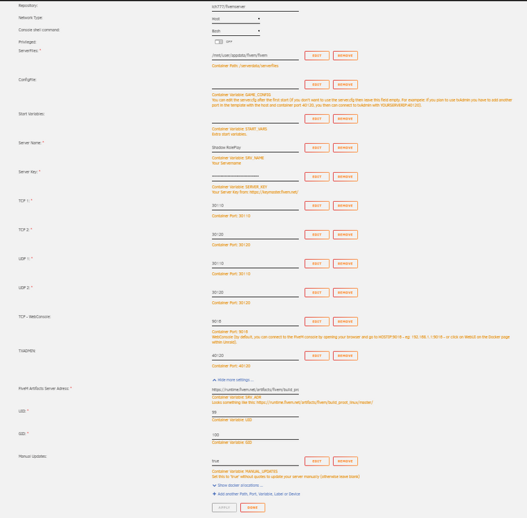

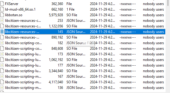

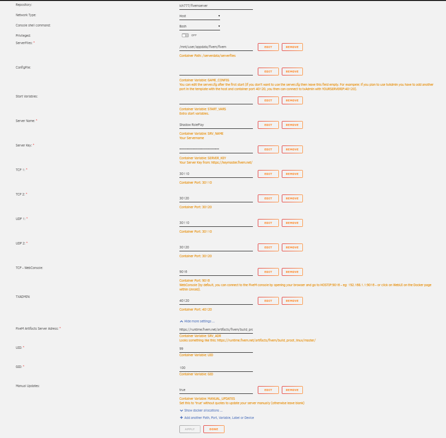

  1. I am on Unraid 6.12.13, and heres a screenshot of my setup options. all the files when they work have the permissions of -rwxrwx--- not sure what that means, im also not sure how to fix thise permissions. I have a CrushFTP path going to that folder, so ive tried getting rid of it thinking it had taken over the privileges. But also didn't work. If you could show me where to go or how to change my permissions that would be muich appreciated 😁 (also i chnaged the paths being fivem/fivem is because thought it could be the folder but wasnt and just never changed it back, thats for sure the path to it aswell) I also get the 3rd picture just before it crashes when it cant access the files and lastly i get these from my main ftp server when those files look like they get delted. Same files from the 2nd photo

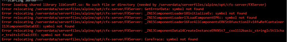

  2. When my FiveM server completely starts i get the a bunch of errors in the log (photo included). I wasn't able to debug much from the .dmp file, but what I was able to figure out is that some very important files within the alpine/opt/cfx-server/ were getting deleted when I checked the file folder. I've reset the server multiple times, clean wipe etc. and am unsure what to do. It could be problems with the file permissions but I am unsure. I posted on the CFX Forums and requested support from cfx.re help. the only other post ive found like this wasnt much help but could help: https://forum.cfx.re/t/i-cant-run-fivem-server-on-my-linux-vps/2582560 he said it was a permission problem, but thats all the information he gave. thank you for your help in advance! Photo: and heres the .dmp file: 2149a52a-2c48-44f5-a9d4c0a6-69975f65.dmp

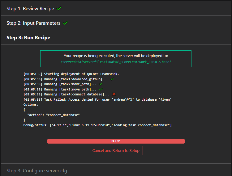

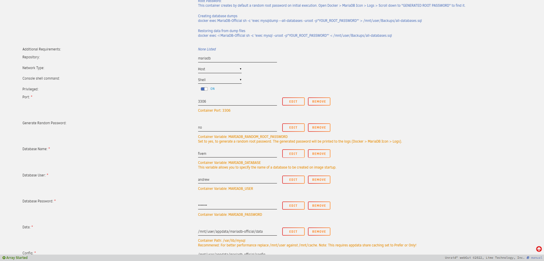

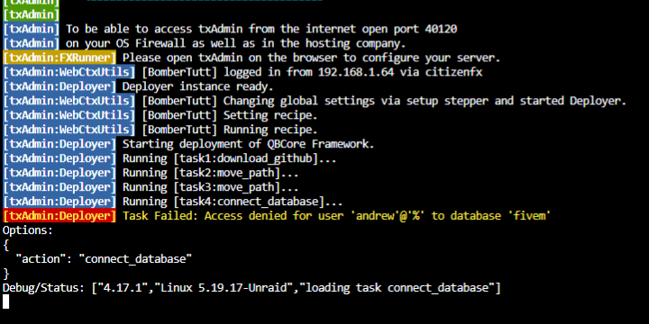

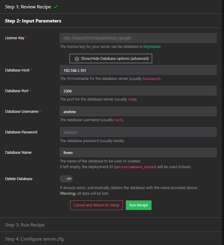

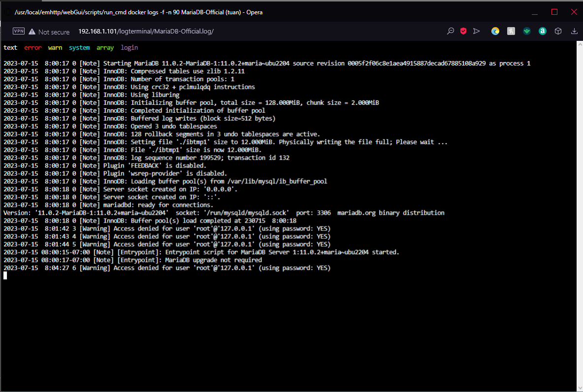

  4. Hello. I am trying to setup my FiveM docker container by ich777 using txadmin. What i keep running into is when it try to input my parameters for my MariaDB server i get the error "Access denied for user 'root'@'127.0.0.1' (using password: YES)" when i try to login using the database user instead of root, it attempts to download the ESX files but then has an error (see attached image). I'm wondering if anyone can help. I'm feeling that it either has to do with how the two docker talk to each other, or I have to someone give the "andrew" user access. Ill also attach my logs for MariaDB, as well as FiveM. To answer your question you asked me yesterday MariaDB is needed because the FiveM server needs an SQL server when using txadmin. I don't fully understand why. Both Ip's are 192.168.1.101:3306
  5. Hello. I am trying to setup my FiveM docker container by ich777 using txadmin. What i keep running into is when it try to input my parameters for my MariaDB server i get the error "Access denied for user 'root'@'127.0.0.1' (using password: YES)" when i try to login using the database user instead of root, it attempts to download the ESX files but then has an error (see attached image). I'm wondering if anyone can help. I'm feeling that it either has to do with how the two docker talk to each other, or I have to someone give the "andrew" user access. Ill also attach my logs for MariaDB, as well as FiveM.
  6. I found how to do it. In the initial setup delete the server.cfg perameter, and add a new port that is 40120. What i catn seem to get working is a MySQL/Mariadb server for the database. I have tried at least a dozen different containers for sql none of them work for the server. If anyone can help, that would be amazing!
  7. Hello all. I know that ich777 already has a FiveM server container. I used that for awhile, but I am trying to add ESX to my server, ich777's repo doesn't use txadmin which i need in order to add ESX to my server. I found a docker container to add but can't figure out how to configure it within unraid. Here's the link: https://hub.docker.com/r/spritsail/fivem If anyone can help me get this configured and added, that would be great. I know how to add the docker. But i don't know how to add the configuration script.

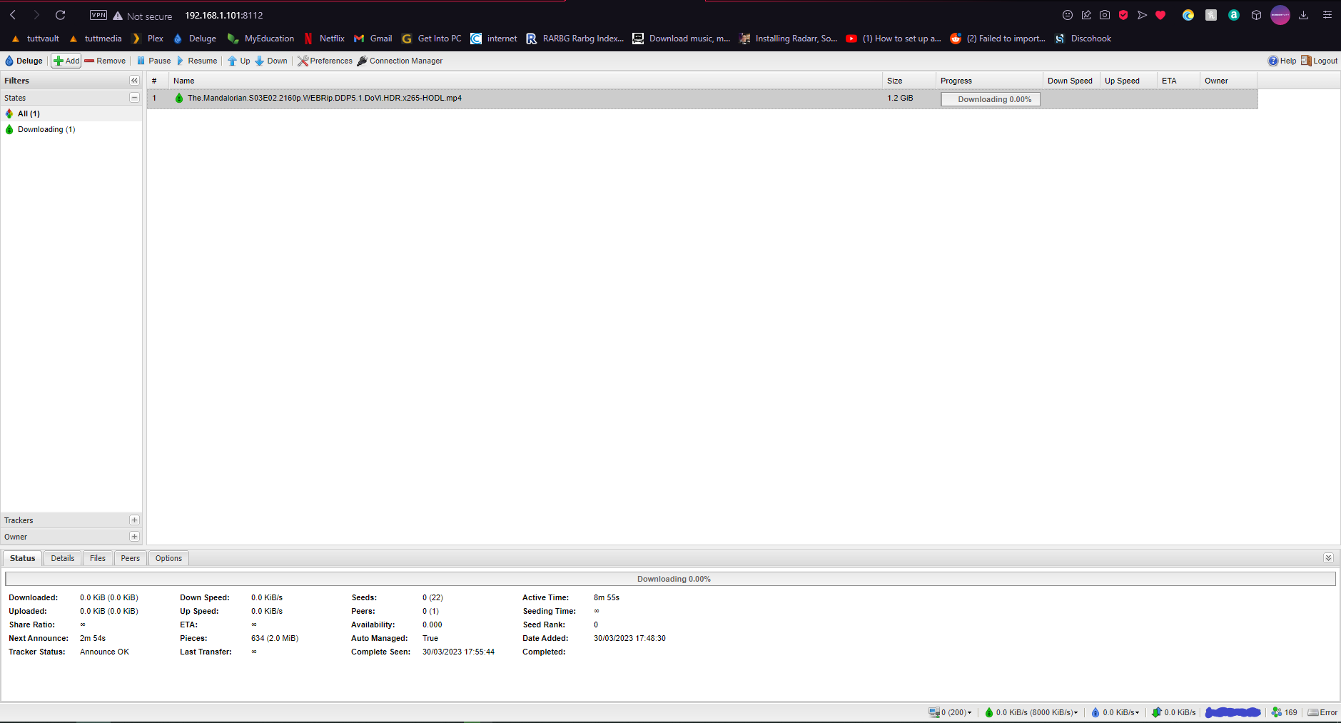

  8. Hey!! I've had it working before. Deluge all set up with Sonarr and Radarr, but recently I've been downloading a file and there are seeds. But its not downloading. So i try the same file on my Main PC and it works fine with FDM. the area where seeds are it says " Seeds: 0 (220)". Anyone got a fix??? I added the Deluge log aswell as a screenshot of deluge! delugelog.txt
