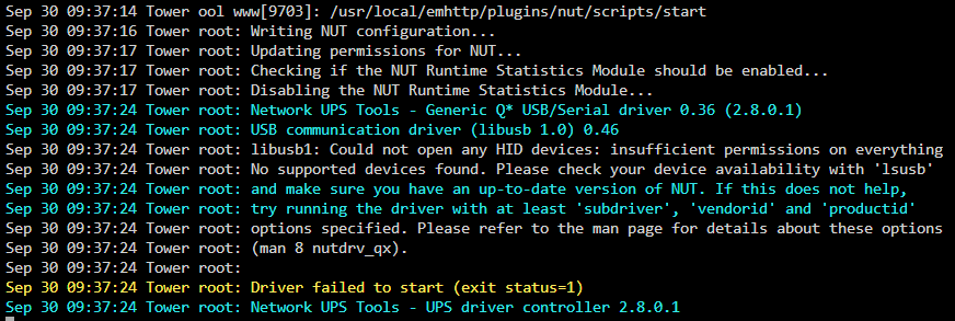

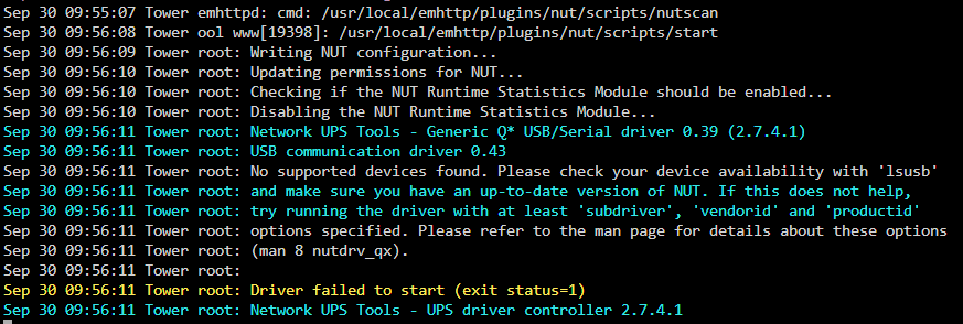

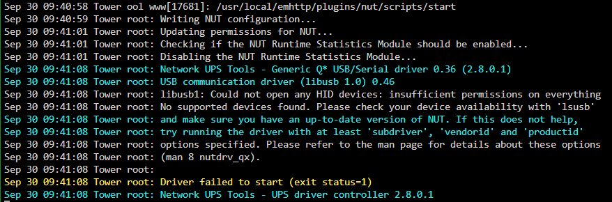

  5. Same issue Why is the driver failing to start?

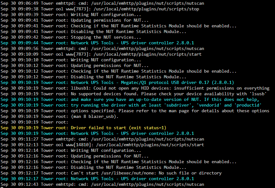

  6. In the Plugin the nutdriv_qx is not an option. Using the Custom option and defining 'nutdrv_qx' results in failed to start driver. I noticed this is the same error i had even with blazer usb option
  7. I have a Mecer ME-1000-VU UPS with a USB Data Port. The UPS uses UPSILON 2000 Driver. I had previously setup the UPS using the Link on the Home Page of this thread. It worked just fine. However, when the Server restarted due to a power outage the Plugin was removed due to compatibility issues. FYI at the time i was on Unraid 6.12.3. Am now on Unraid 6.12.4 and have now installed the rysz Network UPS Tools (NUT) for UNRAID plugin through Docker. Have tried all the options but not sure what am missing as the UPS is not detected.
