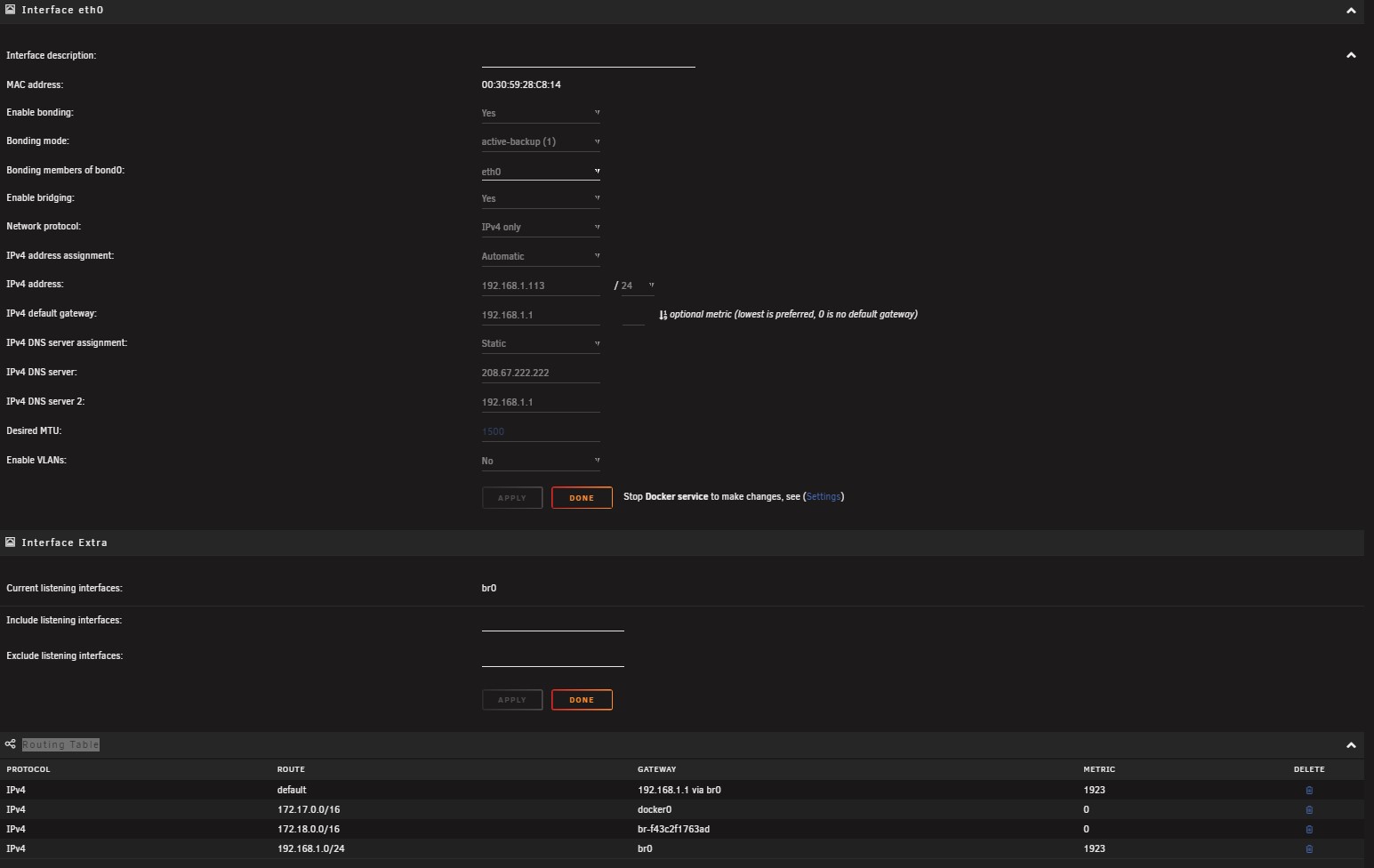

  1. Thank you for your feedback ich777. I only use iPv4, both internally and externally. I have attached a screenshot of my unraid network configuration. I've already tried all of the network types.
  2. Hello folks, I've been using "Unraid" for a few months and also have some Docker running and I'm happy with it. Now I wanted to set up different game servers (e.g. Valheim, Palworld) and I have the problem that the servers don't start because there is supposedly no network connection. Below is the log from the Palworld server. In the Palworld log you can see that a download is taking place and my public IP is also recognized. To check whether the docker has a connection to the internet, I installed ping and can resolve names and ips. The docker works in a VLAN, my Windows PC can start a dedicated server in the same VLAN without any problems. Am I missing something? Maybe someone else here has an idea? Greetings Ulf ln: failed to create symbolic link '/serverdata/serverfiles/Engine/Binaries/Linux/steamclient.so': No such file or directory cp: cannot stat '/serverdata/serverfiles/linux64/*': No such file or directory Session terminated, killing shell...kill: usage: kill [-s sigspec | -n signum | -sigspec] pid | jobspec ... or kill -l [sigspec] ln: failed to create symbolic link '/serverdata/serverfiles/Engine/Binaries/Linux/steamclient.so': No such file or directory [ 96%] Downloading update (58,516 of 59,782 KB)... [ 97%] Downloading update (59,260 of 59,782 KB)... [ 99%] Downloading update (59,782 of 59,782 KB)... [100%] Download Complete. [----] Applying update... [----] Extracting package... [----] Extracting package... [----] Extracting package... [----] Extracting package... [----] Installing update... [----] Installing update... [----] Installing update... [----] Installing update... [----] Installing update... [----] Installing update... [----] Installing update... [----] Installing update... [----] Cleaning up... [----] Update complete, launching... tid(49) burning pthread_key_t == 0 so we never use it Redirecting stderr to '/serverdata/Steam/logs/stderr.txt' Logging directory: '/serverdata/Steam/logs' /tmp/dumps insufficient permissions - delete and recreate [ 0%] Checking for available updates... [----] Verifying installation... [ 0%] Downloading update... [ 0%] Checking for available updates... [----] !!! Fatal Error: Steamcmd needs to be online to update. Please confirm your network connection and try again. src/tier0/threadtools.cpp (3706) : Assertion Failed: Illegal termination of worker thread 'Thread(0x0x56c51ad0/0x0x2a5ffb' ---Update Server--- tid(61) burning pthread_key_t == 0 so we never use it Redirecting stderr to '/serverdata/Steam/logs/stderr.txt' Logging directory: '/serverdata/Steam/logs' [ 0%] Checking for available updates... [----] Verifying installation... [ 0%] Downloading update... [ 0%] Checking for available updates... [----] !!! Fatal Error: Steamcmd needs to be online to update. Please confirm your network connection and try again. src/tier0/threadtools.cpp (3706) : Assertion Failed: Illegal termination of worker thread 'Thread(0x0x56c02ad0/0x0x2a55cb' ---Checking if configuration is in place--- ---Configuration not found, downloading...--- ---Checking if PublicIP is in place--- ---No PublicIP found in PalWorldSettings.ini, trying to obtain it...--- ---Sucessfully obtained PublicIP: x.x.x.x, adding to PalWorldSettings.ini ---Prepare Server--- ---Server ready--- ---Start Server--- ---Something went wrong, can't find the executable, putting container into sleep mode!--- ---Ensuring UID: 99 matches user--- usermod: no changes ---Ensuring GID: 100 matches user--- usermod: no changes ---Setting umask to 000--- ---Checking for optional scripts--- ---No optional script found, continuing--- ---Taking ownership of data...--- ---Starting...--- ---Update SteamCMD--- tid(21) burning pthread_key_t == 0 so we never use it Redirecting stderr to '/serverdata/Steam/logs/stderr.txt' Logging directory: '/serverdata/Steam/logs' [ 0%] Checking for available updates... [----] Verifying installation... [ 0%] Downloading update... [ 0%] Checking for available updates... [----] !!! Fatal Error: Steamcmd needs to be online to update. Please confirm your network connection and try again. src/tier0/threadtools.cpp (3706) : Assertion Failed: Illegal termination of worker thread 'Thread(0x0x56c95ad0/0x0x2a5ffb' ---Update Server--- tid(33) burning pthread_key_t == 0 so we never use it Redirecting stderr to '/serverdata/Steam/logs/stderr.txt' Logging directory: '/serverdata/Steam/logs' [ 0%] Checking for available updates... [----] Verifying installation... [ 0%] Downloading update... [ 0%] Checking for available updates... [----] !!! Fatal Error: Steamcmd needs to be online to update. Please confirm your network connection and try again. src/tier0/threadtools.cpp (3706) : Assertion Failed: Illegal termination of worker thread 'Thread(0x0x56c92ad0/0x0x2a5ffb' ---Checking if configuration is in place--- ---Configuration found, continuing...--- ---Checking if PublicIP is in place--- ---PublicIP in PalWorldSettings.ini found: x.x.x.x ---Prepare Server--- ---Server ready--- ---Start Server--- ---Something went wrong, can't find the executable, putting container into sleep mode!---
