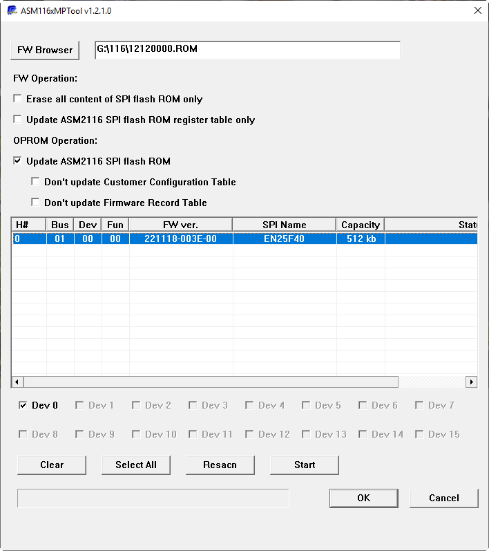

  1. Hallo zusammen, aufgrund der Empfehlungen hier im Forum habe ich mir folgende Karte bei Amazon gekauft: MZHOU PCIe SATA X4 Karte 6 Port Erweiterungskarte, ASM1166 6-Port-Chip,Unterstützt 6 SATA 3.0 Wenn ich die Bezeichnung richtig deute, ist dort eine neuere FW bereits vorinstalliert: 221118-003E-00 . Das Programm bietet glaube ich keine Möglichkeit diese zuerst herunterzuladen, sodass ich unsicher bin, ob ich die hier im Thread empfohlene 211108 flashen soll. Habt ihr eine Empfehlung?

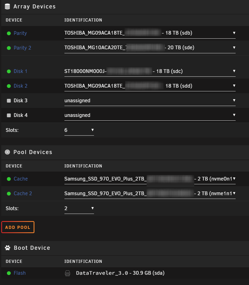

  2. Dear Jorge, thank you very much for your fast answer - I chose the first way and parity-sync now started on the 20tb drive. Once it is completed, I will assign the old parity drive as third data disk. Thanks for your support! Best regards Jens
  3. Dear all, unfortunately I didn't read the manual exactly ( https://docs.unraid.net/unraid-os/manual/storage-management#upgrading-parity-disks ) and so my parity upgrade went wrong. What I did so far: Old config was parity (18TB sdb) with 2x 18 TB data disks (sdc, sdd). Then I added the sde with 20 TB as parity 2 and let it build. I think that was my mistake as I should have assign it to parity 1 and removing the old sbd drive in one step. My goal would be to have the 20 TB as parity (1) and the old parity drive (sdb) as a new data drive. I already have populated the data disks, so I dont want to mess up the next step I read that I have to use "new config" to get to the goal, but is there an more easy way? (e.g. disabling both parity drives and then assign sde to parity 1 which will rebuild then? The possible data loss while generating the parity is ok for me). Sorry if this was already asked, I just don't want to make a mistake again. Thanks in advance!
