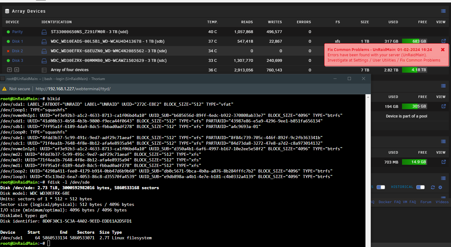

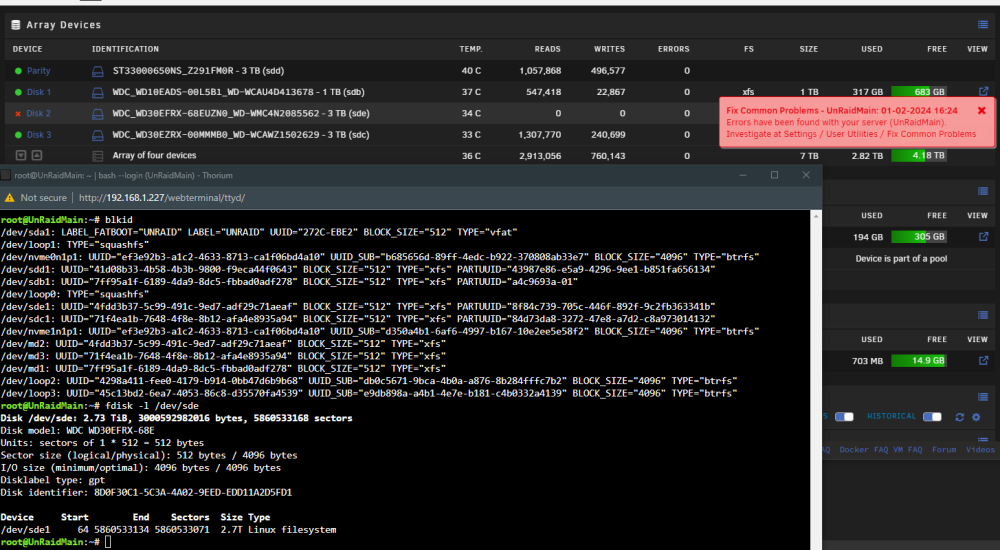

  12. As the drive is disabled how do i get it back in the array?
