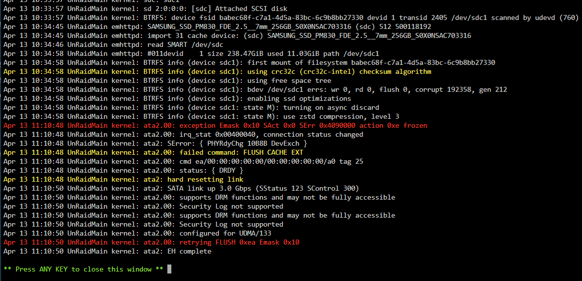

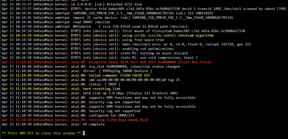

  10. SATA cable fix it but on reboot I would do a SCRUB and it would find errors. Fixed them and rebooted and again needed a SCRUB and fixed errors again. Anyway... Ended swaping another old 250Gb SSD I had laying around and it rebuilt and that is running fine. On reboot SCRUB is clean. So mirrored set is back to normal. (And thats why we have mirrored drives ) Will watch out for lockup issues. Server has been running rock solid in the past not counting the power outages.
  11. Hi all. Server was off line and locked up when I got up this morning. As I live in Ukraine with power that is up and down I just restarted the machine and updated to the latest version of Unraid as I had been planning on that anyway. So about 3 hours later it was locked up again. I checked and it looks like I have problems with a Pool device drive so thinking that needs to get replaced. (its a really really really old SSD but does pass the smart test) Do not really see how that could cause a lock up as its not part of any system files but just a mirrored pool I use to store files on. Anyway, does anyone see anything in my diags that look like a problem? '--- Drive that looks like it is dieing. unraidmain-diagnostics-20240413-1135.zip
