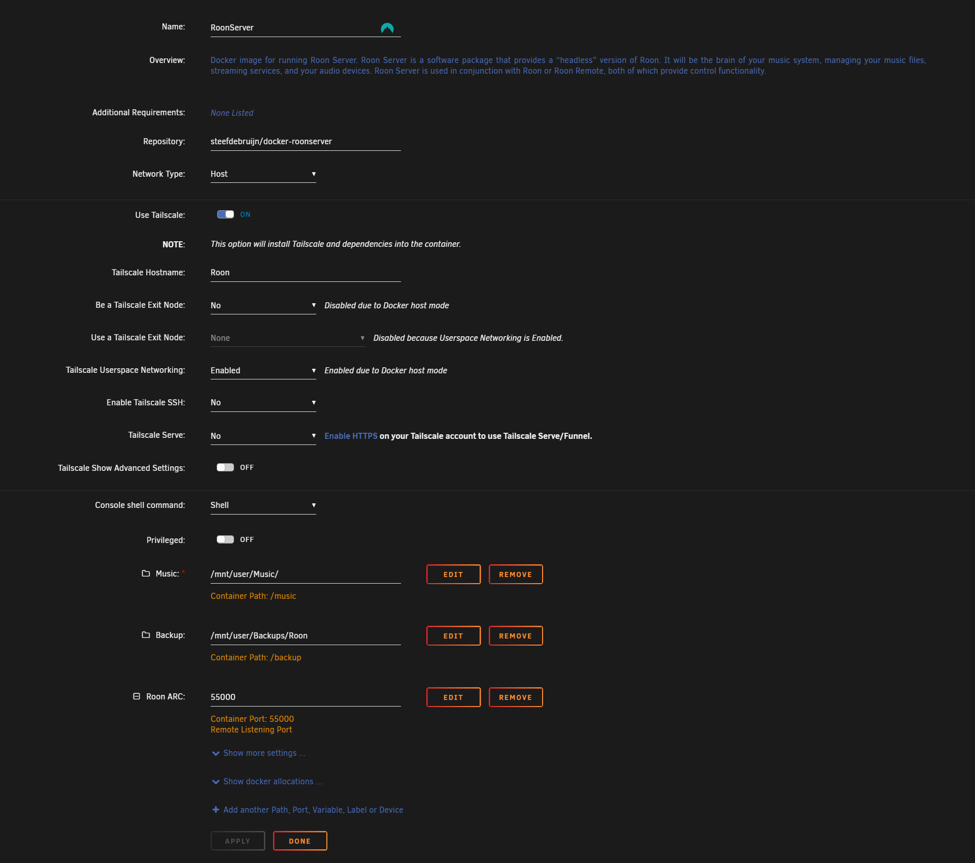

  22. Sorry its taken me a while to come back round to this. Having done some digging, im not sure it will work with tailscale. found a post that said the following "I don’t think that would work either. Roon device discovery uses IP multicast, which does not traverse the Tailscale VPN (there’s extensive discussion of this on other Tailscale threads). Roon ARC connects to the Roon server via a specified IP address, and traffic then flows over Tailscale. But the standard Roon app, designed for the local network, relies on Roon’s multicast discovery, and so it can’t find the Roon server when it is away from the local network where the server resides."
  23. Sure will grab some screenshots from the docker container
  24. Hi there, im trying to get Roon to work over tailscale from inside of a Docker Container, but it doesn't work, outside my network, although it joins my tailscale account just fine. Has anybody done this, and can tell me how this might work. I have it working over zeriotier, but would prefer to move everything to tailscale
