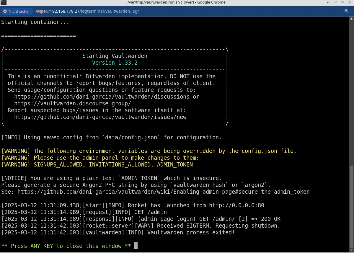

  6. Unfortunately, my Vaultwarden install stopped loading the GUI. I can get into the admin page with no problem. The log shows nothing abnormal in my understanding. Being quite the newb with Vaultwarden and only halfway educated with Unraid, I don't know how to move on. If you need anything more, just let me know.
