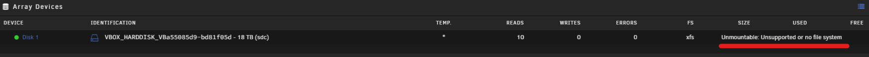

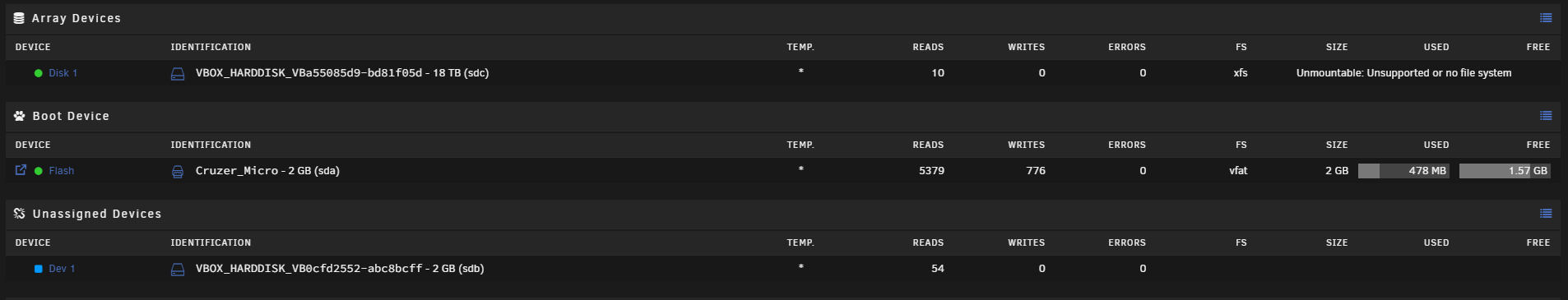

  1. Figured it out. I had to enable Use Host I/O Cache under controller: SATA in Virtualbox HBA card i bought https://www.ebay.com/itm/125443426997 2x 18TB Seagate However but i am unable to format the HDD which I passed thru from the HBA controller. Every time I try to format it it says. I can format the other hard drive. Its brand new and I tested it. Its health and has no errors.
  2. Hi, I am using the following card and it is in IT Mode. Bought it from ebay https://www.ebay.com/itm/125443426997 Inspur LSI SAS3008-i 8-Port 12Gb PCIe 3.0 SATA/SAS HBA IT Mode I am able to format HDD if they are connected to the motherboard SATA ports. I am using Unraid in VirtualBox. I am able to passthrough the drives to the Unraid VM in VirtualBox but I cannot format the drives connected to the HBA card. I can see the drives but the format fails and it says unsupported format and unmountable. I am passing it thru as SATA drive in Virtualbox under Controller: SATA and I can format the drives. I tried to set it up through but then I am unable to see the drives in Unraid. Not sure what I am doing wrong. Do I need to update the firmware. Not sure what version it is right now and where to find the latest FW version either.
  3. Hi, Formating error: 18 TB HDD on SAS3 3008 Card in Virtual Box I have passed through a 18 TB Seagate drive in Virtual Box. When I try to format it I am getting unsupported format. The SAS3 3008 card is in IT mode. I am using only one drive for now for testing. Since it is a single drive could this be the reason why it is not working?
  4. Thanks. I tried to find the recommended size for UnraidVM.vhd. I have it set to 2 GB as I created the iso from the usb stick. Maybe it is to small.

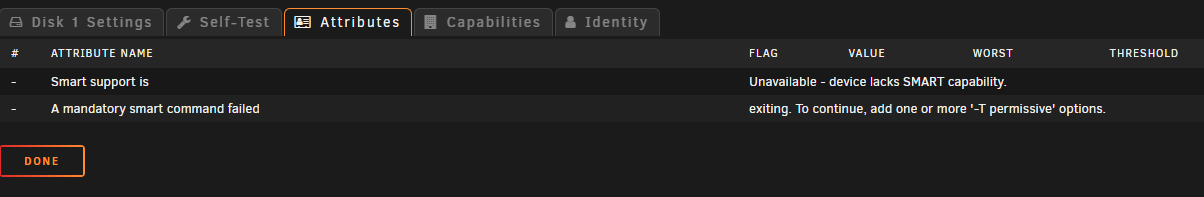

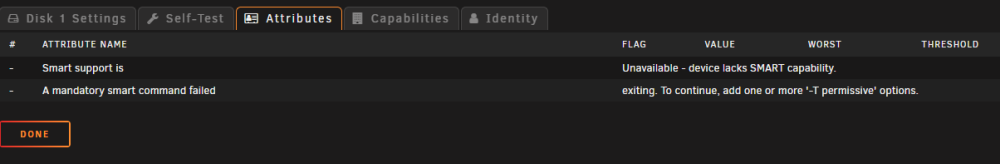

  6. What about SMART ? Is there a way to make it work?
  7. Thank you I set it up in VirtualBox. Is there a way to enable the S.M.A.R.T feature on the drives in UNRAID or will that not work?
  8. Thank you for the suggestions. I have setup Unraid in VirtualBox on a Windows 11 Pro Ryzen 7 machine. Also when I try to format any drive the VM goes into pause in Virtualbox. What am I doing wrong? Is there a way to enable the S.M.A.R.T feature on the drives in UNRAID or will that not work? Thanks.
