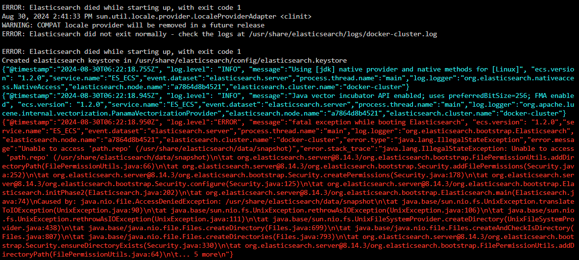

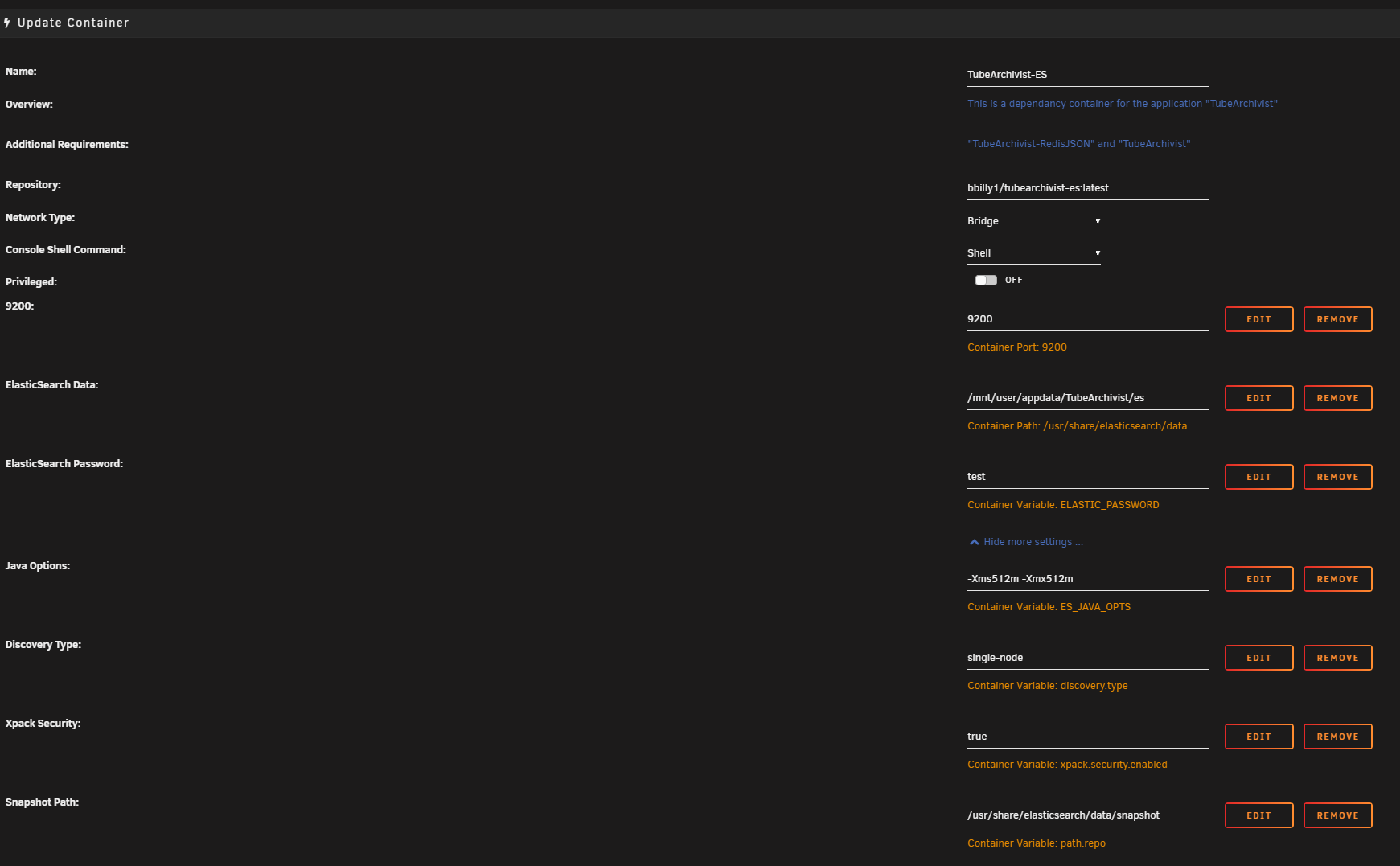

  10. Hi, I can't start the TubeArchivist-ES container. I get this error message every time and the container closes immediately. ERROR: Elasticsearch died while starting up, with exit code 1 Aug 30, 2024 2:41:33 PM sun.util.locale.provider.LocaleProviderAdapter <clinit> WARNING: COMPAT locale provider will be removed in a future release ERROR: Elasticsearch did not exit normally - check the logs at /usr/share/elasticsearch/logs/docker-cluster.log ERROR: Elasticsearch died while starting up, with exit code 1 Created elasticsearch keystore in /usr/share/elasticsearch/config/elasticsearch.keystore {"@timestamp":"2024-08-30T06:22:18.755Z", "log.level": "INFO", "message":"Using [jdk] native provider and native methods for [Linux]", "ecs.version": "1.2.0","service.name":"ES_ECS","event.dataset":"elasticsearch.server","process.thread.name":"main","log.logger":"org.elasticsearch.nativeaccess.NativeAccess","elasticsearch.node.name":"a7864d8b4521","elasticsearch.cluster.name":"docker-cluster"} {"@timestamp":"2024-08-30T06:22:18.945Z", "log.level": "INFO", "message":"Java vector incubator API enabled; uses preferredBitSize=256; FMA enabled", "ecs.version": "1.2.0","service.name":"ES_ECS","event.dataset":"elasticsearch.server","process.thread.name":"main","log.logger":"org.apache.lucene.internal.vectorization.PanamaVectorizationProvider","elasticsearch.node.name":"a7864d8b4521","elasticsearch.cluster.name":"docker-cluster"} {"@timestamp":"2024-08-30T06:22:18.950Z", "log.level":"ERROR", "message":"fatal exception while booting Elasticsearch", "ecs.version": "1.2.0","service.name":"ES_ECS","event.dataset":"elasticsearch.server","process.thread.name":"main","log.logger":"org.elasticsearch.bootstrap.Elasticsearch","elasticsearch.node.name":"a7864d8b4521","elasticsearch.cluster.name":"docker-cluster","error.type":"java.lang.IllegalStateException","error.message":"Unable to access 'path.repo' (/usr/share/elasticsearch/data/snapshot)","error.stack_trace":"java.lang.IllegalStateException: Unable to access 'path.repo' (/usr/share/elasticsearch/data/snapshot)\n\tat [email protected]/org.elasticsearch.bootstrap.FilePermissionUtils.addDirectoryPath(FilePermissionUtils.java:66)\n\tat [email protected]/org.elasticsearch.bootstrap.Security.addFilePermissions(Security.java:252)\n\tat [email protected]/org.elasticsearch.bootstrap.Security.createPermissions(Security.java:178)\n\tat [email protected]/org.elasticsearch.bootstrap.Security.configure(Security.java:125)\n\tat [email protected]/org.elasticsearch.bootstrap.Elasticsearch.initPhase2(Elasticsearch.java:202)\n\tat [email protected]/org.elasticsearch.bootstrap.Elasticsearch.main(Elasticsearch.java:74)\nCaused by: java.nio.file.AccessDeniedException: /usr/share/elasticsearch/data/snapshot\n\tat java.base/sun.nio.fs.UnixException.translateToIOException(UnixException.java:90)\n\tat java.base/sun.nio.fs.UnixException.rethrowAsIOException(UnixException.java:106)\n\tat java.base/sun.nio.fs.UnixException.rethrowAsIOException(UnixException.java:111)\n\tat java.base/sun.nio.fs.UnixFileSystemProvider.createDirectory(UnixFileSystemProvider.java:438)\n\tat java.base/java.nio.file.Files.createDirectory(Files.java:699)\n\tat java.base/java.nio.file.Files.createAndCheckIsDirectory(Files.java:807)\n\tat java.base/java.nio.file.Files.createDirectories(Files.java:793)\n\tat [email protected]/org.elasticsearch.bootstrap.Security.ensureDirectoryExists(Security.java:330)\n\tat [email protected]/org.elasticsearch.bootstrap.FilePermissionUtils.addDirectoryPath(FilePermissionUtils.java:64)\n\t... 5 more\n"} Does anyone have any idea what I could try? I have already tried changing the folder rights from nobody to root and back to nobody again. But that didn't help either.
