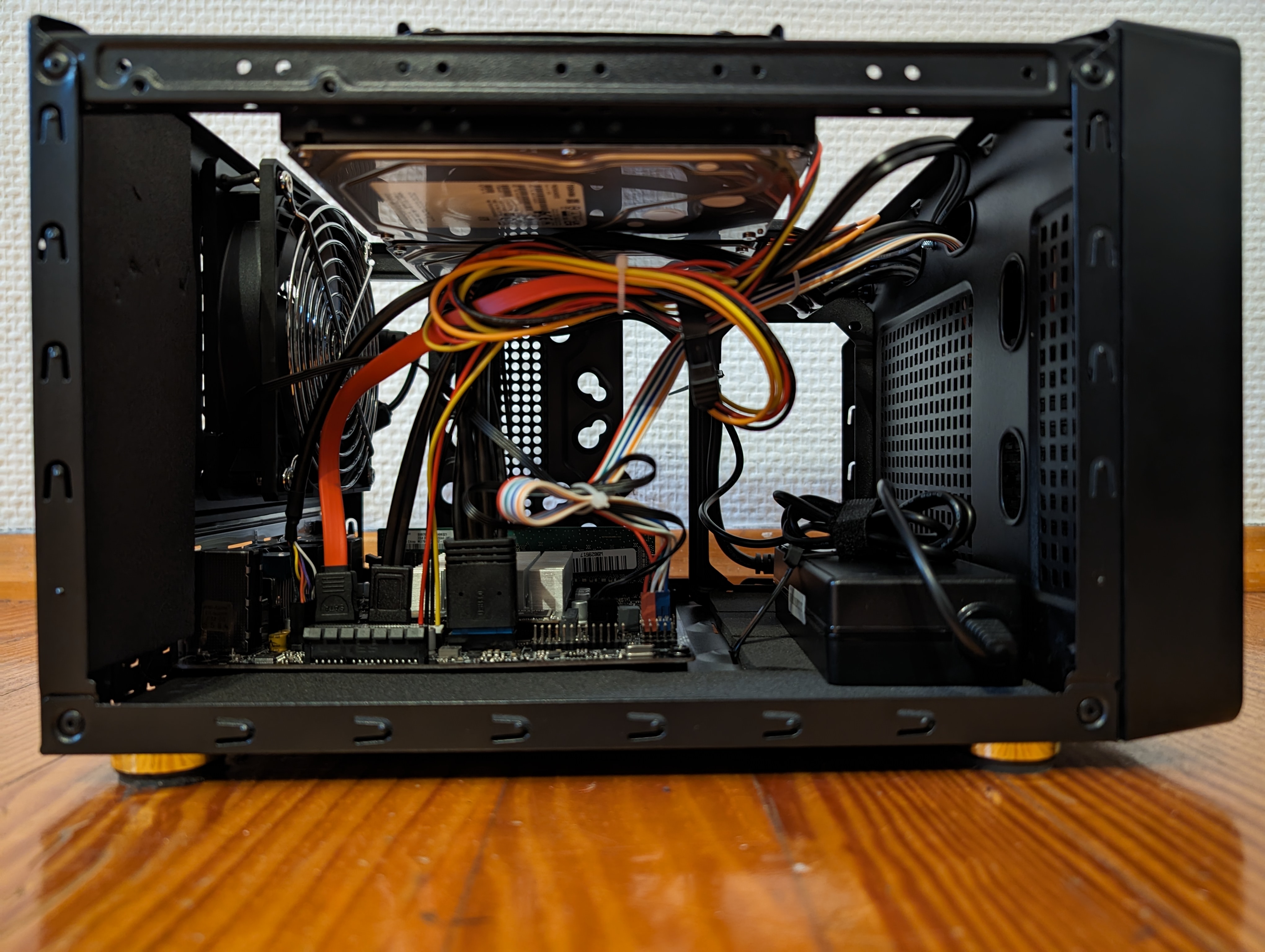

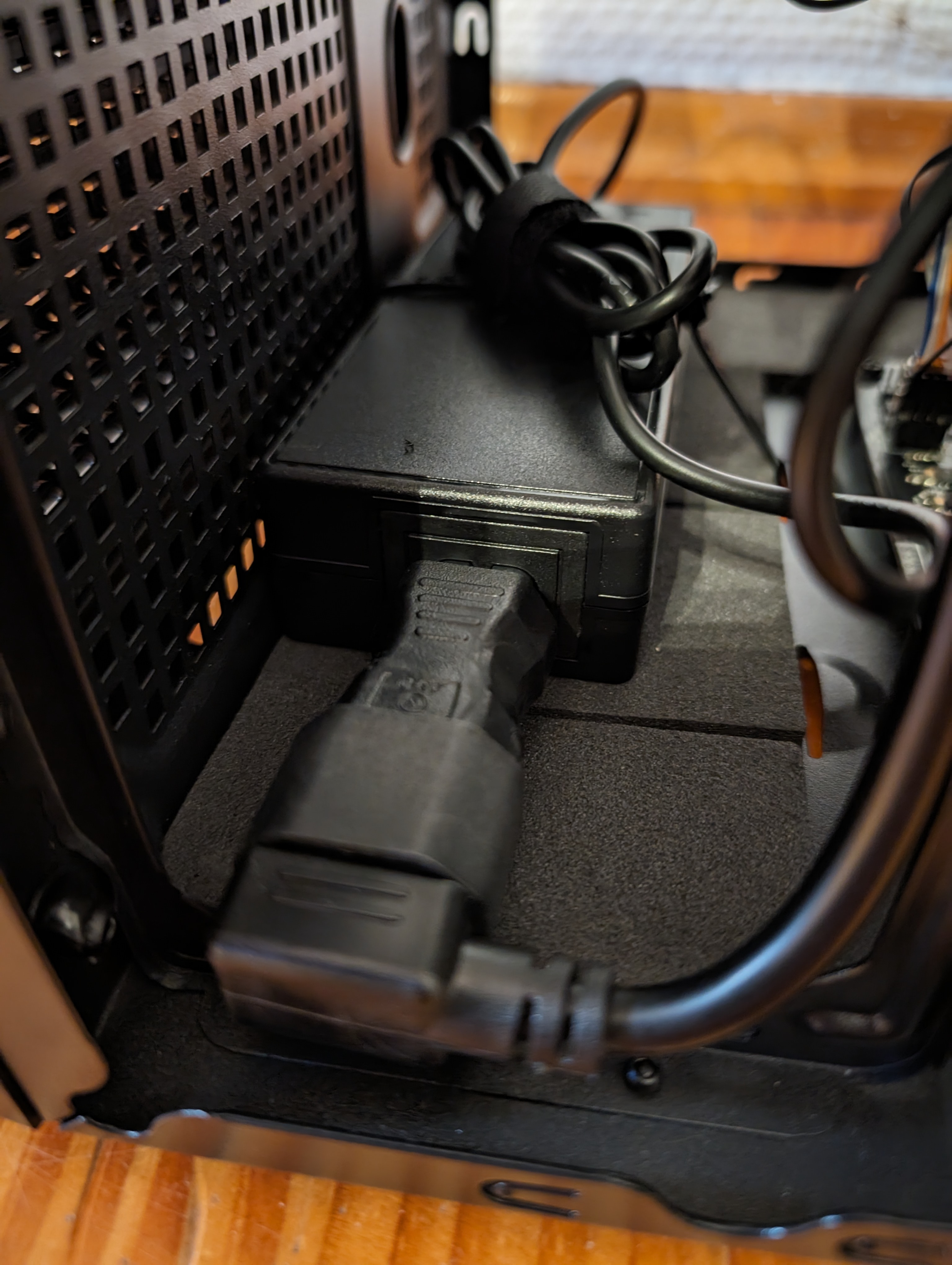

  7. Hi everybody, I'm stuck here: I can't get a wireguard client on my raspberry pi to work. I've set up some other clients - all were straight forward: read the conf file with the wireguard client, connect, done. Now what I've done on my raspberry pi: Set up a new wireguard peer (remote access to server) in the unraid VPN settings, unzipped the zip file and copied the .conf file to my raspi. On my raspi: sudo apt install wireguard copy .conf file to /etc/wireguard/wg0.conf phil@audrey:~ $ sudo wg-quick up wg0 [#] ip link add wg0 type wireguard [#] wg setconf wg0 /dev/fd/63 [#] ip -4 address add 10.253.1.7/32 dev wg0 [#] ip link set mtu 1412 up dev wg0 [#] ip -4 route add 192.168.187.16/32 dev wg0 [#] ip -4 route add 10.253.1.1/32 dev wg0 Now this looks fine to me. But then: phil@audrey:~ $ ping -c 3 10.253.1.1 PING 10.253.1.1 (10.253.1.1) 56(84) bytes of data. --- 10.253.1.1 ping statistics --- 3 packets transmitted, 0 received, 100% packet loss, time 2040ms Now I'm no networking whiz, so this is as far as debugging this went: Pinging myself with the 10.* IP address works: phil@audrey:~ $ ping -c 3 10.253.1.7 PING 10.253.1.7 (10.253.1.7) 56(84) bytes of data. 64 bytes from 10.253.1.7: icmp_seq=1 ttl=64 time=0.169 ms 64 bytes from 10.253.1.7: icmp_seq=2 ttl=64 time=0.159 ms 64 bytes from 10.253.1.7: icmp_seq=3 ttl=64 time=0.128 ms --- 10.253.1.7 ping statistics --- 3 packets transmitted, 3 received, 0% packet loss, time 2039ms rtt min/avg/max/mdev = 0.128/0.152/0.169/0.017 ms some more: phil@audrey:~ $ ifconfig wg0 wg0: flags=209<UP,POINTOPOINT,RUNNING,NOARP> mtu 1412 inet 10.253.1.7 netmask 255.255.255.255 destination 10.253.1.7 unspec 00-00-00-00-00-00-00-00-00-00-00-00-00-00-00-00 txqueuelen 1000 (UNSPEC) RX packets 0 bytes 0 (0.0 B) RX errors 0 dropped 0 overruns 0 frame 0 TX packets 26 bytes 3848 (3.7 KiB) TX errors 0 dropped 10 overruns 0 carrier 0 collisions 0 phil@audrey:~ $ sudo wg interface: wg0 public key: (hidden by me) private key: (hidden) listening port: 45918 peer: (hidden by me) preshared key: (hidden) endpoint: [2001:16b8:a02f:a8eb:2e3a:fdff:fec7:1d80]:51968 allowed ips: 10.253.1.1/32, 192.168.187.16/32 transfer: 0 B received, 3.76 KiB sent phil@audrey:~ $ ip address show dev wg0 5: wg0: <POINTOPOINT,NOARP,UP,LOWER_UP> mtu 1412 qdisc noqueue state UNKNOWN group default qlen 1000 link/none inet 10.253.1.7/32 scope global wg0 valid_lft forever preferred_lft forever Now I'm stuck. Any help is appreciated.

  10. I learned that kvm does not remove the space freed by trim from the img file automatically. This can be done with the qemu-img convert command. qemu-img convert -c -O qcow2 input.img output.img This converts a disk image into another format - in this case, qcow2 format. Since input is qcow2 format already it is not converted, just copied - but empty space is omitted from the copy. The -c option also enables compression, which slows down access to the image but saves a lot of space. So to clean up and compress your image, power down your VM, open a root console, cd into the matching directory (usually /mnt/user/<VMName>) and do the following: mv vdisk1.img vdisk1.img.bak qemu-img convert -c -O qcow2 vdisk1.img.bak vdisk1.img chown nobody vdisk1.img chgrp users vdisk1.img chmod 777 vdisk1.img If your VM starts up fine, you can delete the vdisk.img.bak file.
  11. Der ist Notwendig weil sonst die Temperatur der Platten beim parity check auf über 45°C geht. 200/min reichen aber dafür dass sie bei 40°C bleibt. Für den Prozessor ist er an sich nicht nötig, der drosselt halt wenn ihm zu warm wird. Ich habe ihn so eingestellt dass er ab 70°C Prozessortemperatur auf Vollast läuft.

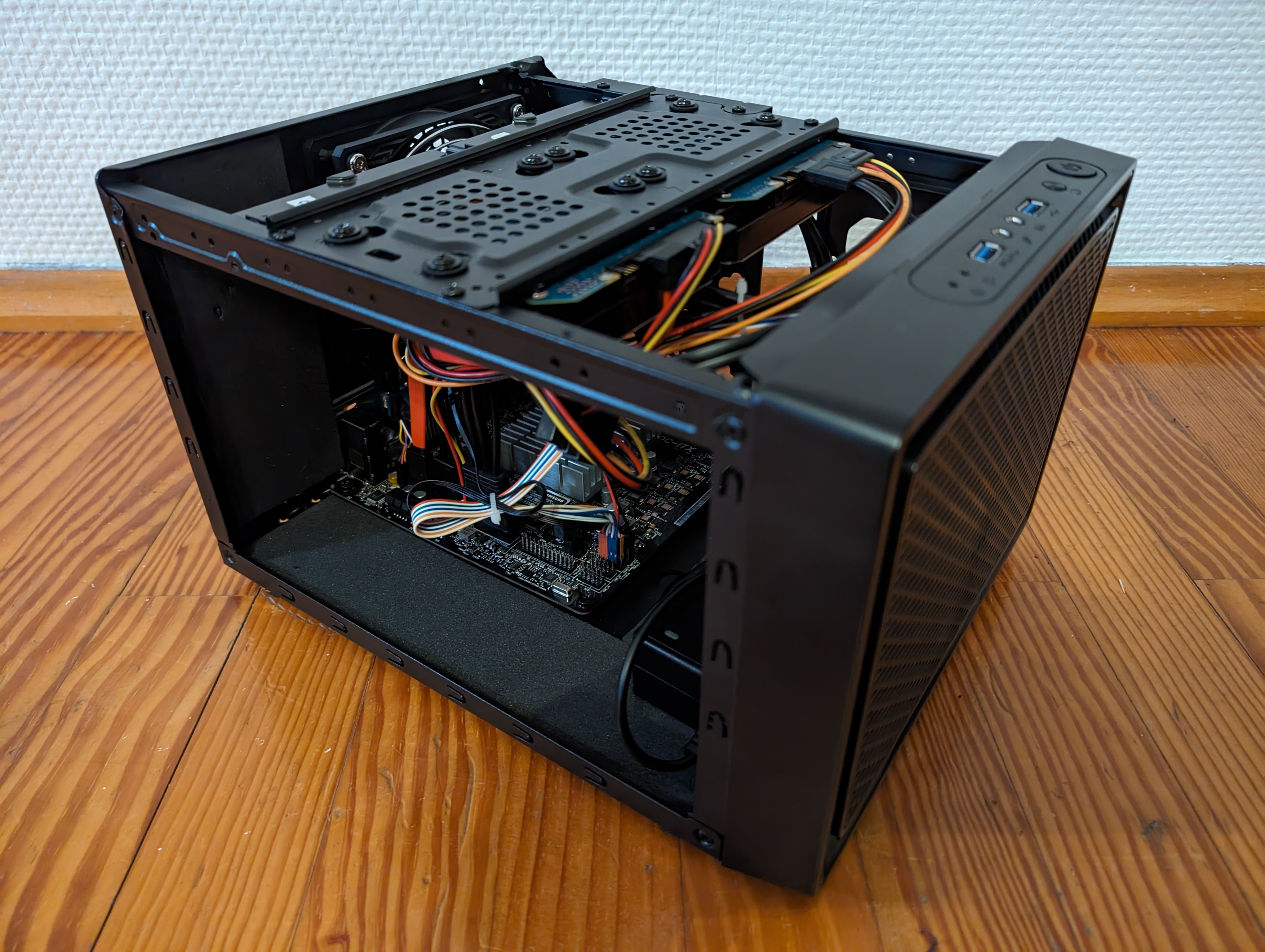

  12. Memtest sagt Errors: 0 nach einigen Stunden. Ohne manuelle Eingriffe in die Konfiguration. Hier ist mein Aufbau:
