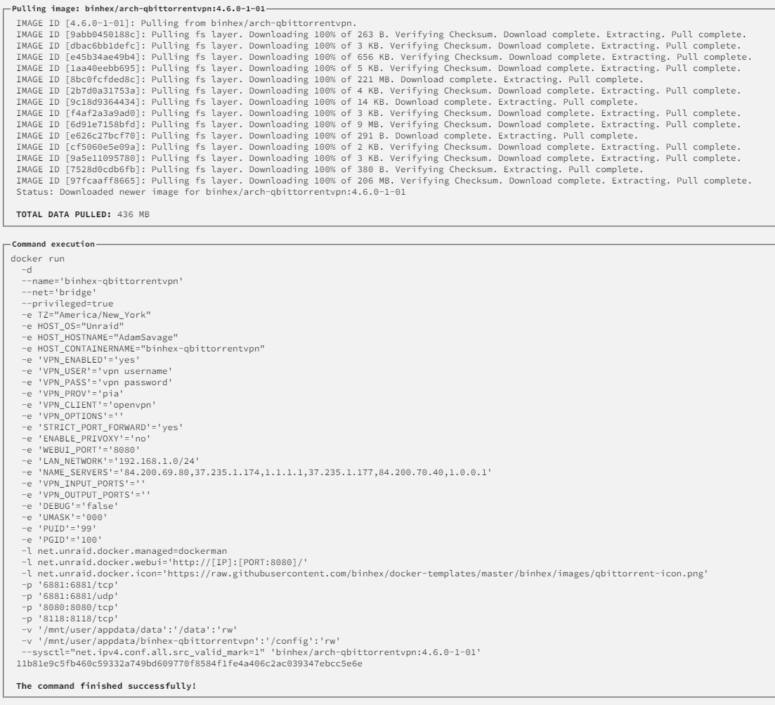

  3. Where do you see it is showing the current version? For giggles, I wiped out any orphaned images as well as appdata\binhex-qbittorrentvpn then re-pulled using binhex/arch-qbittorrentvpn:4.6.0-1-01 This is my run: I also tried following Q4 using port 8081 and two things occur: The WebUI still wants to goto port 8080, and still fails to reach the login if I manually point to 8081 in the URL. I even restarted the entire box and it still wants to do the same thing. netstat shows 8080 is listening netstat -a | grep "8080" tcp 0 0 0.0.0.0:8080 0.0.0.0:* LISTEN tcp6 0 0 [::]:8080 [::]:* LISTEN
  4. docker run -d --name='binhex-qbittorrentvpn' --net='bridge' --privileged=true -e TZ="America/New_York" -e HOST_OS="Unraid" -e HOST_HOSTNAME="AdamSavage" -e HOST_CONTAINERNAME="binhex-qbittorrentvpn" -e 'VPN_ENABLED'='yes' -e 'VPN_USER'= -e 'VPN_PASS'= -e 'VPN_PROV'='pia' -e 'VPN_CLIENT'='openvpn' -e 'VPN_OPTIONS'='' -e 'STRICT_PORT_FORWARD'='no' -e 'ENABLE_PRIVOXY'='no' -e 'WEBUI_PORT'='8080' -e 'LAN_NETWORK'='192.168.50.0/24' -e 'NAME_SERVERS'='84.200.69.80,37.235.1.174,1.1.1.1,37.235.1.177,84.200.70.40,1.0.0.1' -e 'VPN_INPUT_PORTS'='' -e 'VPN_OUTPUT_PORTS'='' -e 'DEBUG'='false' -e 'UMASK'='000' -e 'PUID'='99' -e 'PGID'='100' -l net.unraid.docker.managed=dockerman -l net.unraid.docker.webui='http://[IP]:[PORT:8080]/' -l net.unraid.docker.icon='https://raw.githubusercontent.com/binhex/docker-templates/master/binhex/images/qbittorrent-icon.png' -p '6881:6881/tcp' -p '6881:6881/udp' -p '8118:8118/tcp' -v '/mnt/user/appdata/data':'/data':'rw' -v '/mnt/user/appdata/binhex-qbittorrentvpn':'/config':'rw' --sysctl="net.ipv4.conf.all.src_valid_mark=1" 'binhex/arch-qbittorrentvpn:4.6.0-1-01' 6a0480f9e6a17470587918828c652581c2ba08413fc2b3308b818b1fd83b43c5 The command finished successfully! Correct. supervisord.log
  5. Appreciate your help so far, especially for combing through those. I changed this to no, but I still cannot access the webUI. Do I need to adjust any of the default values for these: Host Port 1 (Container Port: 6881) Host Port 2 (Container Port: 6881) Host Port 4 (Container Port: 8118) My gut tells me something on my network is blocking me from reaching 8080, but not sure what else to do. I have no other containers using port 8080 and I'm pretty sure I've opened it correctly in Defender.
