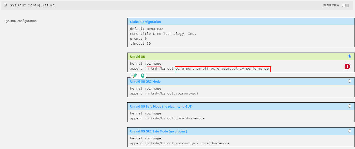

  11. In the syslog.txt in the diagnostic I found this: Feb 11 14:10:55 AG5-NAS-01 kernel: igc 0000:09:00.0 eth0: PCIe link lost, device now detached Which led me to this: Almost the same hardware. Trying to add this. Will get back with results.
  12. Hi! I recently built a new Unraid server. I have a problem where Unraid crashes several times a day. This is an AMD build so I have tried: Disable C-state Configure Power Syplli Idle Control to "Typical Current Idle" Memtest - All memories passed OK The crashes seems to happen randomly. When it happens I cannot ping the server and I cannot browse to the Unraid GUI. The last crash was around ~14:15 11/2-2024. I have attached the syslog and the diagnostics to this post syslog-10.201.24.41.log ag5-nas-01-diagnostics-20240211-1413.zip
