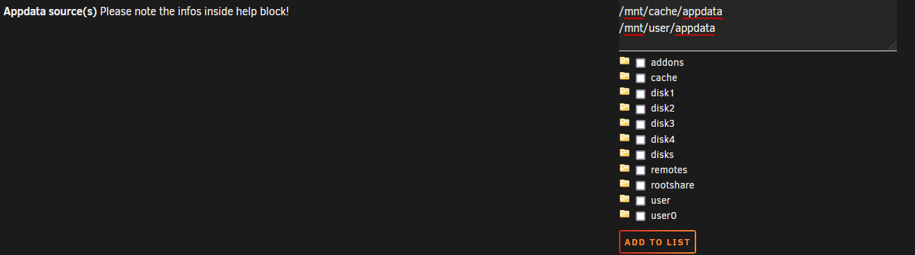

Hey, today i got a error at the backup, the debug log ID is: f6f359d8-f506-4265-bf16-654ea99ddd0b It worked for months without issues, but today i added another folder to the extra folders list, its nothing special, just backup folder from another system, nothing is executed from there. I tried to delete it from the list again, any change. My extra folders: /mnt/user/domains /mnt/user/system /mnt/user/cloud /mnt/user/backup The error suggest that it has problems to backup stuff in here: /mnt/user/system/docker/installed/zfs/graph /mnt/user/system/docker/installed/containers Not sure if i should exclude this, but it worked before without doing it 😅 Another thing i noticed that the link in the email notification leads to the wrong DNS. Is there a way to change it?

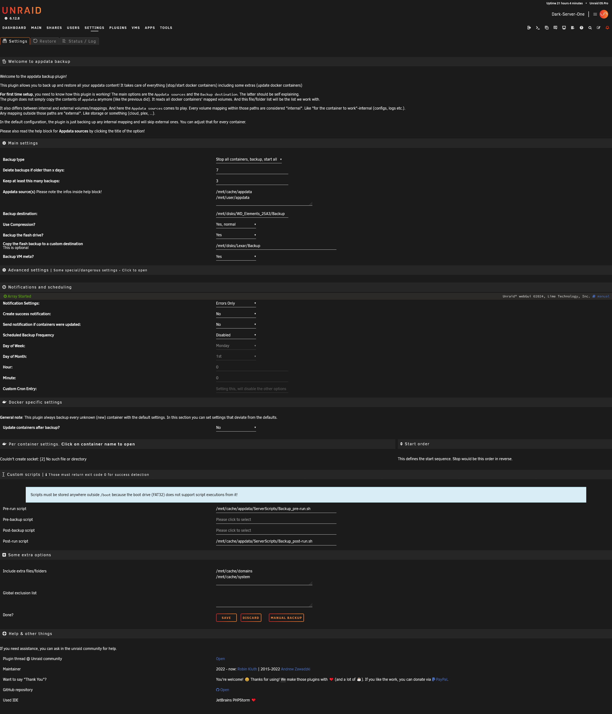

Hey, i got few issues with this plugin unfortunately: The plugin seems to check if the destination is available before running the pre-run script, which leads to an error, because my backup drives are detach and unmounted and the pre-run script has to attach and mount them before (see 5.). My scripts can't be executed, i get a error. The are saved on my cache pool drives with ZFS as fs, thats my scripts: Backup_pre-run.sh: #!/bin/bash # Attach the backup disks /usr/local/sbin/rc.unassigned attach WD_Elements_25A3_564748334E355047-0:0 /usr/local/sbin/rc.unassigned attach Lexar_USB_Flash_Drive_901451523E981815-0:0 # Mount the backup disks /usr/local/sbin/rc.unassigned mount name=Backup1 /usr/local/sbin/rc.unassigned mount name=Backup2 Backup_post-run.sh: #!/bin/bash # Unmount the backup disks /usr/local/sbin/rc.unassigned umount name=Backup1 /usr/local/sbin/rc.unassigned umount name=Backup2 # Detach the backup disks /usr/local/sbin/rc.unassigned detach name=Backup1 /usr/local/sbin/rc.unassigned detach name=Backup2 The compression part seems to use only one core, is there a way to let it use more, to speed it up, to reduce down times of the container/VMs? My VM does not get a backup, because it does not get stopped and the plugin throws an error because the VM disks gets used of course. I thought this plugin does also stops and restarts VMs. Which is the best way to do this for schedule runs? It seems that my post-run script not getting executed as well, but there is not error for it in the log: [27.02.2024 00:37:12][ℹ️][Main] 👋 WELCOME TO APPDATA.BACKUP!! :D [27.02.2024 00:37:12][ℹ️][Main] Backing up from: /mnt/cache/appdata, /mnt/user/appdata [27.02.2024 00:37:12][ℹ️][Main] Backing up to: /mnt/disks/WD_Elements_25A3/Backup/ab_20240227_003712 [27.02.2024 00:37:12][❌][Main] /mnt/cache/appdata/ServerScripts/Backup_pre-run.sh is not executable! Skipping! [27.02.2024 00:37:14][⚠️][Main] There are no docker containers to back up! [27.02.2024 00:37:14][ℹ️][Main] Backing up the flash drive. [27.02.2024 00:37:41][ℹ️][Main] Flash backup created! [27.02.2024 00:37:41][ℹ️][Main] Copying the flash backup to '/mnt/disks/Lexar/Backup' as well... [27.02.2024 00:37:42][ℹ️][Main] VM meta backup enabled! Backing up... [27.02.2024 00:37:42][ℹ️][Main] Done! [27.02.2024 00:37:42][ℹ️][Main] Backing up extra files... [27.02.2024 00:52:00][❌][Main] tar creation failed! Tar said: tar: /mnt/cache/domains/HomeAssistant/haos_ova-11.5.qcow2: file changed as we read it [27.02.2024 00:52:03][ℹ️][Main] Checking retention... [27.02.2024 00:52:03][ℹ️][Main] DONE! Thanks for using this plugin and have a safe day ;) [27.02.2024 00:52:03][ℹ️][Main] ❤️ In Firefox (123.0) it is not possible to select new sources etc. over the menu, when i click on a folder/checkbox, it just reloads the site, no issue with Chrome: My settings:
