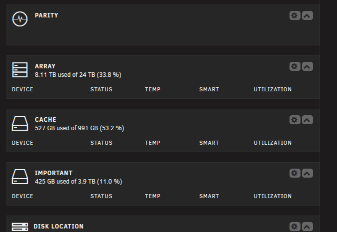

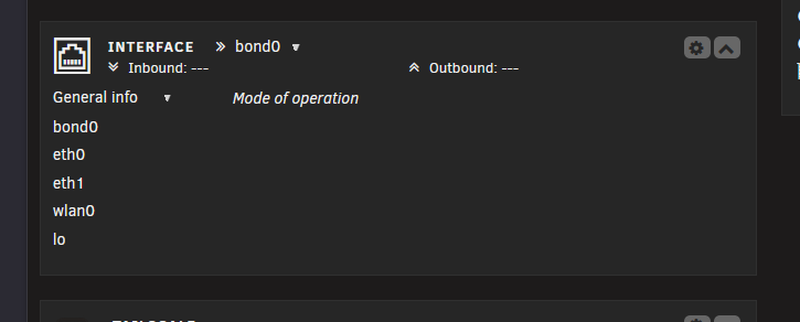

  9. I installed the plugin, but did not do anything to configure. I went to my dashboard and a lot of information is suddenly missing. Like disk list and network information. I uninstalled the plugin and it is still the same. Not sure if the plugin or dependency broke it.
