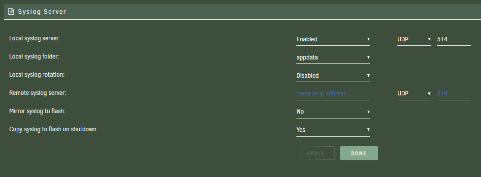

  8. Sure! Here's what I have for syslog server settings. Also, I've also successfully completed the parity rebuild without further crashes! It's hard to say for sure I 100% fixed it given the crashes were random and I might just be on a lucky streak, but the change I made that seems to have helped was removing the UPS communication cable. The cable has an RJ45 style connector on the UPS end (USB on the Unraid end) and I noticed the stay clip on the RJ45 was busted. This probably meant the cable had taken a hit at some point and I thought perhaps the damaged cable was disrupting Unraid's communication with its UPS. Because my Unraid server is configured to shut itself down when the UPS battery only has a few minutes of runtime left, it's possible disruptions in UPS communications might be causing the server to shut down.
  9. There isn't anything in /boot/logs other than the diagnostics I've generated trying to troubleshoot this: # ls -lah /boot/logs total 656K drwx------ 2 root root 16K Apr 1 17:50 ./ drwx------ 10 root root 16K Dec 31 1969 ../ -rw------- 1 root root 224K Apr 1 07:56 greenplanet-diagnostics-20240401-0755.zip -rw------- 1 root root 176K Apr 1 16:55 greenplanet-diagnostics-20240401-1655.zip -rw------- 1 root root 217K Apr 1 17:01 greenplanet-diagnostics-20240401-1701.zip I've now triple-checked that syslog server is indeed enabled so I have now tried disabling syslog rotation in the hopes that helps?

  12. Syslog server is enabled and it is set to copy to flash on shutdown. I don't see the "syslog-previous.txt" file referenced in the tooltips and I'm not sure if that's indicative of a problem of some kind, but there is a syslog file in the diagnostics I posted.
