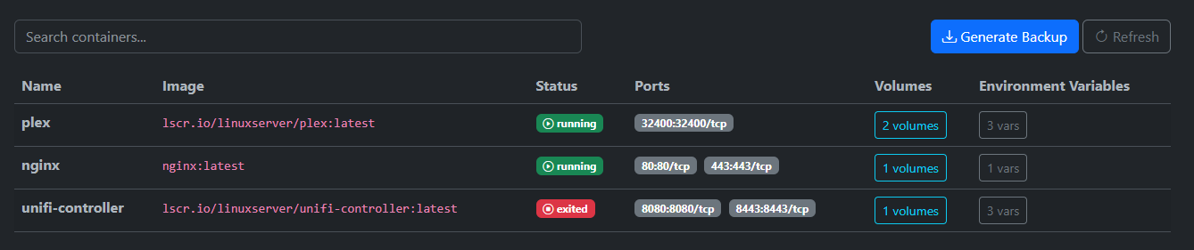

  2. after insert "--user 99:100" the problem with \output is gone. BUT now i have the issue with only 3 containers. here my guardian log: and here my dockersocket log: I don't know what to do and haven't found anything on the three pages that helps me!
  3. i have installed 1.0.5 and creating a new output folder doesnt work.
  4. After the update absolutely didn’t work for me either, I completely removed the docker from Unraid and reinstalled it! Now the following error appears: /entrypoint.sh: line 39: /config/config.yml: Permission denied /entrypoint.sh: line 39: /config/config.yml: Permission denied Setting up cron job with schedule: 0 2 * * 0 Creating initial configuration... Setting up cron job with schedule: 0 2 * * 0 Creating initial configuration... I’d say, sorry, but never stop a running system.
