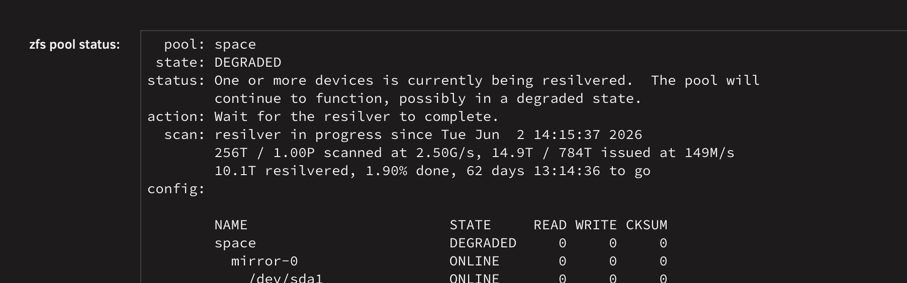

Resilver completion time % has been increasing much faster since running your command changes. Last night, I had to work on a couple tasks (adding media etc), so I took a few snapshots while performing those tasks > 12.txt Then just now, I checked it again, and it's back to much calmer performance, and has gained a decent % upgrade > 13.txt Still chugging along, I still find it quite odd how long this reilver process is; and am trying to decide the best way to perform the next step (replacing the remaining 16TB drives to 18TB). 1) Remove Mirror Pairs and re-add with 2x18TB -- Wondering if this will also help with spreading data across more drives. 2) Perform yet another ~1 month resilver just like this one 3) Replace only 4 or 6 at a time, to remove such a high resilver call on the pool I am wondering, if after this resilver completes, if performing any of the above options will run faster. Thinking back to an earlier thread of you and I discussing this very topic, after a scrub/resilver > well a subsequent scrub/resilver finish faster? 12.txt13.txt

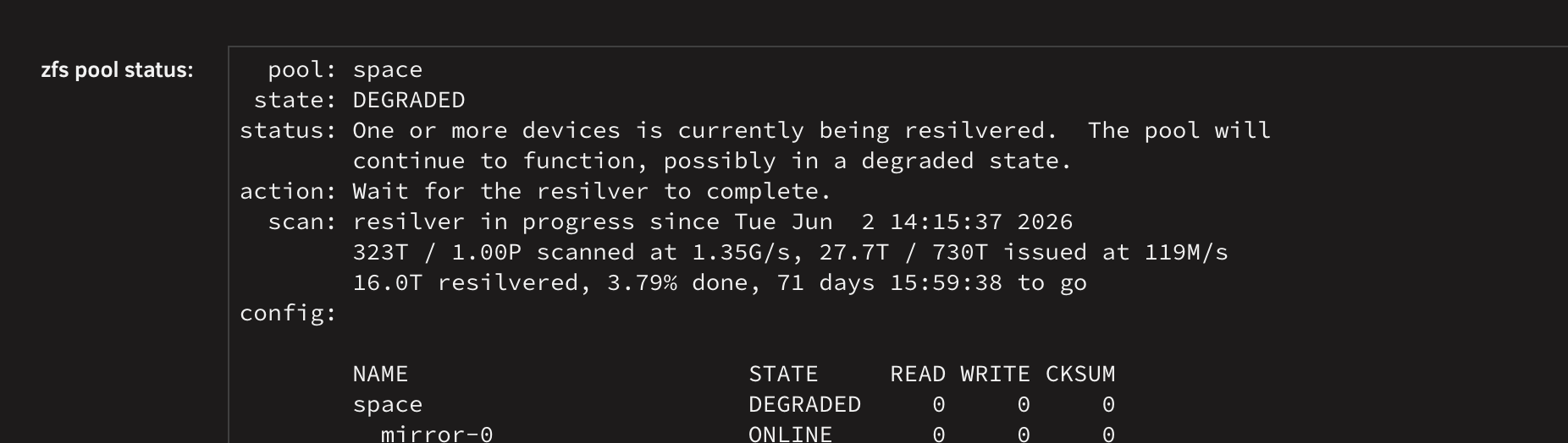

Got it, I think some of this is what I have learned from that linked article from earlier.. But definitely do not have a strong enough knowledge on how it works. But I'm reading up on it. I have updated with your commands, will wait a short bit of time and capture some outputs Thank you so much @JorgeB !! Current Progress prior to commands:

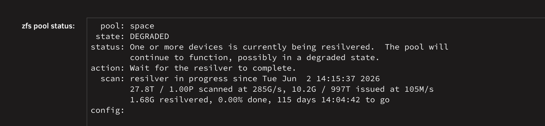

I decided to let a major download task occur, and ran the command during that data download. The drives near the bottom are the most empty of the drives, and not part of the resilver.. But this was just to get another look, with high speed download. EDIT Adding a few more examples, so really interesting wait times. I'm not sure how to read into it. 4.txt 5.txt 6.txt

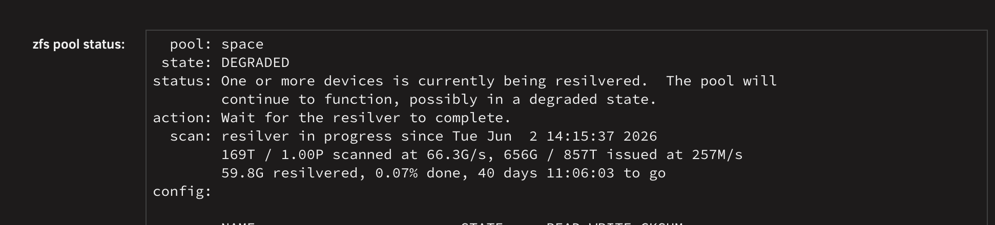

Just getting to this. Current state and attached PDF; as well as a few outputs from the above command. Only 1 or 2 or the mirror pairs are moving data... The expected finish time is now climbing. See page 2 of this thread to see another result 3.txt 2.txt 1.txt

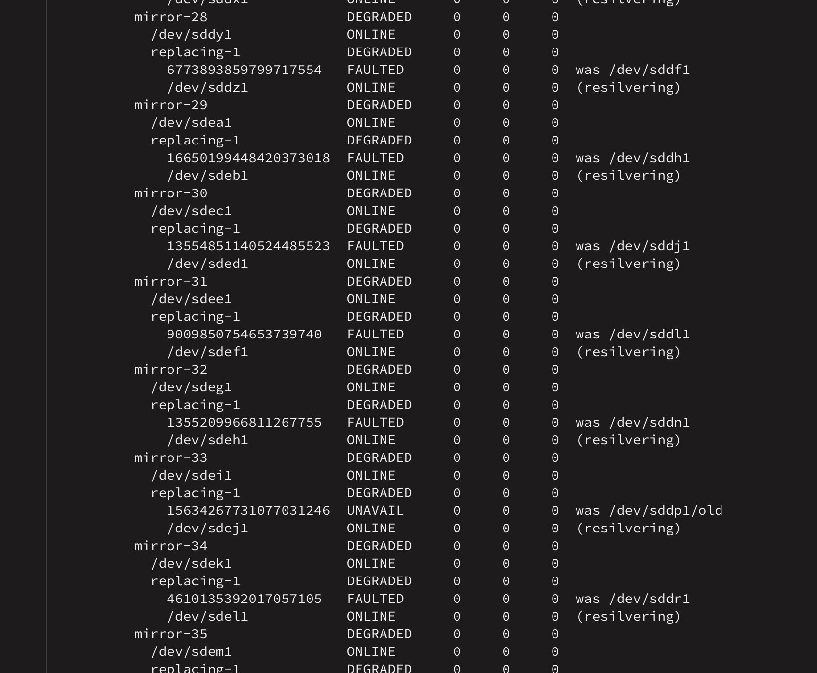

@JorgeB Maybe at this point I should create a new topic to discuss this further, but I am still a bit confused on the tasks to rebuild mirrored sets. My 'resilver' has now slowed down tremendously. You can see the speeds of scanned and issued are much slower. I am getting much more random reads compared to writes. ** I read this article about why rebuilds could be slow (I didn't attempt anything from it, just read it). And I'm somewhat perplexed by how my pool reacts during this resilver. Note, this server is mainly a media server, so not a lot of 'hard-hitting' applications, in fact none really at all. -- However, right now, if I start downloading new content, the resilver will slow even further. I would expect that if a file wanting to be accessed (such as a movie that is located on one of the degraded drives) would become slow due to the drive being access. I am wondering if some of the tactics shown in that article can be used to identify why this process is taking soo much time. I understand that ZFS has the 'catalog' or whatever it's called that it refers to which files are where. But my pool is made up of Mirrored pairs.. With very static content, that are fairly large files. I can't conceive why a resilver takes 2-3 weeks, to replace 12 pairs. 12 x 18TB drives = 216 TB of data to be restored (theoretically on 16TB as that was the source size). I am confused on the issued amount during this process. Article: https://cr0x.net/en/zfs-resilver-rebuild-speedup/ server_Main-13.pdf

@JorgeB for records-sake. I was able to stop the array/pool move a bunch of drives around to isolate the resilvering pairs (I may not have done it to the best isolation, but decent enough)... I can confirm: 1) The resilver picked right back up 2) The resilver copy speed has increased by almost double 3) I got caught up in why the drives appeared in the same place on the MAIN tab, but realized that's just how unraid sees the slots, it has no care where they are plugged into as long as the system can see the drives as they were before. 4) Google Fiber is amazing (this is just a fun extra note, as I got 8g/8g fiber installed today!) Will be continuing to wait the resilver for now. REPEAT QUESTION for future clarification: -- When upgrading mirror pairs with larger drives, is it better to manually remove the pairs from the pool OR perform the two-stage process that I am doing, which will call for 2x scan/scrub of the pool. server_Main-9.pdf

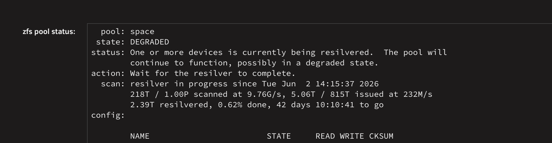

The only confidence I had, was watching the Main tab read/writes, the drives that were replaced had exact matching reads to write (16tb to 18TB) combinations. Other than that, I have no concrete evidence that it was in parallel. My incorrect assumption was the command above would check that, but as I said, I read too fast and incorrectly assumed that. haha my fault for sure. For now, I saw the stats on the pool page, reset. Here are two screen shots one from yesterday, one from just after I ran your command. As well as your requests: June 01 June 02 (after command) June 02 (now, looks like the process has scanned at a much higher rate than earlier) Attached a 'print to pdf' of the Main tab, since it would take numerous screens (Let me know if you prefer screenshots, i can do that too) server_Main.pdfserver-diagnostics-20260602-1456.zip
Resilver vs Remove Mirrors [Time to Scrub/Replace/Resilver 1month+]
Hey @JorgeB thanks for the reply. Unraid 7.3.1 Well, facepalm moment for me, as I read and typed too quickly. I thought your command would be to check if they were simultaneous, not to re-start the process. I was monitoring the read/writes and there were matching reads<>writes on the various pairs. Now, it just restarted the whole thing. :☹️ Back to 40 days ETA. Now I'm curious if the time will reduce quicker since the drives already have data, or will it start fresh again? I had a thread a couple days ago, which showed screenshots, I believe it was resilvering all drives simultaneously.. Similar to what it's showing now again:

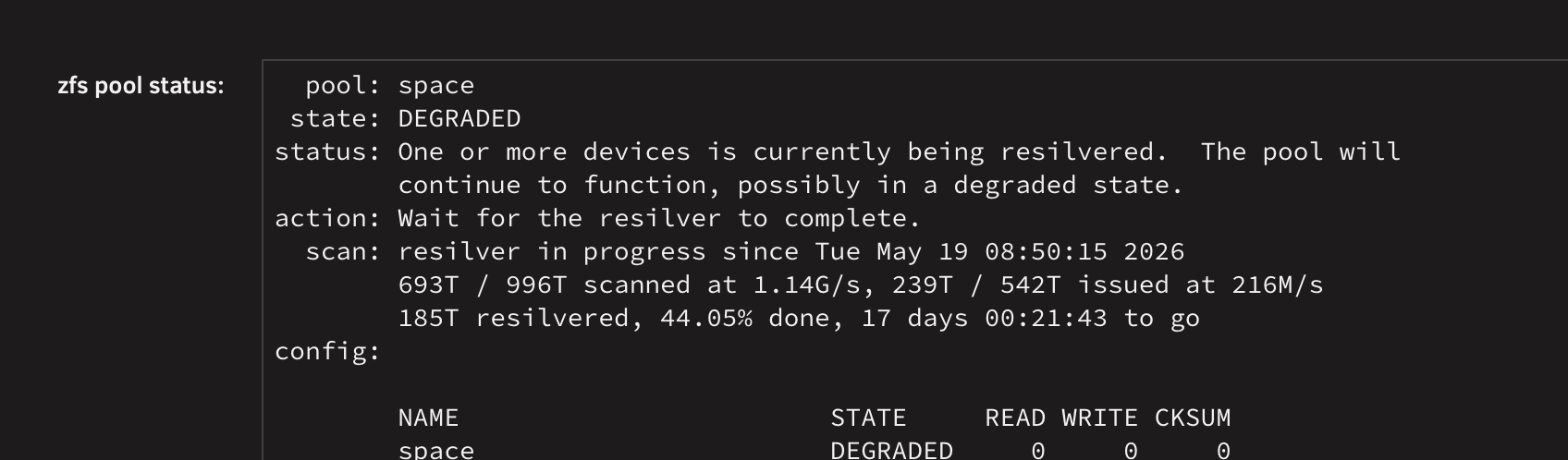

This is related to a recent post of mine, where I have 12 mirror pairs of 16TB drives as part of a larger ZFS mirror set pool. I wanted to replace the 16TB drives with 18TB drives. I figured it would be easy to remove one drive from each mirror pair, and then select the new 18TB for each set.. It would proceed to copy the data from the original mirror to the new mirror pair drive. However, I forgot that 'resilvering' in this situation, would virtually scrub the whole (1.3PB) pool, while trying to resilver the drives. (I had this happen a long time ago for a single drive replacement). This resilver has been working for over 2 weeks now, with about 2 weeks remaining. I am wondering, if I should change the process: 1) Should I stop the resilver, and then remove the mirror pairs manually? Would this be safe, in that it would just copy the data to the still active pool devices (outside of these replacement sets)? 2) If I let this resilver finish, and then proceed with part 2 which is removing the original 16TB drive, and adding in the second 18TB.. I would expect the 1 month resilver process to occur again?? ** Why I think this is a terrible process, where the ZFS pool essentially scrubs the entire pool, to replace a single drive or multiple at one time, is that it hits the pool with 100% requests. so all the drives are being hit simultaneously, which hurts performance with all the containers I have running. I am open to any thoughts and suggestions! Thank you!
