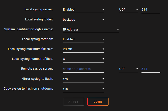

  1. Here are my syslog server settings Im gonna check out the other steps you posted alter when im home
  2. I had it over the last 2 days that my server was assumingly randomly crashing while I was at work. I have local logs enabled but since non were saved I assume it was a hard crash. I dont know how to allocate the issue. The power doesnt seem to be the issue. Im gonna attach my diagnostics. Maybe you guys have an idea what I could do. The only thing I did in the last few days was updating to the newest nvidia driver with the nvidia plugin. server-diagnostics-20250219-1838.zip

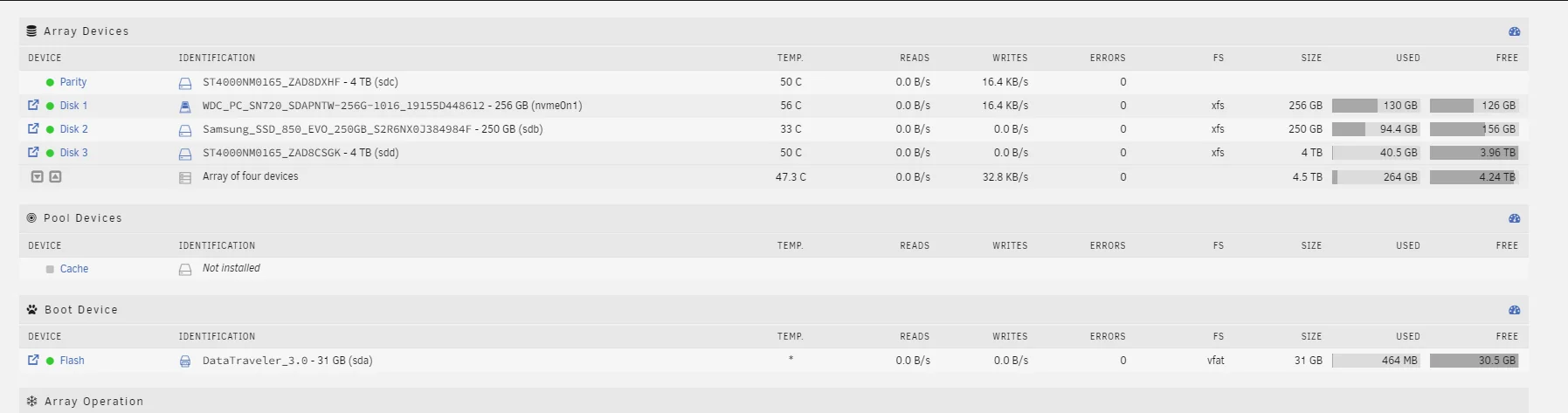

  9. What slot would I need and why exactly? Sorry im quite new to all of this. Im running unraid of an fujitsu esprimo q958. It does have 2 sata ports on the mainboard but no way I can run power to the drives to power them so I decided an external docking station might be easier.
  10. Hi guys, I'm very new to unraid and just been using it for a week. I got my hands on an sorted out workstation from work and figured its the perfect timing for getting into home server stuff since I have been planning on getting into it for a while already. I have a 256GB nvme drive that is on the mainboard, an old 250GB 850 Samsung EVO connected via USB and also an external docking station with 2 4TB HDDs connected via USB. All at least USB 3.0. Sadly the mainboard of this small workstation is very limited and I dont have a lot option connecting anything on the board directly via sata. I'm trying to figure out if my config is alright and if I need a cache drive for it and if yes which of my drives I should use for that. Heres my current config. MY appdata is currently on the nvme I would appreciate some advice! Thanks
