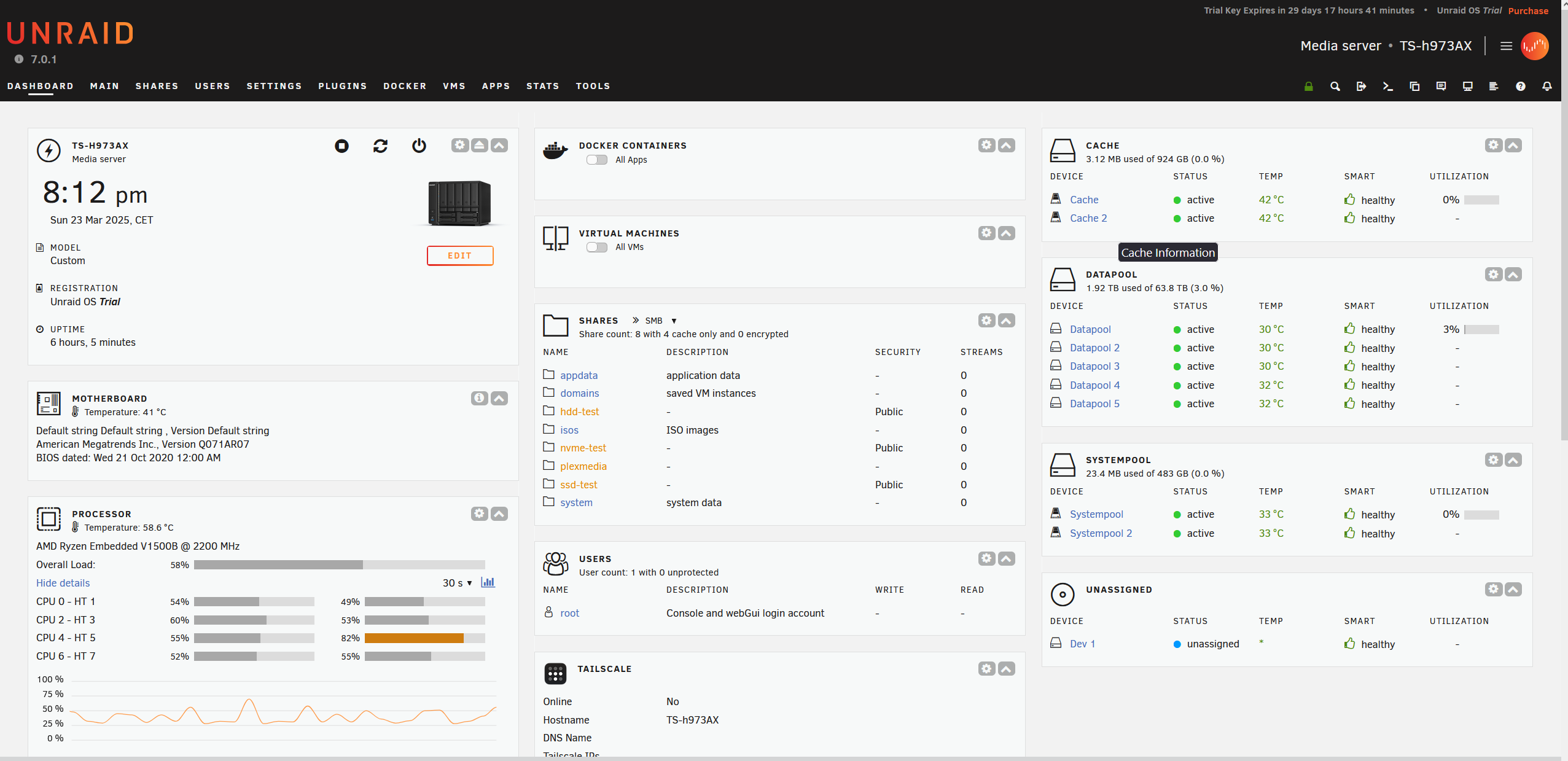

  3. I converted my QNAP TS-h973AX to UNRAID. Initially configuring UNRAID on a trial license to test things. But I'm really happy with the QNAP running UNRAID so will decommission my other UNRAID system that has a pro lifetime license on it's flashdrive. So now I need to: 1) transfer the pro license to the flash drive in the QNAP, or 2) copy the configuration/setup made on that 'trial' flash drive to the flashdrive that has the pro license, to put it in the QNAP Not sure option 2 is valid and what contents of the 'trial' flashdrive I'd have to copy to the 'pro' flashdrive to make it all work as configured? Transferring a license to another flashdrive is limited to once a year I think, so option 2 might be my preffered option, saving the license transfer in case the USB stick should fail. Hope I made my situation/options clear, not a native english speaker;-) Any tips/suggestions will be highly appreciated! Thanks and regards, Richard

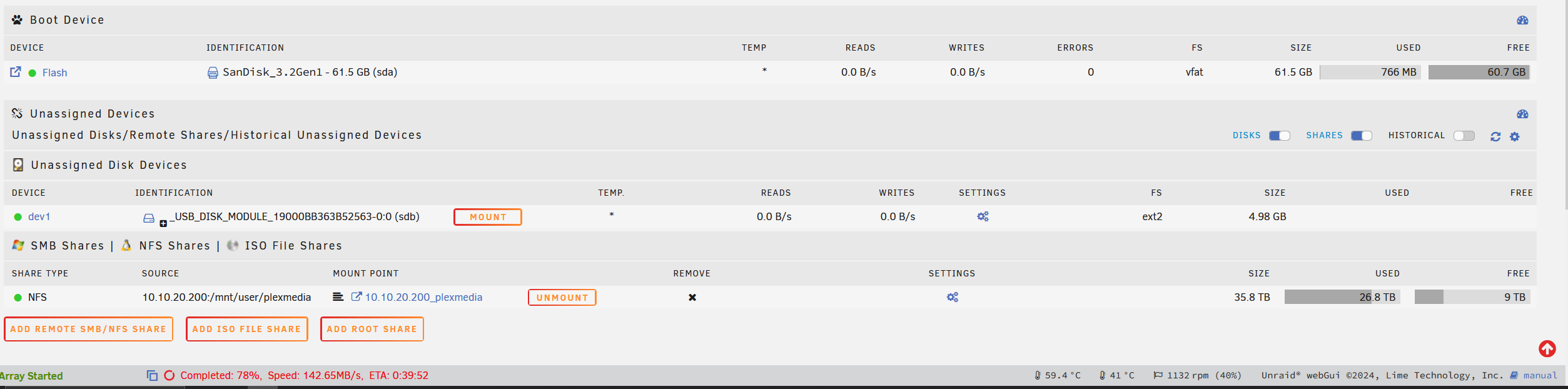

  4. I was told by someone yesterday (and could not believe it) that you don't need to do anything other than insert an Unraid flash drive into one of the back usb ports of the TS-h973AX. Today I can confirm this from own experience. No opening the case, messing with the glued DOM or getting into the BIOS by means of a tty port header on the MB. It just booted and runs fine so far. I had usual issues with the Unraid USB Creator and a new 64GB Sandisk, so prepared the Sandisk with Rufus to have it formatted with 'large FAT32' making it a non-bootable. Then just copied the unzipped 7.0.1 download onto it. Maybe avoiding the USB Creator is part of the 'magic' but that's what I felt seeing the GUI appear. The TS-h973AX DOM appears as Dev1, best left alone ofc. If you'd pull the Unraid Flash drive it will boot into QuTS again...... But why...? Currently copying my media back onto the RAIDZ1 I created on Unraid;-) Regard, R.
