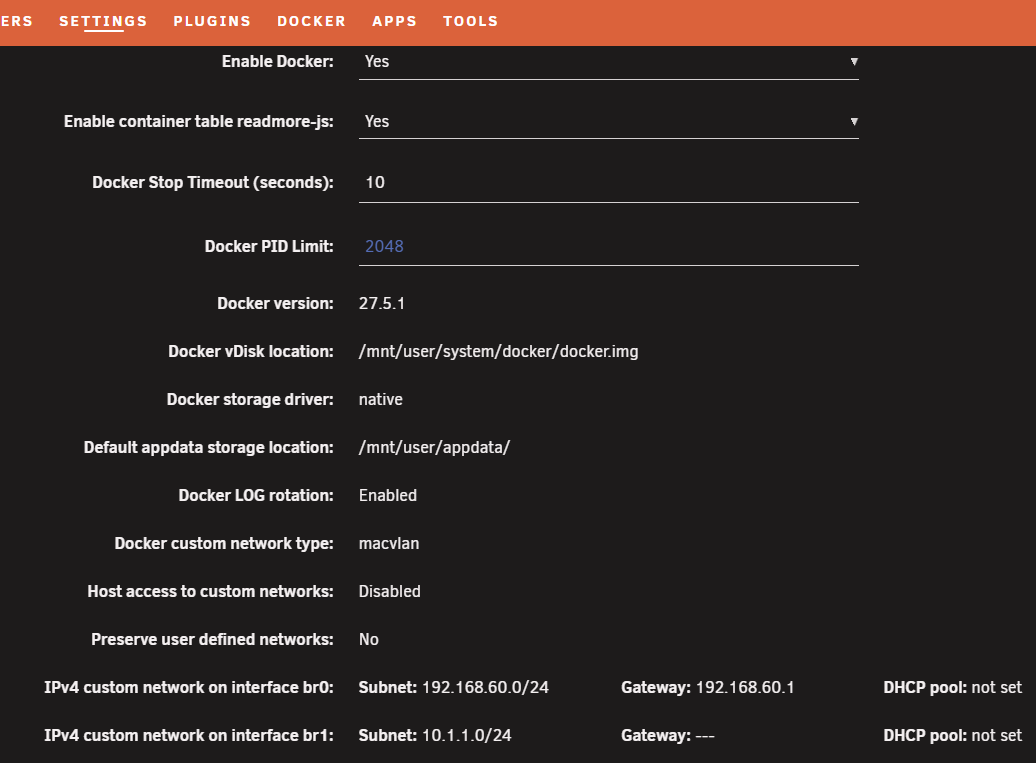

I think i managed to have the frigate container have access to both eth0 and eth1 by following instructions from gemini which told me to define a macvlan for br1 (eth1). i did this by puting in the cli: docker network create -d macvlan --subnet=10.1.1.0/24 --gateway=10.1.1.1 -o parent=br1 cam_network then i added the following to the post arguments in the frigate docker container settings: && docker network connect cam_network frigate Now frigate seems to have an IP address both on the bridge network and the cam_network. In order to be able to pign my camera, i first had to install the ping utility in the frigate container, as it seemed to not have it by default, i did so by following these instructions i.e. putting following commands in the CLI: docker container exec -it frigate bash apt update apt install iputils-ping exit then pinging the camera from frigate via the cli gave the following result: the errors in frigate Error opening input file rtsp://:@10.1.1.66:554/rtsp. ERROR : Error opening input files: Server returned 404 Not Found still persist though... Anyone has an idea what i might strill be doing wrong?

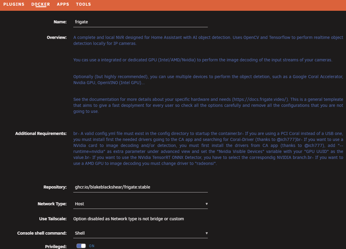

Hi, i want to move my Dahua home security cameras from recording to the Dahua NVR to the Unraid Frigate Docker Container. I have installed a second NIC in the server and created an isolated camera subnet 10.1.1.1/24. I am able to ping the cameras from the Unraid main page CLI, but fail to connect to them from Frigate . Below an overview of the setup: i see following errors in the system log: Error opening input file rtsp://:@10.1.1.66:554/rtsp. ERROR : Error opening input files: Server returned 404 Not Found Attached you can find my frigat system logs. the Frigate container seems to be assigned the IP address of my server on the main VLAN, and hence doesn't seem to have an IP address on the camera subnet: Below my docker settings: and my frigate container settings: My frigate container network type is set to host instead of bridge in order to have access to both eth0 and eth1, maybe i need to also configure something else? Or is this not the right approach and should I create a MACVlan or IPVlan? Not sure how to do this though so if someone could provide some guidance please? I also noticed that in the network type options br1 is not shown as an option which leads me to believe that eth1 (br1) is not passed to docker or its containers. is this observation correct? Can someone guide me please what i should do to have docker, and in partical the frigate container, access to both network interfaces? Also can someone explain me please how i can ping from inside the docker / container environment? frigate-logs (1).txt

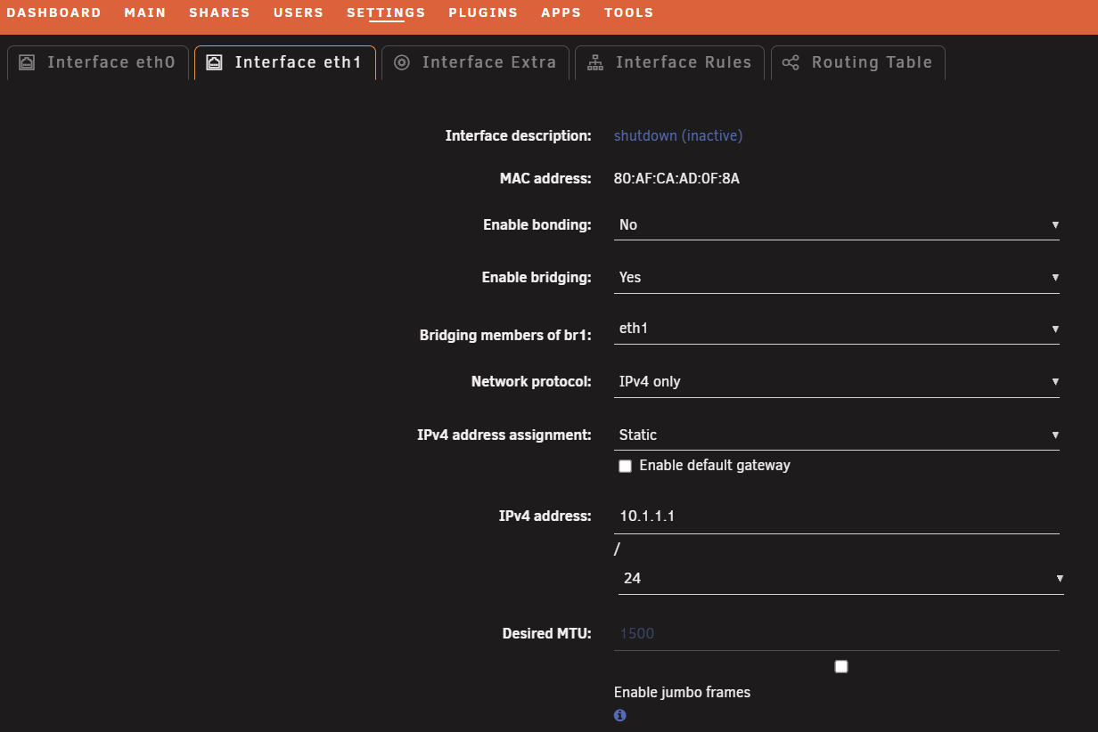

Update, i have internet connection back by specifying the eth1 static IP address as 10.1.1.0 instead of 10.1.1.1. This eth1 is for a camera subnet which i am still trying to set up, i was suggested by someone on github where i asked help for setting up frigate, that i probably should set my eth1 network interface to 10.1.1.1 instead of 10.1.1.0. But i guess this is not the right way then.

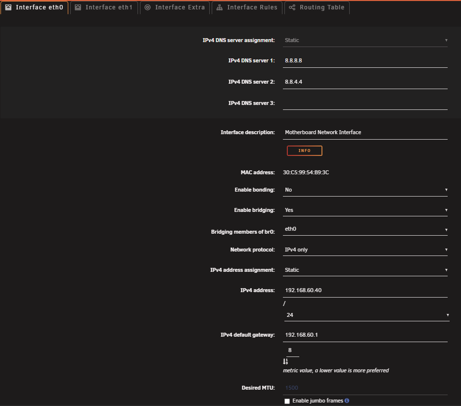

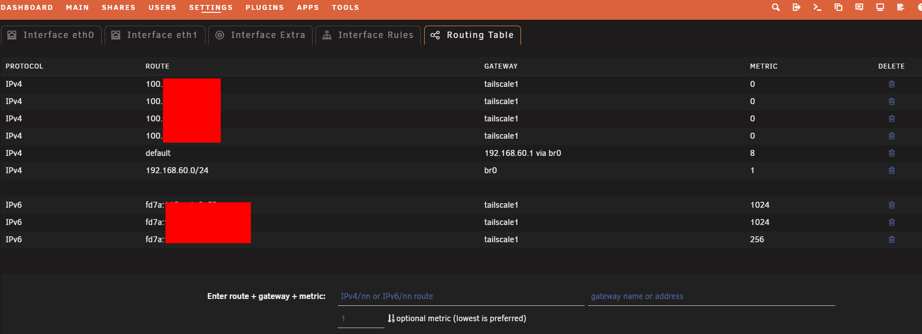

When i ping my router from the server CLI, i am unable to reach it; it seems that he is pinging from the wrong network interface, i.e. eth1, though: eth1 network settings: eth0 network settings: Interface rules: Routing table: how can i fix this?

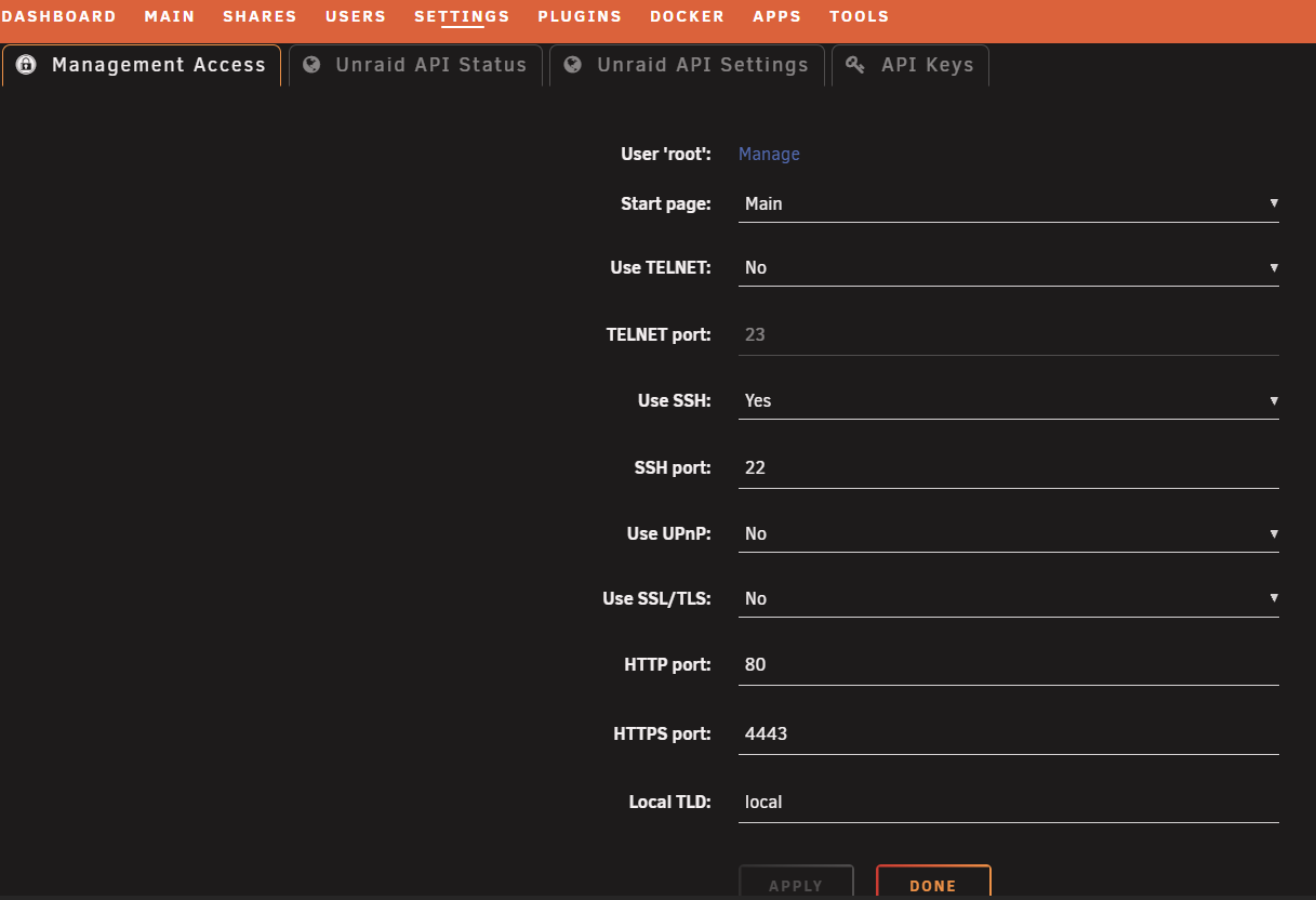

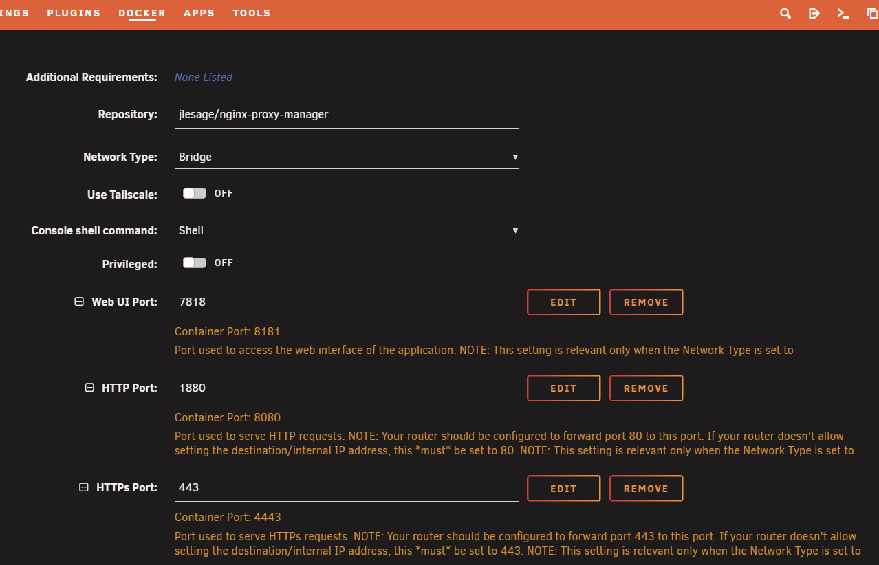

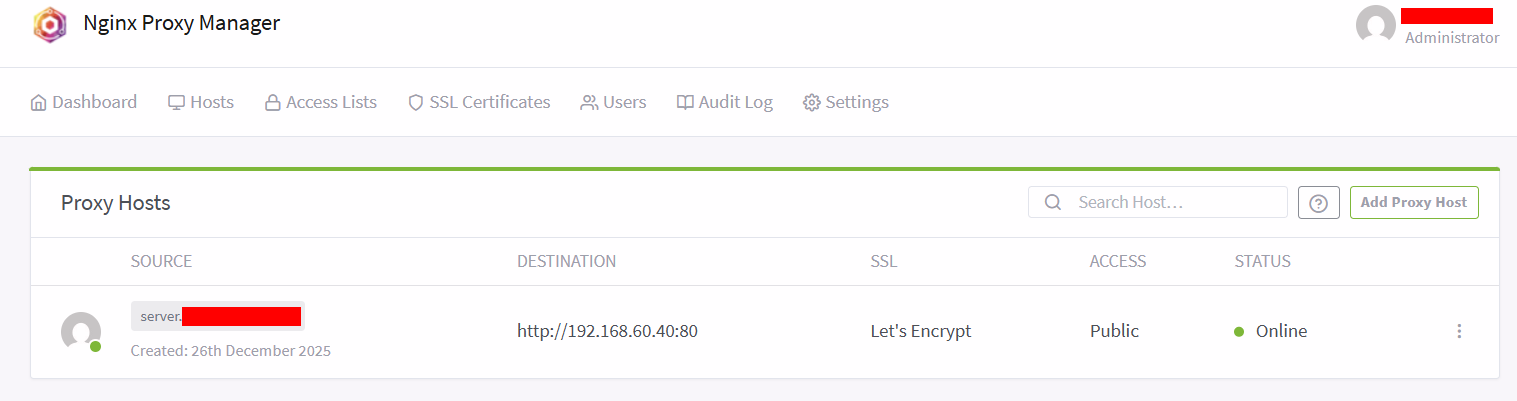

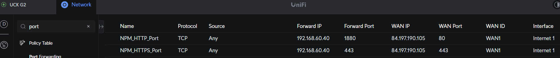

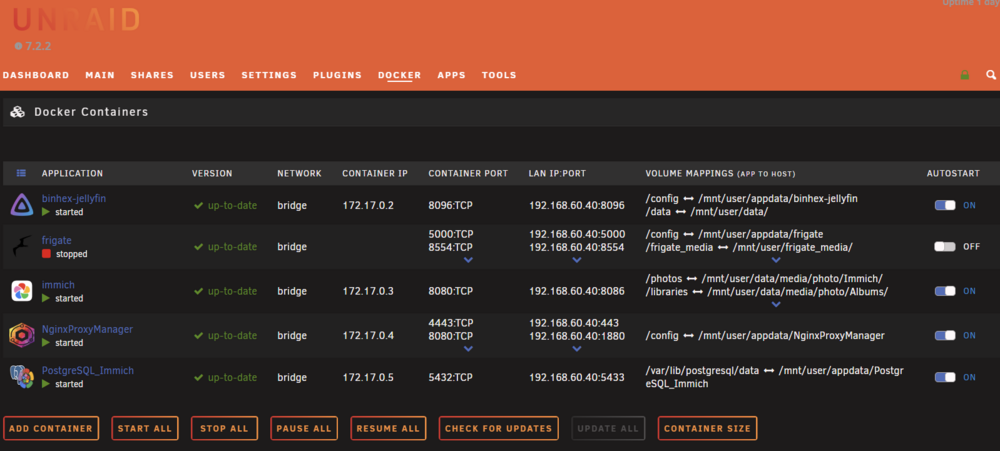

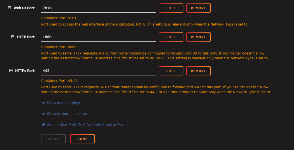

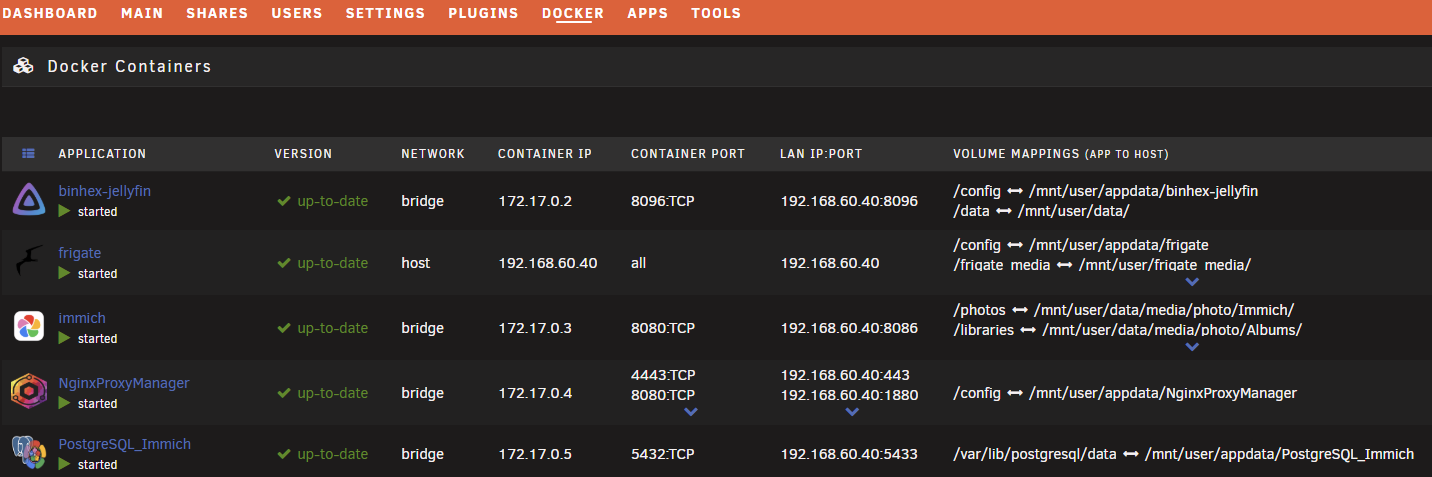

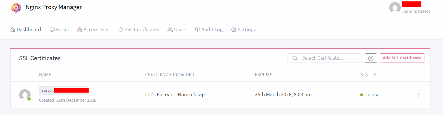

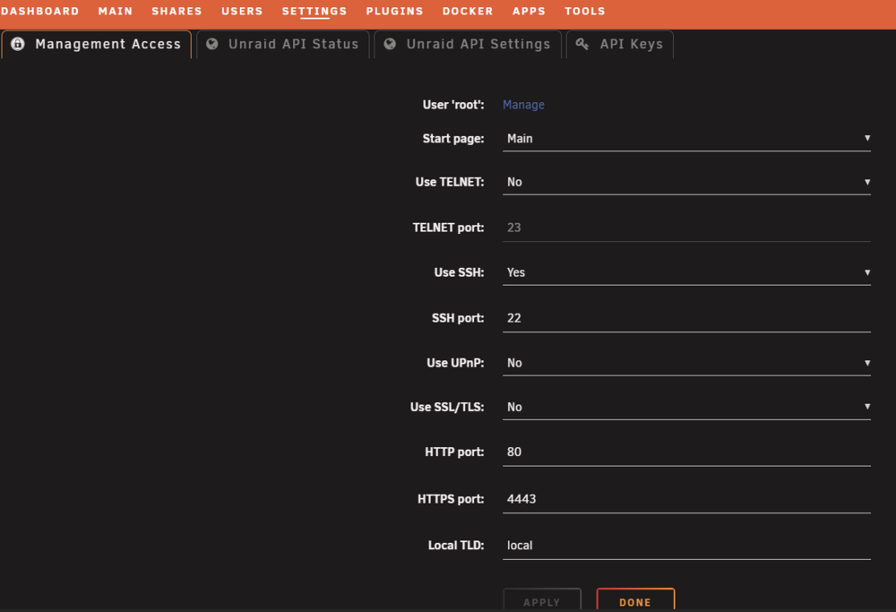

Hi, I have attempted to setup secure remote access over https using tailscale (plugin, not docker app) in combination with NginxProxyManager (docker app) and a custom domain following the guide from spaceinvader one: 3 Different Ways to Connect to Unraid over HTTPS . It is working in the sense that i can reach my server over the internet (hence when not connected to my home LAN); of course with tailscale installed on the device that i use to make the connection. However, the connection remains being shown as 'not secure' and i'm not sure what i did wrong. Below some screenshots of my configuration: Containers: NPM container settings: Management access settings: Nginx Proxy Manager settings: Unifi USG PRO 4 port forwarding rules:

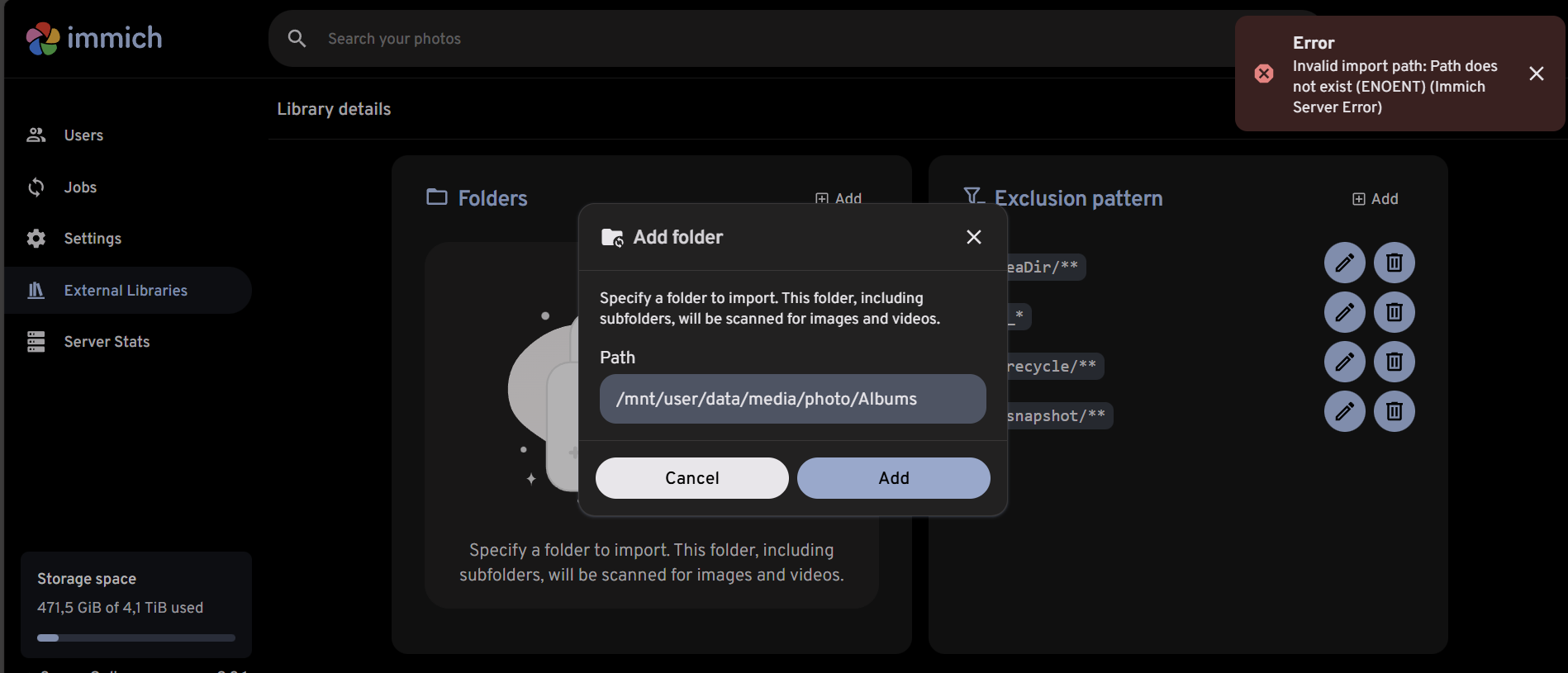

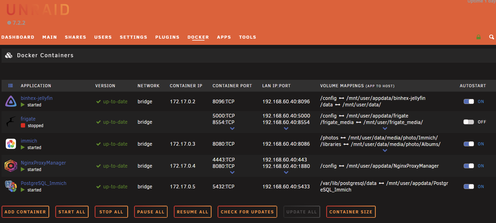

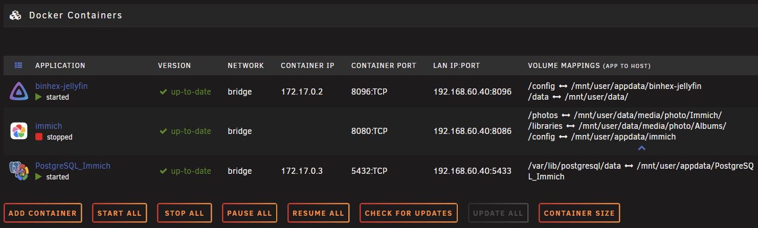

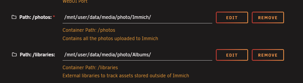

I just found out that for the external libraries i just need to write /libraries as the path. the /libraries corresponds to the oath i have defined during the container setup, i.e. /mnt/user/data/media/photo/Albums For the uploads from the Immich smartphone app i found out that seperate folders for myself and my wife are automatically created in the /mnt/user/data/media/photo/Immich/ directory that i defined during contianer setup, the naming and structure is however not very convenient and hence difficult to navigate. i'll have to dig some more to find out how i can get this sorted out, but at least everything is up and running now

hello, I need support with setting up Immich, specifically with 1) configuring external libraries and 2) having seperate folders per user for photos uploaded from a phone. i have installed the Immich Community App (cuda version as i have an nvidia GPU) and the postgreSQL from spaceinvader My data share is organised per Unraid/Jellyfin Trash folder structure, i.e. a single data share with nested folders for organization; i have a photo folder in the following directory /mnt/user/data/media/photo/ where i would like to have both my organised photo albums as the the photos backed up via the immach apps on the phones of my wife and myself. I am unable to get this configured and working... Overview of what i want to achieve: have my album photos (i.e. photos sorted in different folders) imported in Immich as an external library. i keep my album photos in /mnt/user/data/media/photo/Albums have the photos uploaded (i.e. backuped) by the immich phone app in a dedicated folder for each family member. (for now that would be a folder for me and another folder for my wife) i would like to have two folders in the immich folder, one for my wifes phone photo backup uploads, and one for mine: /mnt/user/data/media/photo/Immich/MYNAME /mnt/user/data/media/photo/Immich/MYWIFESNAME and what should i put here as external library path? when i put the directory of the albums folder i receive an error: all help is appreciated.
