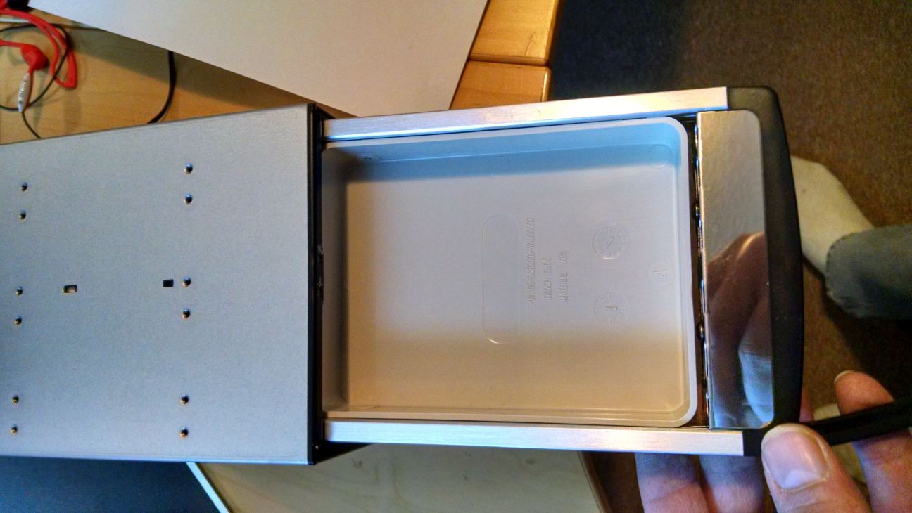

  14. Just got a new cage to add to the farm, so of course, here is the review. IcyDock ToughArmor - MB996SP-6SB Full Metal 6 Bay 2.5" SATA HDD & SSD Cage Initial Thoughts: - Really good packaging - Very well built, solid feeling cage, all metal - All metal drive cages, again very solid - Drive blank filler included on each tray - Clearly labeled bags with sperated screws - Well labeled read indicating SATA ports and corresponding drive bays - Included two SATA to Molex power converters - Basic instruction manual - Very nice release mechanism on trays. - 40mm fan with a Hi, Low and off setting Inside: - Obviously very tight, not much room for airflow, but can see where holes have been cut to allow for it Installation: - Very easy to slid in and scre to case - Mounting holes lines up perfectly - Enough space that connecting all six SATA and two power cables wasn't an issue - Some issues with tolerances on the screws. Some drives mounted to the cages still had some movement. LED: - Front green power LED and orangish activity LED Overall thoughts. Initially looking at this unit I was impressed. Top quality and VERY solid. The drive cages as well were very solid and a nice blanking panel on the end of each one in case you don't install a drive in one or more, won't waste air flow. Really like the inclusion of the SATA to Molex power connectors. Nice touch. The unit is very well labeled to map out which connectors on the rear correspond to which trays on the front. Now, the down side. I am not sure if it was the tolerances on the length of the included screws or the threading ont he drives themselves, but a few of them were a little loose on the tray, even when I had the screws in as tight as I felt was safe. Now, dealing with 7 and 9.5 mm drives doesn't leave much room for error, so not sure who to blame on the one. Once plugged in though, everything was solid. I was worried about that 40mm fan being a little turbine. But upon powering up the unit and set at high, I could hardly hear over the other case fans and 3x5 cage fans I have in the case. Was impressed. I set mine to medium. With some basic monitoring on the drives, temps are normal, but have not run any parity checks to really stress them. Not withstand the screw issue, I am duly inpressed by this unit. The ability to fit 6 drives into a single 5.25" slot is nice and the layout in the rear makes for nice management. That with a overall rock solid build and a decent fan leaves me with a great impression of the unit. With the availability of 2TB 9.5mm drives, you could really cram a lot of storage in one of these in that mITX build. Along with a perfect housing for SSD drives. Images (link to full gallery )
  15. Just working on the newly arrived SM unit and a pleasant surprise. The drive trays all come with pre-installed filler panels, so those trays without a drive installed won't have air pulled through them, aka, dust. Very nice addition.
