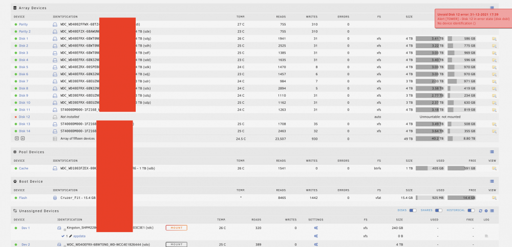

  2. Ahh OK yes I just bought it off eBay so its probably shucked. I have a new one coming next week I'll replace it with that. How can I get the array back up and running in the mean time? Do I need to add the failing disk back just to assign it and then un assign it? Thanks and happy new year I did the process with the failed disk and it has come back online fine. I have a new disk coming so I will replace the failed one with that and use the shucked one as a new drive in my backup Unraid. Thank you so much for the help as usual.
  3. I triple checked all the assignments are correct. It's throwing disk errors on 3 disks now too. thank you tower-diagnostics-20211231-1142.zip

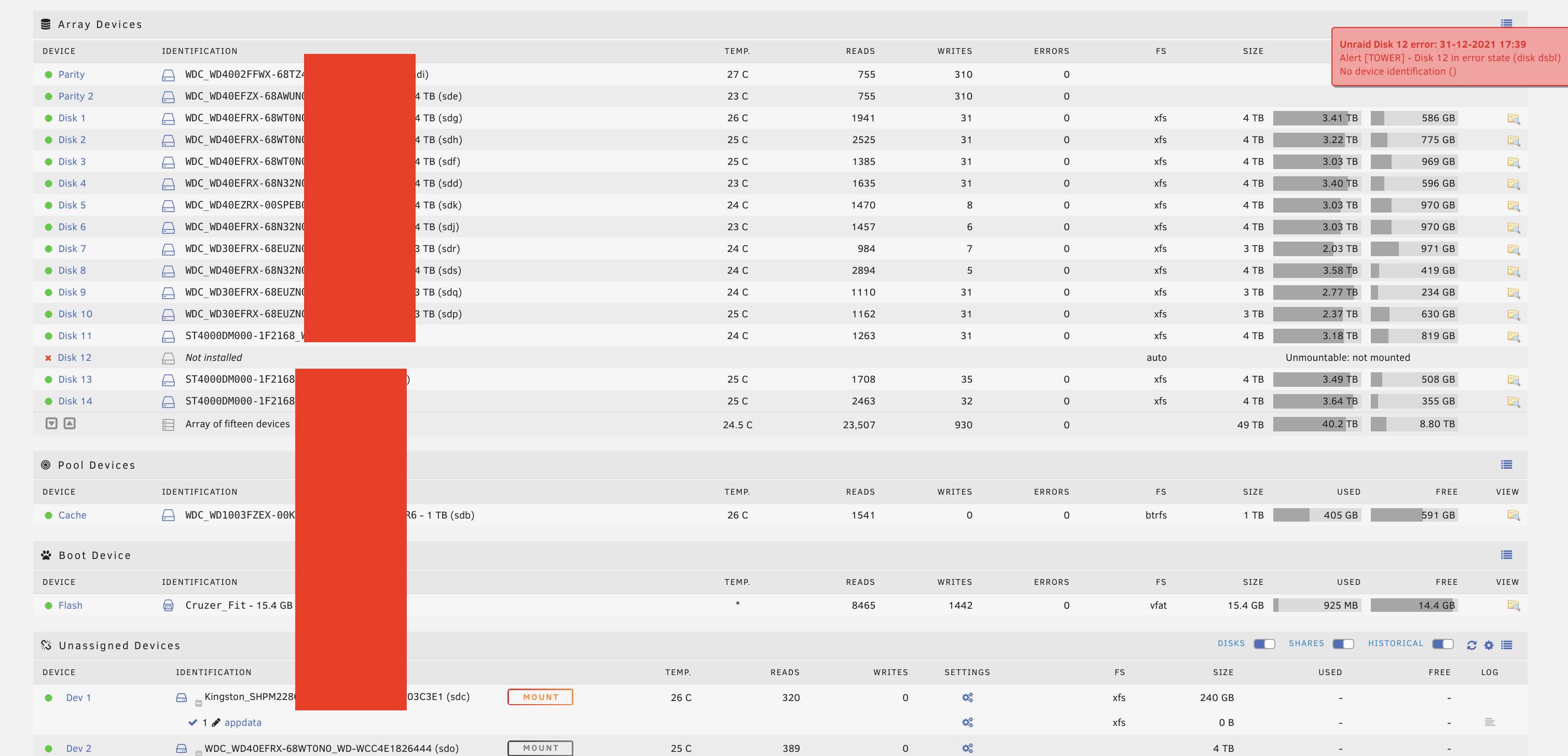

  4. Hi again I have just had the same happen again, had to wait for a disk to arrive, wrote contents to the emulated disks. Since the original issue I have added a second parity. I rebooted, lost the disk assignments, assigned all disks back, including the new disk to the missing slot, stated in "maintenance mode" with "parity is valid", stopped the array, unassigned the disk and started in normal mode and am getting unmountable error and I am unable to start a disk check in maintenance mode. Does this same fix work with dual parity or is there some other issue? Thanks again for the help. tower-diagnostics-20211230-2349.zip

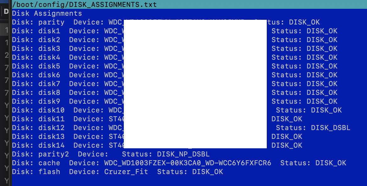

  6. I have just realised it says in the DISK_ASSIGNMENTS.txt that I get User Scripts to create once a week. I believe it was disk 12 that was disabled. Not sure if you can collaborate that with the diags? But I believe it to be accurate as it was a higher number disk I remember being disabled and the user scripts disk list was created 5 days ago. So it looks like I need to get Unraid to believe that disk 12 is disabled again and emulate its contents from parity. I will buy a replacement disk and a second parity right away to stop this from happening again. Thank you for your help. tower-diagnostics-20210918-2212.zip
  7. Yes I know the disk assignments, but I don't recall the disk that was disabled. Ive looked through as all the logs I could find and cant find any sign of which one it was. It is single parity. Thanks Jorge!
