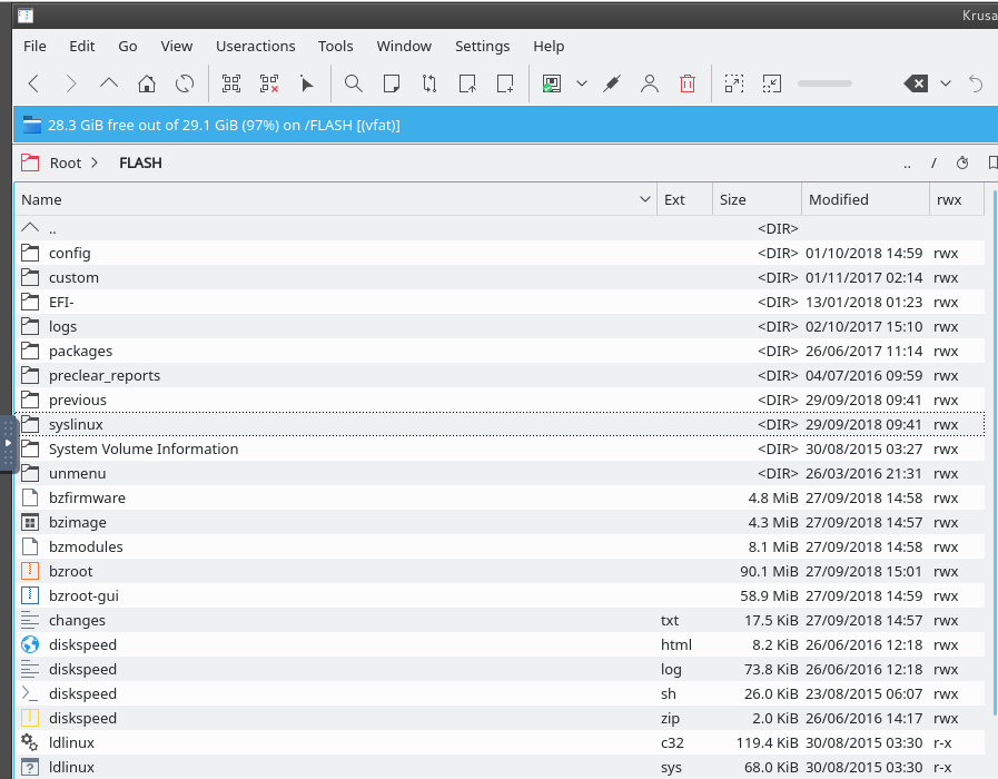

Hi, I started using pulseway on my daily PC and thought I would try and set it up on unraid.
I do however have a question or two if anyone could help.
Following the instruction it says "Copy the pulseway_x64.txz to /boot/extra (this is also the flash smb share so flash/extra)"
As seen by the attached image of my FLASH I dont have an extra folder. I assume I will need to create a "extra" folder?
According to this page: https://wiki.unraid.net/Files_on_v6_boot_drive, the extras folder is optional
It looks like you'll just need to create the extras folder.
