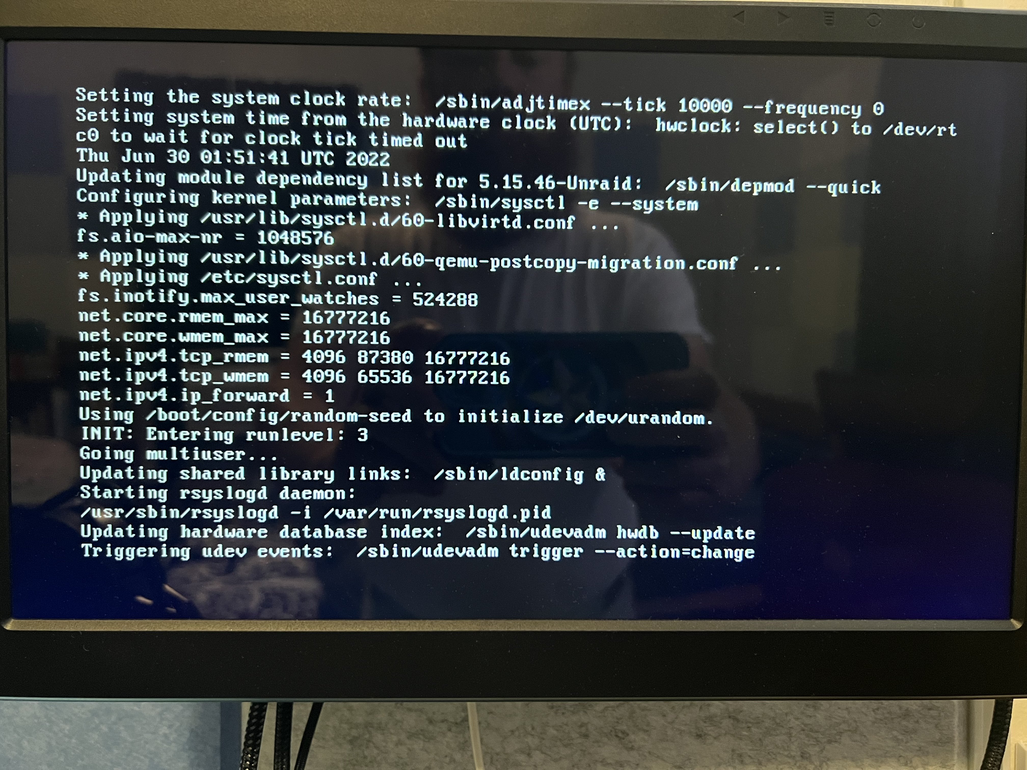

  7. Ok, so the Adaptec AEC-82885T arrived today. I have it installed in the external enclosure and all wired up. I first powered it up without any drives attached to the expander and it seemed fine. The boot process shows the device, no drives attached, system boots properly, lsscsi shows the device present. [6:3:0:0] enclosu ADAPTEC AEC-82885T B025 - I then put one drive in each of the three bay assemblies, made sure that all three were detected by the boot process, then let the system fully boot. The monitor attached to the system shows it came all the way up, prompting for login. I can ssh into the system, but it took a good 15 minutes further before the web interface would come up. It may be a WD Green drive I put in that's causing issues. I previously marked the drive as bad with a big red B on it's label, but the drive does at least get detected by Windows so I was giving it a chance. Seems UnRaid is part of an array. I'll try to wipe it, but that drive will most likely become a rifle target. I've yet to test hot add, but hoping that works. I'll do some pre-clear tasks and see how it goes. Wiring is still a mess, but I have an eventual plan for that. root@Dragon:/boot/config# lsscsi [0:0:0:0] disk SanDisk Cruzer Fit 1.00 /dev/sda [1:1:0:0] disk ATA ST16000NM001G-2K SN03 /dev/sdb [1:1:1:0] disk ATA ST8000NM0055-1RM SN05 /dev/sdc [1:1:2:0] disk ATA ST8000VN0022-2EL SC61 /dev/sdd [1:1:3:0] disk ATA ST8000VN0022-2EL SC61 /dev/sde [1:1:4:0] disk ATA ST8000VN0022-2EL SC61 /dev/sdf [1:1:5:0] disk ATA ST8000VN0022-2EL SC61 /dev/sdg [1:1:6:0] disk ATA ST8000VN0022-2EL SC61 /dev/sdh [1:1:7:0] disk ATA ST8000VN004-2M21 SC60 /dev/sdi [1:1:8:0] disk ATA ST8000VN0022-2EL SC61 /dev/sdj [1:1:9:0] disk ATA ST16000NM001G-2K SN03 /dev/sdk [6:1:16:0] disk ATA ST4000VN008-2DR1 SC60 /dev/sdl [6:1:20:0] disk ATA WDC WD20EARS-00M 51.0 /dev/sdm [6:1:24:0] disk ATA Hitachi HUA72101 GKAO /dev/sdn [6:3:0:0] enclosu ADAPTEC AEC-82885T B025 - [N:0:5:1] disk Samsung SSD 980 1TB__1 /dev/nvme0n1 [N:1:5:1] disk Samsung SSD 980 1TB__1 /dev/nvme1n1

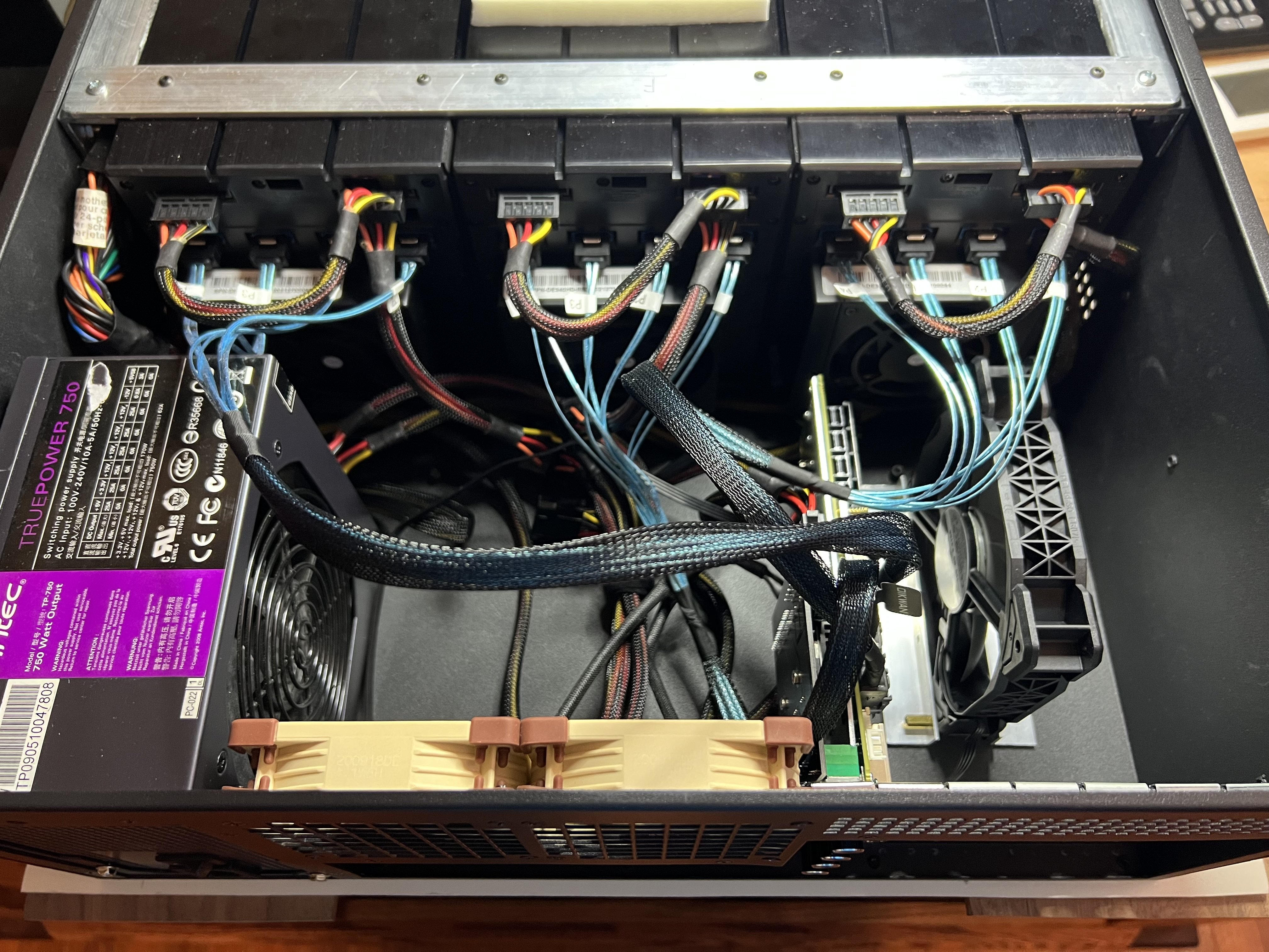

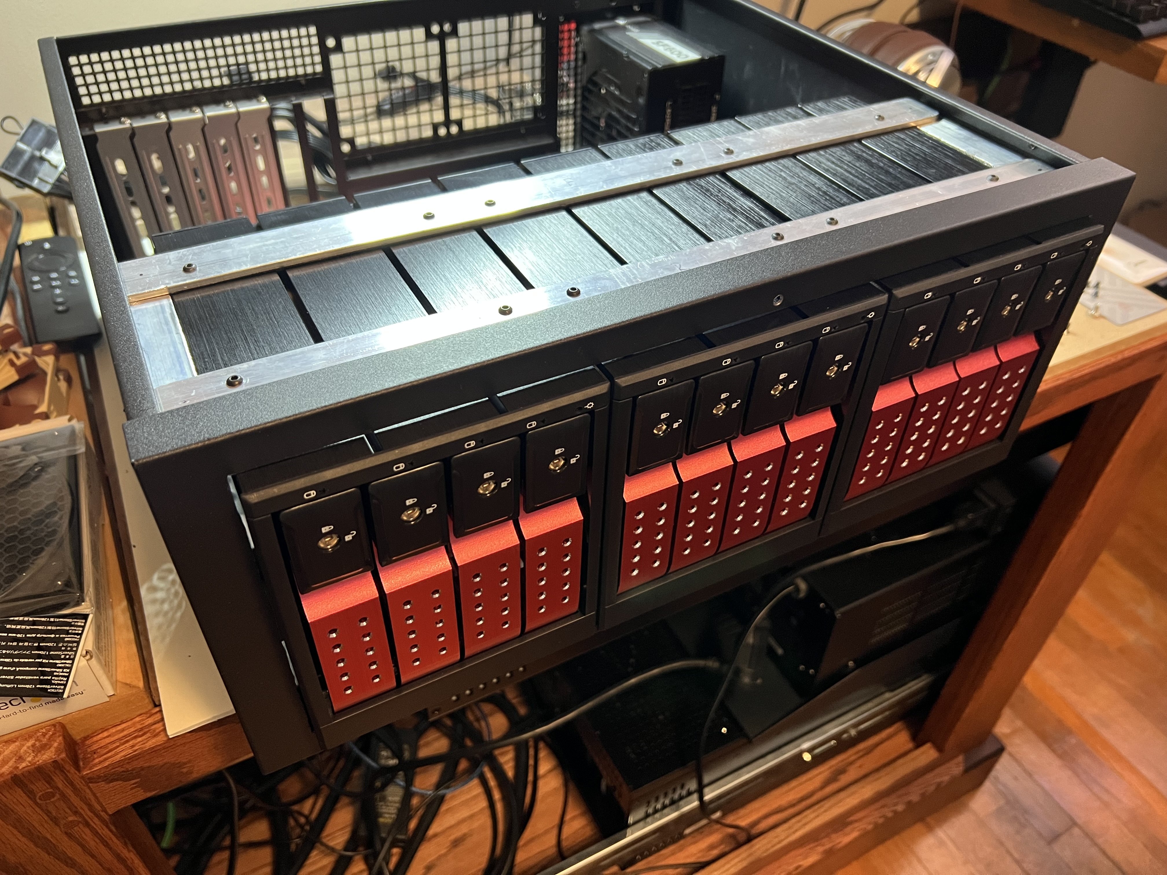

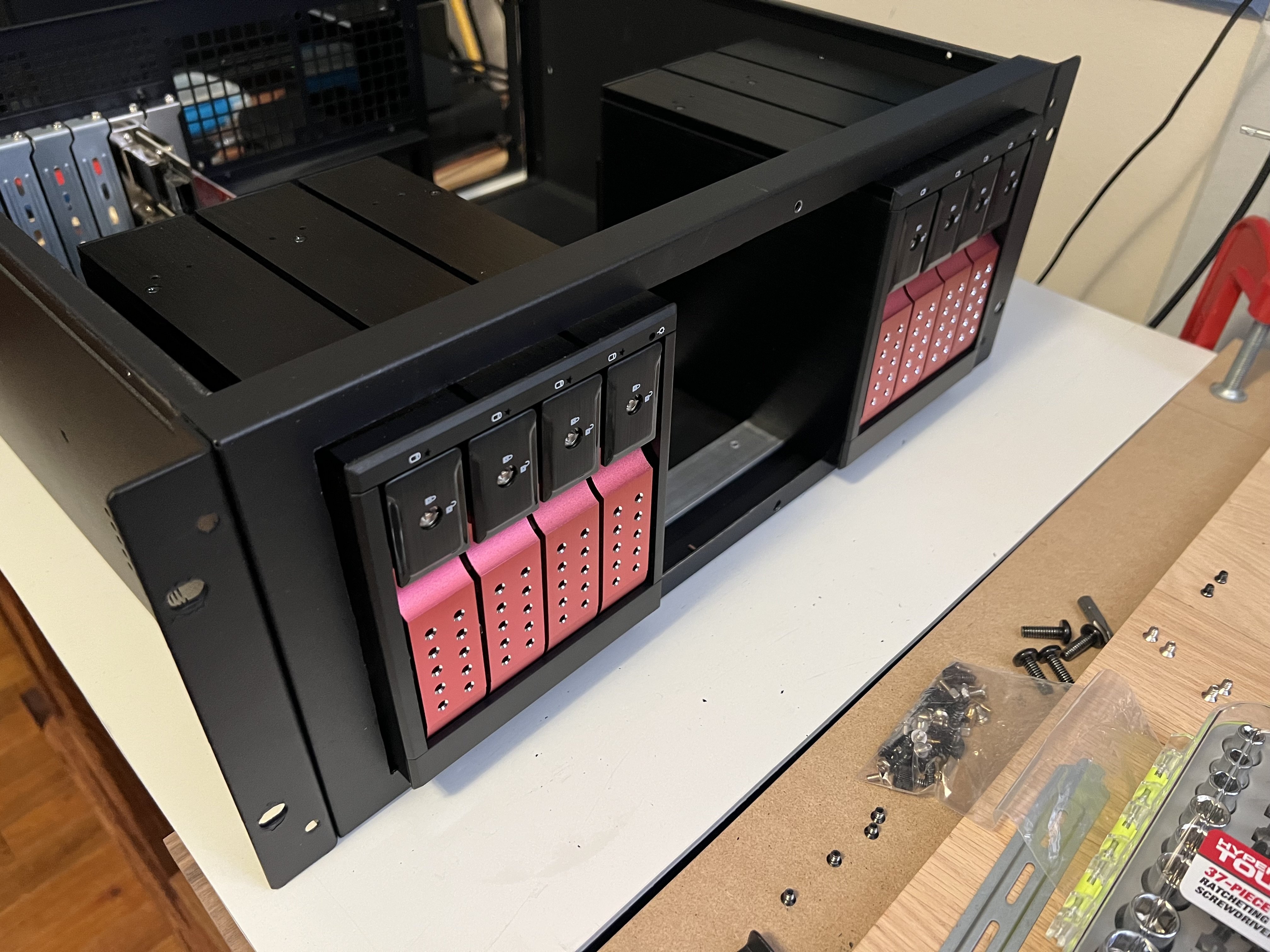

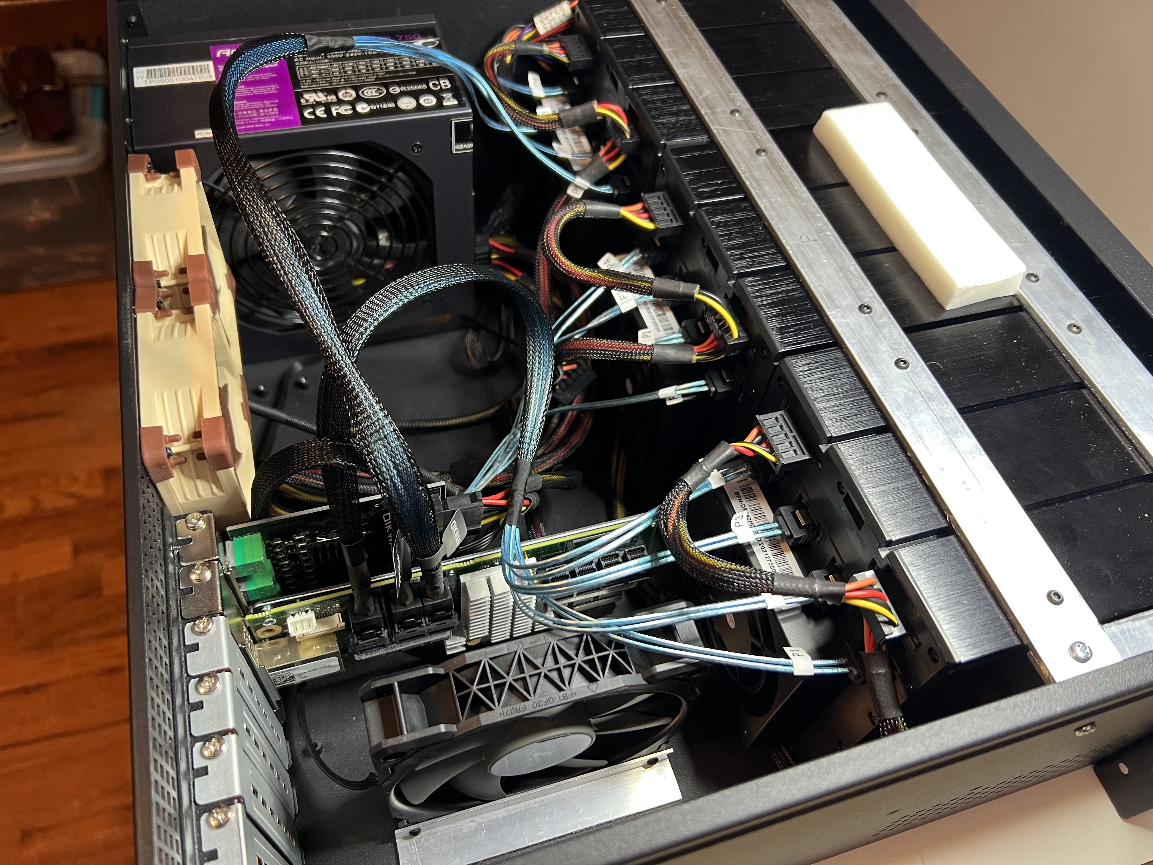

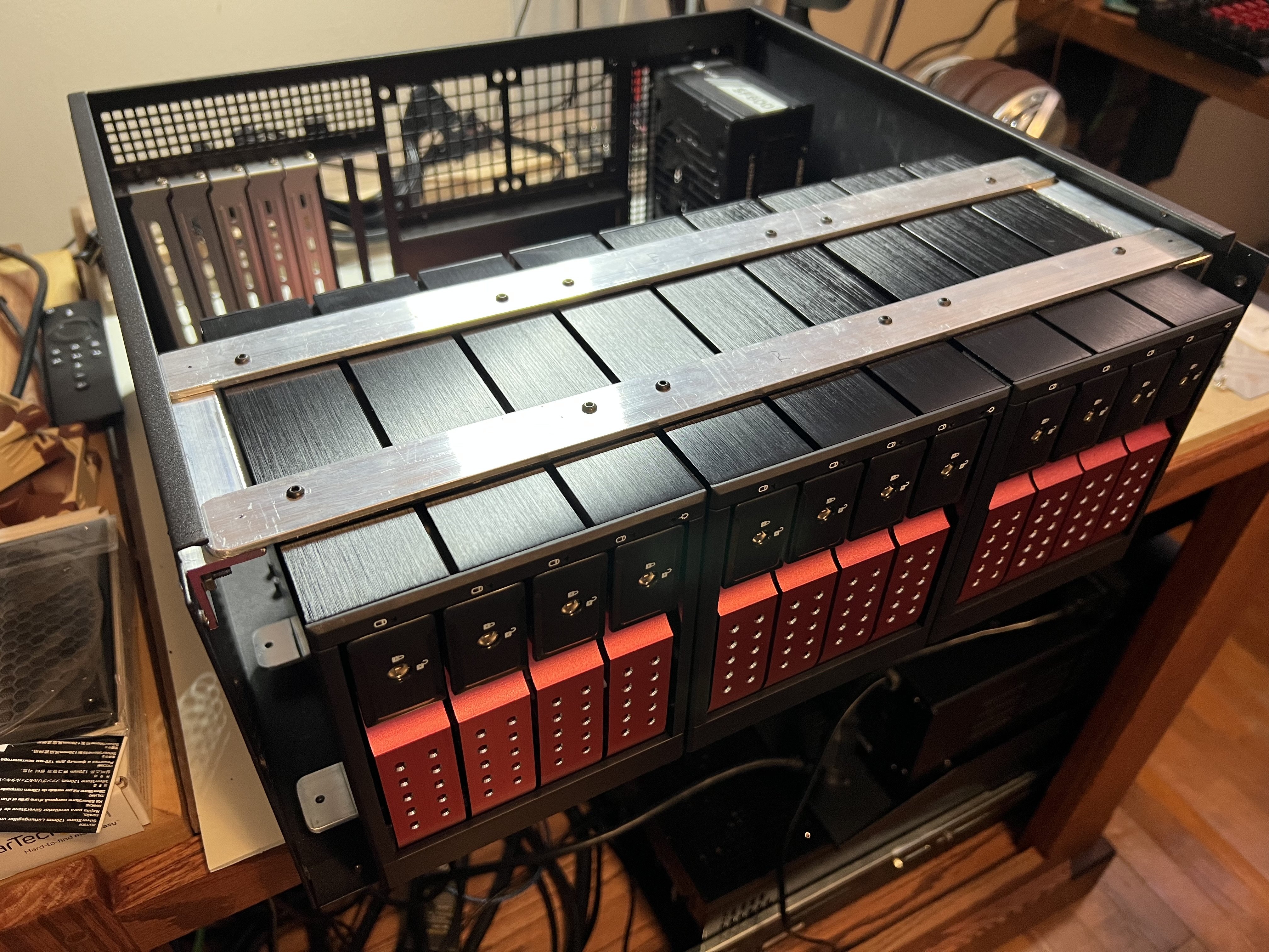

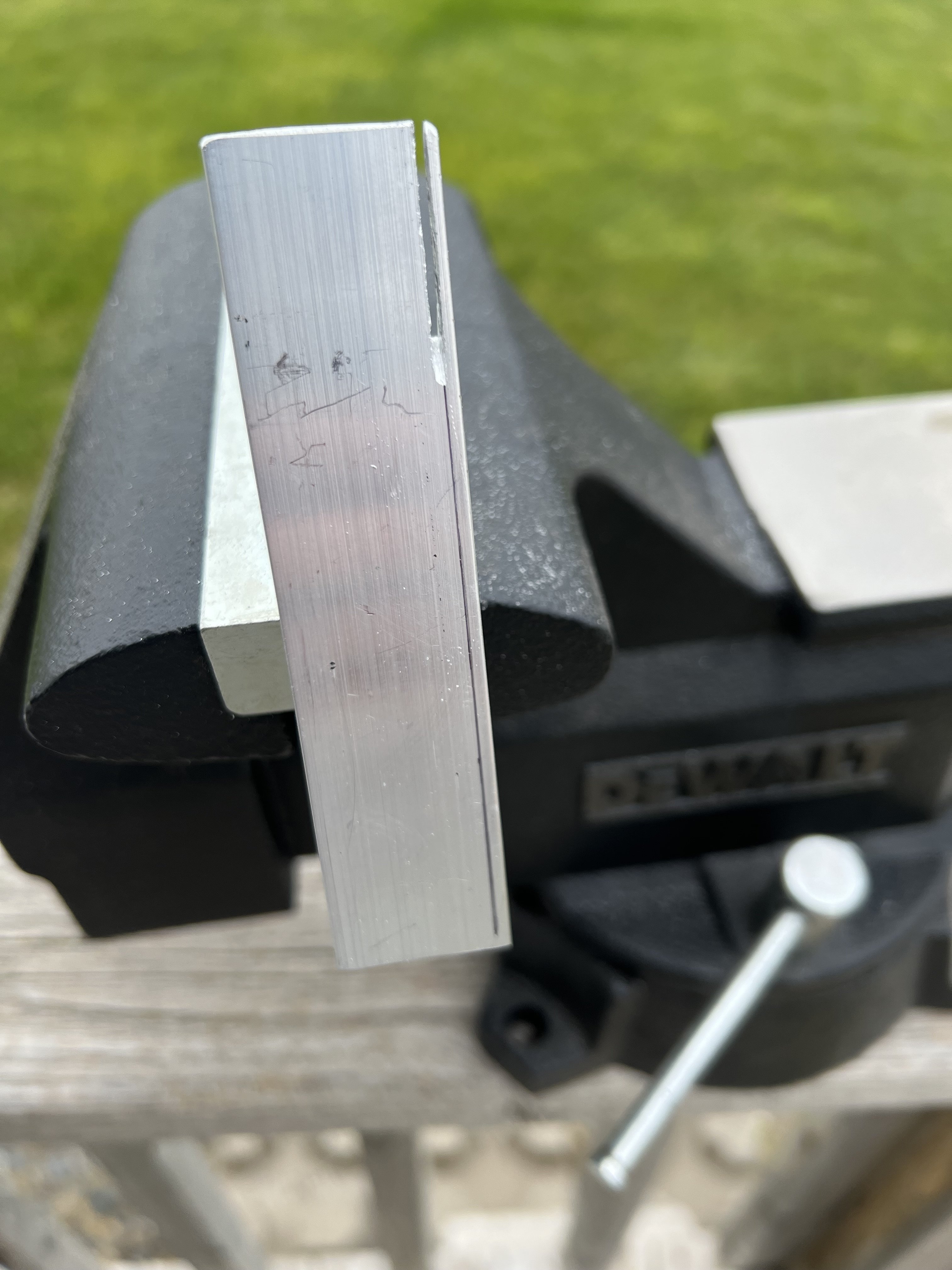

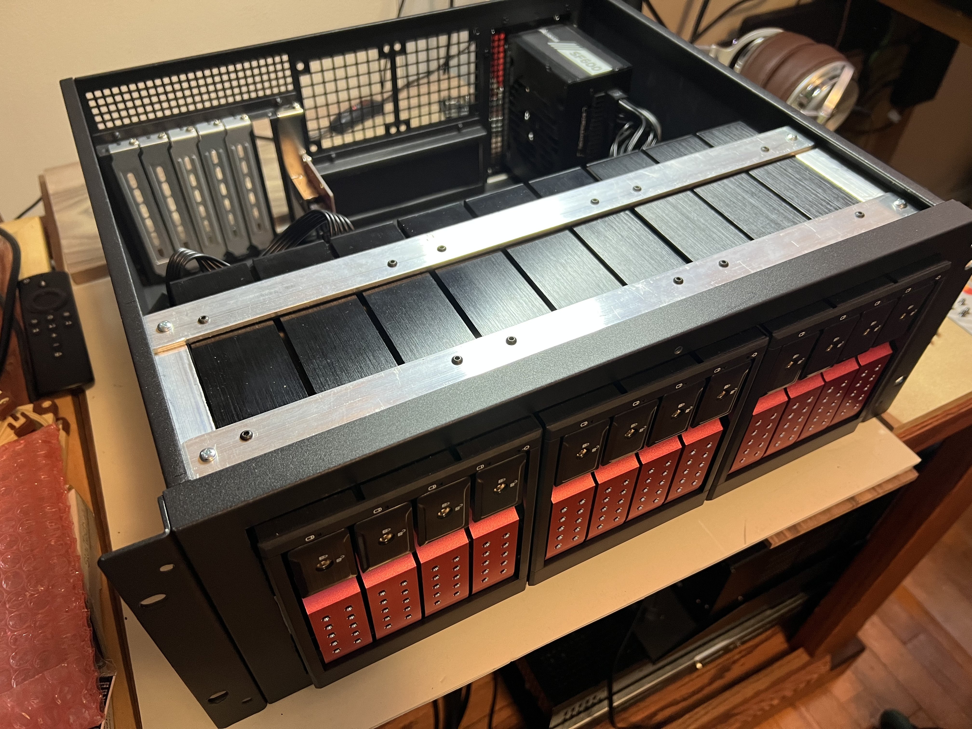

  10. Some progress has been made today. The drive bay modules have been linked together, top and bottom, hanging from the sides of the 4U chassis with aluminum brackets. I started with pieces of angled aluminum that I had to thin down a little on each side to get the drive bay modules to fit. The whole process was a lot of fitting, cutting and drilling until everything lined up properly, but hopefully the rails that link the bays together have been installed for the last time. The lower bracket won't be attached to the bottom of the case, but I may end up installing some rubber or foam blocks to support it. The metal front panel fits as it should and the next big task will be cutting the opening in the wooden front panel to fit around the drive bay modules. A fan for the HBA and the cables necessary to connect the first drive bay module will be here tomorrow. A full height bracket for the HBA I'll be using has been ordered, but shipped from China, so it will be here some time next month. I need to order a power supply and eventually a SAS expander and the rest of the cables.

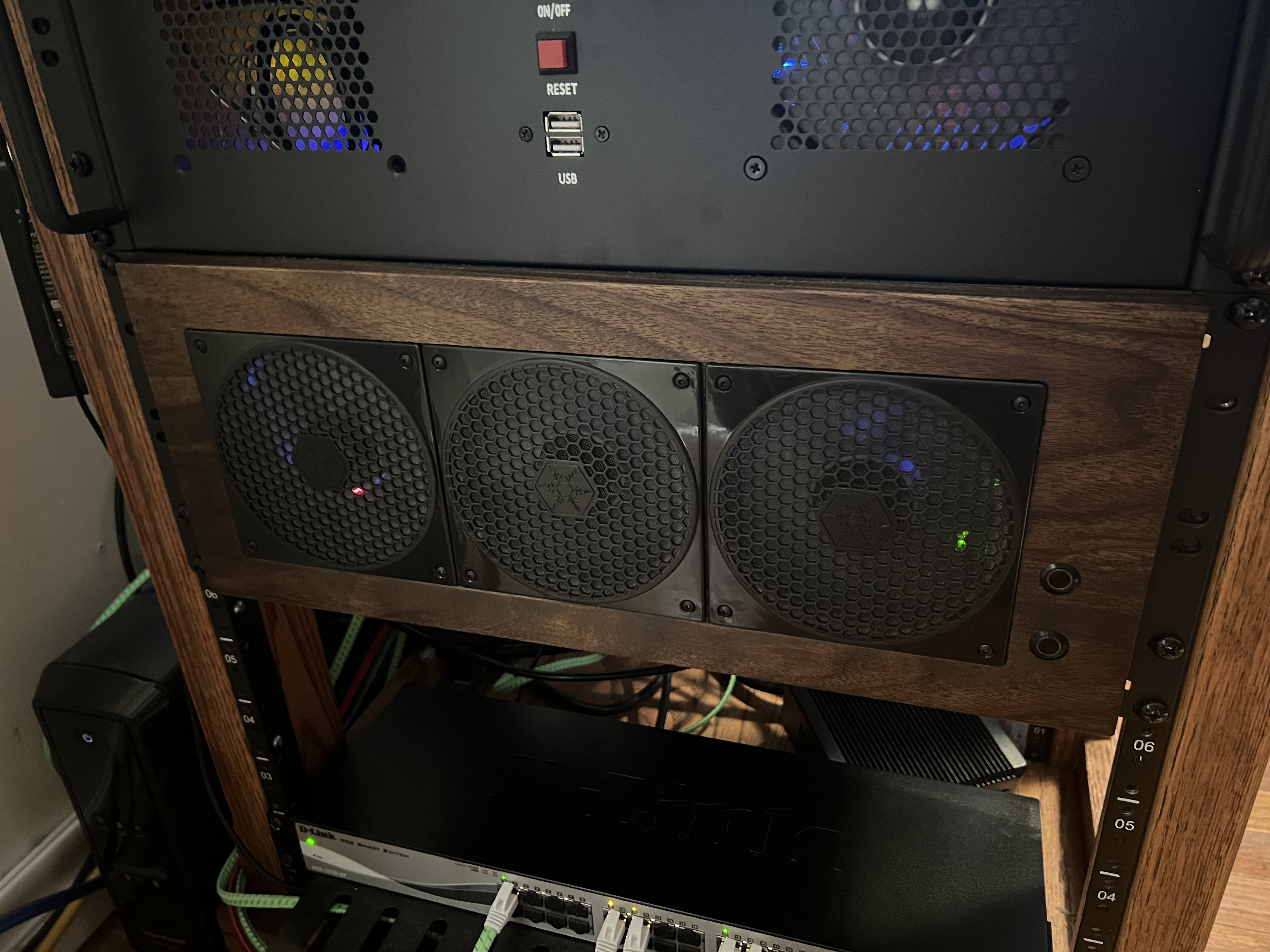

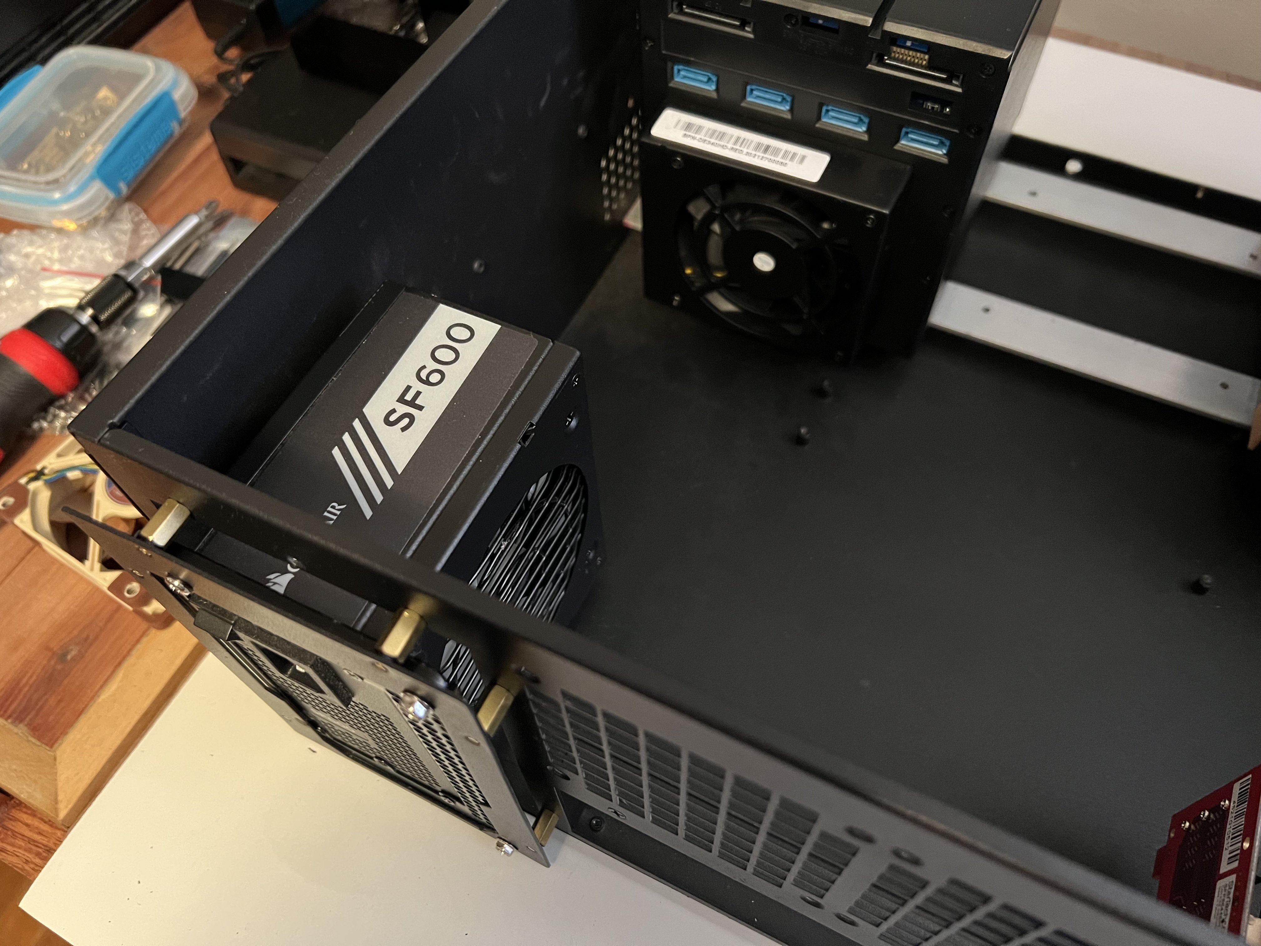

  12. Some progress has been made today. Yesterday, not so much. I mowed the back yard and cleaned up brush. Something that I disturbed made me sick and I slept almost all of Saturday. I got outside today and trimmed the steel front panel of the computer case to allow the drive bays to fit through. The lines aren't perfect, but the panel is going to be covered, so not such a big deal. I'll be drilling some holes, used to secure the wooden front panel and once those holes are drilled and deburred, I'll paint the front panel to prevent rust. The third drive bay module will be here tomorrow and I have some m3 screws arriving on Tuesday. I've decided that for the short term, I'm going to use the Corsair SF600 to run power to a single drive bay module. I only have one hard drive to put in it anyway, so I shouldn't be stressing it at all. Later, I'll end up ordering an HX750. The length of the larger power supply is 7.09" and if installed normally, puts it really close to the back of the right-most drive bay assembly, so I removed the bracket to which the power supply is attached and put it on the outside of the case. I'll probably order some 20mm spacers to move the bracket back to allow enough space to comfortably work with cables. I'll cut a piece of acrylic and attach it to the opening where the motherboard shield normally resides. For my UnRaid server, I'm going to order an Adaptec ASA-70165H that provides four external ports and will test connectivity, file copy and file integrity with a 0.5mm cable between the two chassis and a 0.5mm cable running from an adapter board to the drive bay assembly. Later, I might order an Adaptec AEC-82885T SAS expander to take the place of the adapter board, but only if I have to. If the end configuration is the adapter cards, then I'll have three cables linking the two chassis together and if using the SAS expander, two cables, most likely. I'll cut my piece of black walnut to external size tomorrow and start sanding it down, then take measurements for the large opening needed for the three drive bay assemblies. There won't be a lot of walnut. It will be pretty thin top and bottom, and about an inch on either end. The wood gets stained pretty dark, then treated with an orange oil and beeswax finish. To the front of the computer chassis, I apply a 1/16" thick piece of adhesive backed foam, then screws are installed, attaching the wood to the case from the inside of the case so that no screws are ever visible. I still need to buy a piece of aluminum to tie the three drive bay assemblies together on the top. Four holes will be drilled in the bottom of the case for m3 screws to be installed into the spacers from the bottom, then two holes in each side for brackets that will attach to the aluminum bars I'll be using to tie the modules together. I'll probably place some blocks of 1/2" thick adhesive backed foam to the aluminum bars on the bottom, and on the top to help prevent sagging of the modules themselves, and of the top panel. The top panel normally has a little metal bracket that it slides into, but that bracket had to be pretty much cut away.

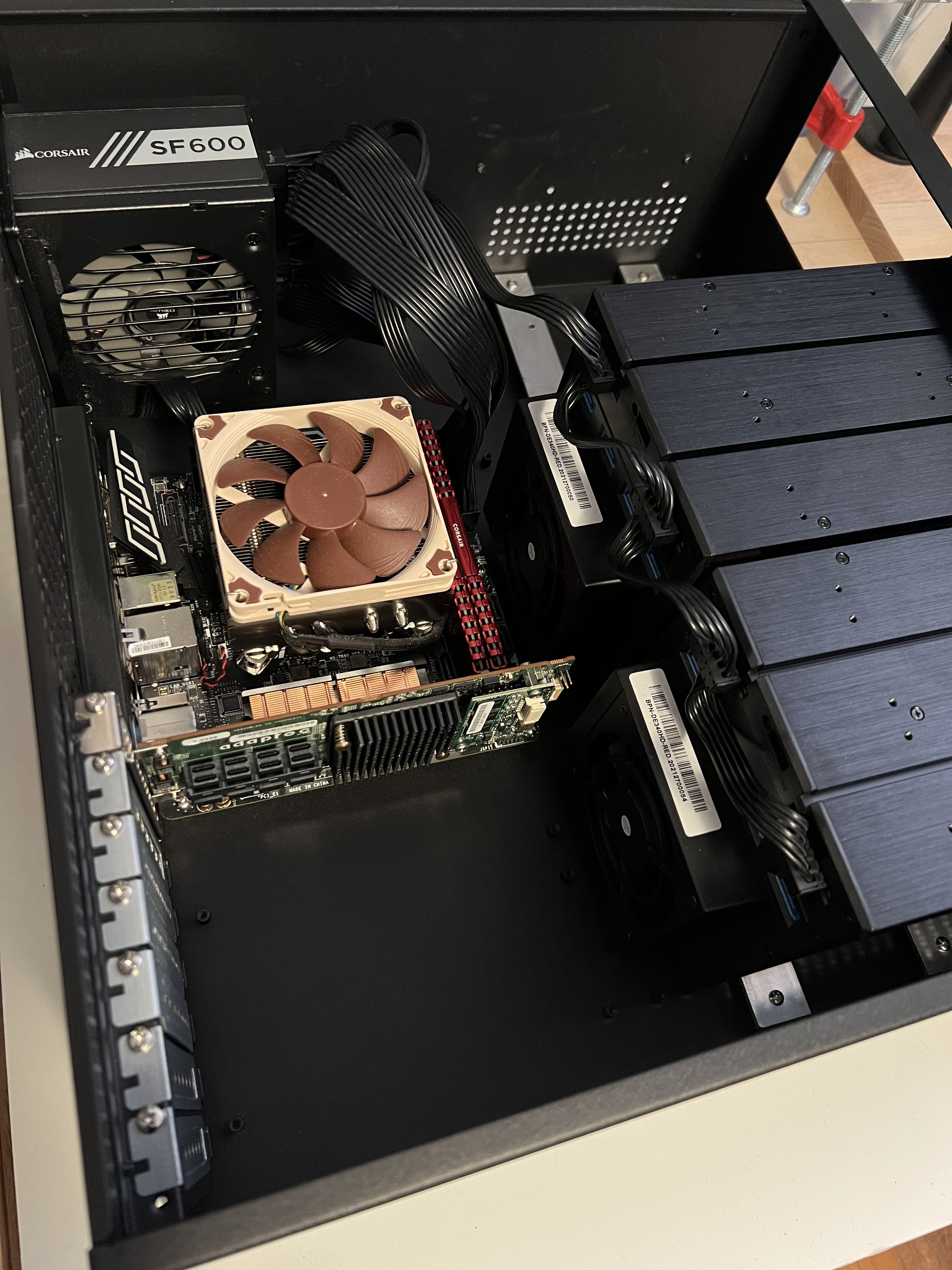

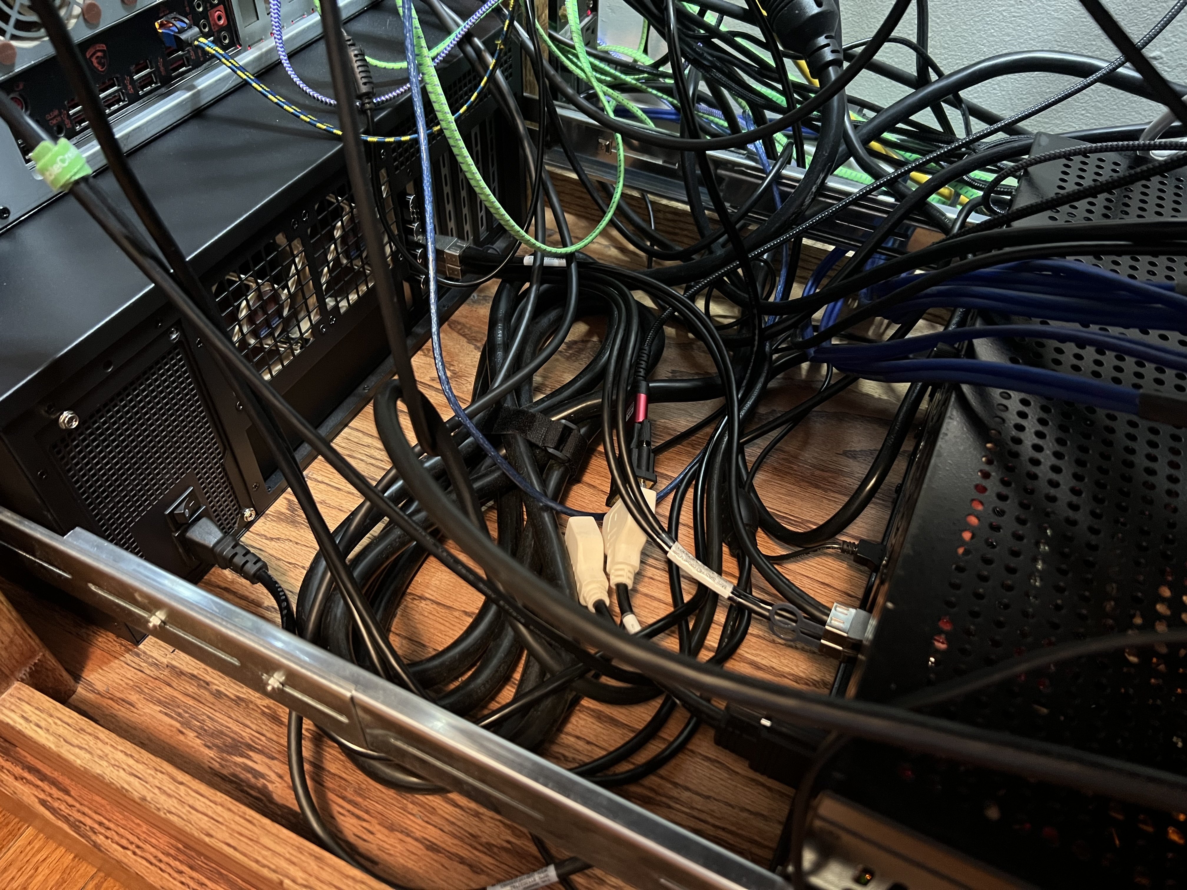

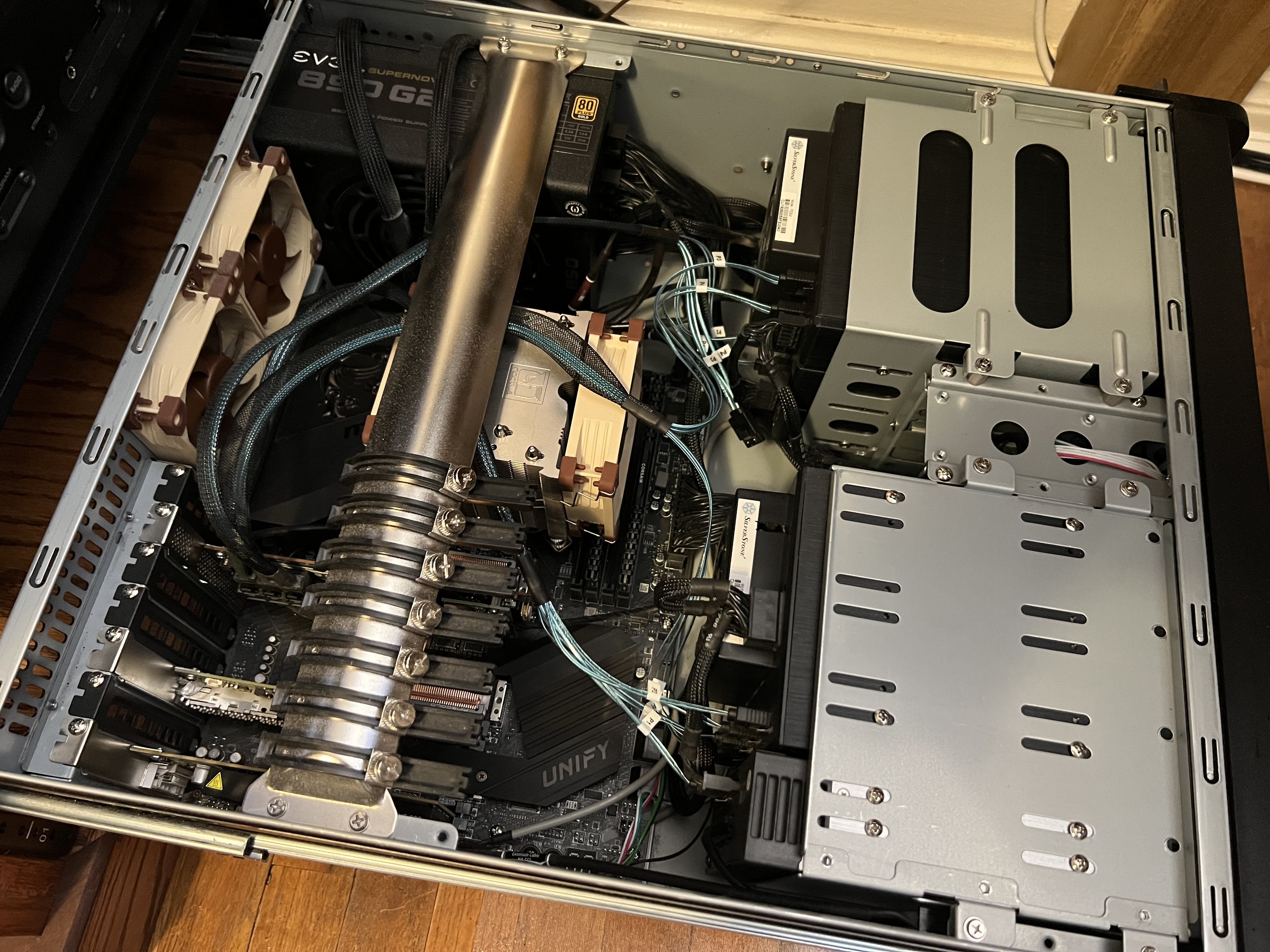

  13. I opened up my backup UnRaid server to do some cleaning and see what options I have for adding external connectivity. I have a Mellanox ConnectX-3 40Gbps card in an slot that supports x8 connectivity, and an x1 Nvidia NVS300 graphics card in a slot that supports x4 connectivity. An x1 slot next to it was left empty for future access to a third NVMe controller. Being a backup server, it's unlikely that I'm ever going to use that slot, so I moved the video card to that x1 slot, then moved the Mellanox card to the last slot, x4. The card is an x8 with a single port, but seems to work just fine when connected to the x4 slot. This frees up an x8 slot, where I could put an Adaptec ASA-70165H, external connectivity, eliminating any extra cabling inside the UnRaid server. The back of this UnRaid server and the back of the external enclosure I'm working on, are close enough together that an 0.5m cable would connect just fine, if I decide to go that route. Next, I did a mockup of the two drive bays I have so far, in place with a Mini ITX motherboard an an Adaptec ASR-71605. The drive bays are linked together with two pieces of 3mm aluminum that I machined for them. These pieces of aluminum are raised off the bottom of the case with 10mm long brass spacers. I'll cut similar aluminum bars to tie the bays together across the top. Everything fits, but also keep in mind that once the front panel is trimmed, the drive bay assembly will be moved forward a little more than 1/2". If I buy a SAS expander such as the Adaptec 2283400-R, I can connect from it to the drive bays with 0.5m cables, staying within the 1m limit for SATA. My larger concern is the power supply. Even though it is a 600w psu, there are only two connectors for powering drives. How many drives should I realistically try to power from a single port. Is eight drives from one cable a fire hazard? I don't think I want to do that. Should I get a slightly more robust power supply that has more connectors for drives? I also want to add a 120mm fan to blow air across the card, whether I'm using the HBA or expander. For my UnRaid servers, I removed the heatsinks for the cards, drilled and tapped the heatsinks for 40mm fans, applied new thermal paste and reattached them with the original clips, but a fan bracket is probably a little easier. Somewhere, I have a four port fan controller that attaches to a expansion slot bracket, so I could have the two rear 80mm fans and the 120mm fan set up that way and adjust the fans according to noise level. For a more DIY approach, I have a fan speed controller that could be set up to run according to temperature.

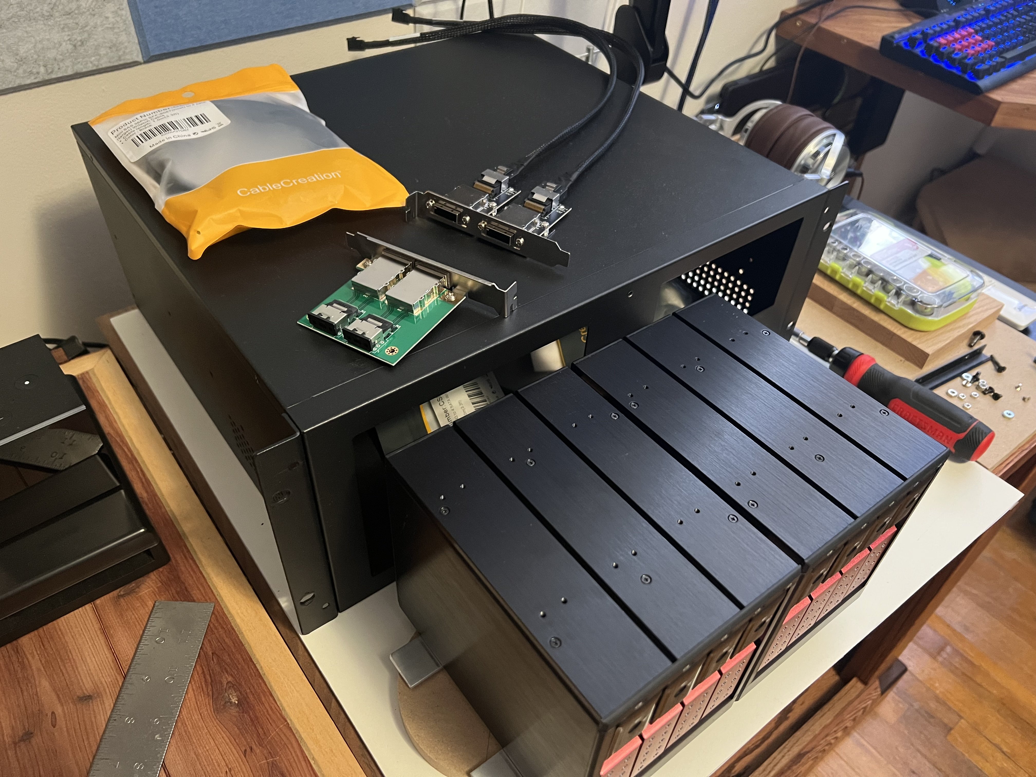

  15. If I need to use them, I do have two dual-port 8088/8087 adapter cards and the cables for each end. I just don't have the cables to go between yet. The Adaptec card I'm using is rated for 6Gbps, so these would probably be fine for SATA drives. If nothing else, I can use them for speed comparison, and if I end up using these cards for part of the drives, it saves me some money. The computer case I selected has the front panel attached entirely with screws, not with rivets as sometimes happens. When I have the support structure for the three drive bays (still waiting on the third one to arrive), I can remove the front panel of the case, install the structure and reattach the front panel. The drive bays will extend 1/2" through the steel front panel as to be flush with the wooden front. If anyone is wondering how a black walnut computer case front would look, see the second image below. This one is a CentOS router that I set up to provide gigabit uplink to my main router and 40Gbps connectivity to my two UnRaid servers and two Windows 11 desktops. Practical throughput is nowhere near that, but the direct-attach-copper links are solid. All wifi devices and anything in the house that consumes media is connected to my main router and firewall segregated from my Windows instances and anything running on UnRaid, with specific ports opened for things like AdGuard and Emby. LG and manufacturers of IoT devices are not to be trusted.
