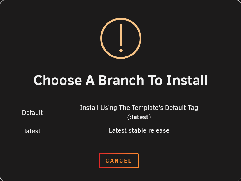

  11. All of a sudden, I am unable to select which branch to install when apps ask what branch I would like to install. I have tried Firefox, Chrome, and Edge—the same issue. I have also tried all these browsers in incognito. I have also experienced the same issue on my backup server. For example: Configarr After I press install, the pop-up "Choose A Branch To Install" appears. I am unable to select anything, and my clicks do nothing. I can see the text change when I hover over an option, but it doesn't actually do anything. The cancel button works, though.
  12. Any docker in the CA Apps that asks what branch you would like. For example: Configarr After I press install, the pop-up "Choose A Branch To Install" appears. I am unable to select anything, and my clicks do nothing. I can see the text change when I hover over an option, but it doesn't actually do anything. The cancel button works, though.
  13. All of a sudden, I am unable to select which branch to install when apps ask what branch I would like to install. I have tried Firefox, Chrome, and Edge—the same issue. I have also tried all these browsers in incognito. I have also experienced the same issue on my backup server. Both servers are running 6.12.10 Any idea what is going on?
