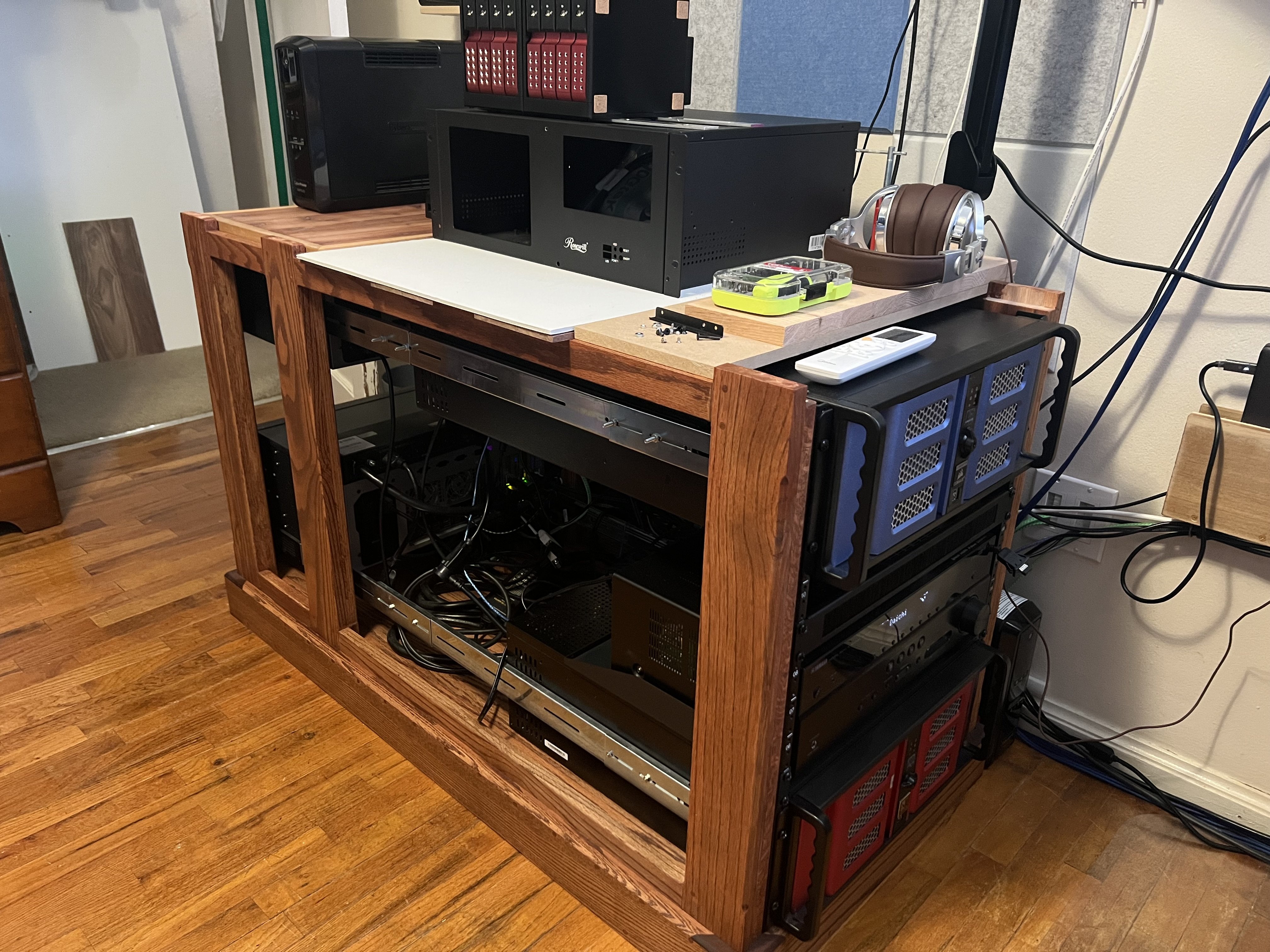

  10. Some progress has been made today. The drive bay modules have been linked together, top and bottom, hanging from the sides of the 4U chassis with aluminum brackets. I started with pieces of angled aluminum that I had to thin down a little on each side to get the drive bay modules to fit. The whole process was a lot of fitting, cutting and drilling until everything lined up properly, but hopefully the rails that link the bays together have been installed for the last time. The lower bracket won't be attached to the bottom of the case, but I may end up installing some rubber or foam blocks to support it. The metal front panel fits as it should and the next big task will be cutting the opening in the wooden front panel to fit around the drive bay modules. A fan for the HBA and the cables necessary to connect the first drive bay module will be here tomorrow. A full height bracket for the HBA I'll be using has been ordered, but shipped from China, so it will be here some time next month. I need to order a power supply and eventually a SAS expander and the rest of the cables.

  12. Some progress has been made today. Yesterday, not so much. I mowed the back yard and cleaned up brush. Something that I disturbed made me sick and I slept almost all of Saturday. I got outside today and trimmed the steel front panel of the computer case to allow the drive bays to fit through. The lines aren't perfect, but the panel is going to be covered, so not such a big deal. I'll be drilling some holes, used to secure the wooden front panel and once those holes are drilled and deburred, I'll paint the front panel to prevent rust. The third drive bay module will be here tomorrow and I have some m3 screws arriving on Tuesday. I've decided that for the short term, I'm going to use the Corsair SF600 to run power to a single drive bay module. I only have one hard drive to put in it anyway, so I shouldn't be stressing it at all. Later, I'll end up ordering an HX750. The length of the larger power supply is 7.09" and if installed normally, puts it really close to the back of the right-most drive bay assembly, so I removed the bracket to which the power supply is attached and put it on the outside of the case. I'll probably order some 20mm spacers to move the bracket back to allow enough space to comfortably work with cables. I'll cut a piece of acrylic and attach it to the opening where the motherboard shield normally resides. For my UnRaid server, I'm going to order an Adaptec ASA-70165H that provides four external ports and will test connectivity, file copy and file integrity with a 0.5mm cable between the two chassis and a 0.5mm cable running from an adapter board to the drive bay assembly. Later, I might order an Adaptec AEC-82885T SAS expander to take the place of the adapter board, but only if I have to. If the end configuration is the adapter cards, then I'll have three cables linking the two chassis together and if using the SAS expander, two cables, most likely. I'll cut my piece of black walnut to external size tomorrow and start sanding it down, then take measurements for the large opening needed for the three drive bay assemblies. There won't be a lot of walnut. It will be pretty thin top and bottom, and about an inch on either end. The wood gets stained pretty dark, then treated with an orange oil and beeswax finish. To the front of the computer chassis, I apply a 1/16" thick piece of adhesive backed foam, then screws are installed, attaching the wood to the case from the inside of the case so that no screws are ever visible. I still need to buy a piece of aluminum to tie the three drive bay assemblies together on the top. Four holes will be drilled in the bottom of the case for m3 screws to be installed into the spacers from the bottom, then two holes in each side for brackets that will attach to the aluminum bars I'll be using to tie the modules together. I'll probably place some blocks of 1/2" thick adhesive backed foam to the aluminum bars on the bottom, and on the top to help prevent sagging of the modules themselves, and of the top panel. The top panel normally has a little metal bracket that it slides into, but that bracket had to be pretty much cut away.

  15. If I need to use them, I do have two dual-port 8088/8087 adapter cards and the cables for each end. I just don't have the cables to go between yet. The Adaptec card I'm using is rated for 6Gbps, so these would probably be fine for SATA drives. If nothing else, I can use them for speed comparison, and if I end up using these cards for part of the drives, it saves me some money. The computer case I selected has the front panel attached entirely with screws, not with rivets as sometimes happens. When I have the support structure for the three drive bays (still waiting on the third one to arrive), I can remove the front panel of the case, install the structure and reattach the front panel. The drive bays will extend 1/2" through the steel front panel as to be flush with the wooden front. If anyone is wondering how a black walnut computer case front would look, see the second image below. This one is a CentOS router that I set up to provide gigabit uplink to my main router and 40Gbps connectivity to my two UnRaid servers and two Windows 11 desktops. Practical throughput is nowhere near that, but the direct-attach-copper links are solid. All wifi devices and anything in the house that consumes media is connected to my main router and firewall segregated from my Windows instances and anything running on UnRaid, with specific ports opened for things like AdGuard and Emby. LG and manufacturers of IoT devices are not to be trusted.
