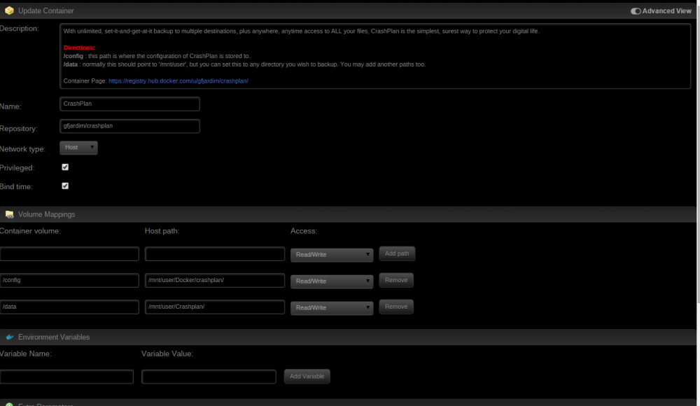

  10. Where is it keeping the temp files or whatever it makes? I'm getting an unraid error that the docker img is filling up until it purges the backup to my destination drive. Would liek to pass in a variable to let the temp files go somewhere else (cache drive) until its ready to spit out the backup to the real destination :update: found it. Was simply the /tmp directory. Mapped that to a tmp folder in the docker folder and good to go. no more docker img filling up when backing up more than 30 gigs (all i have free int he docker image)
