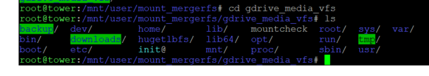

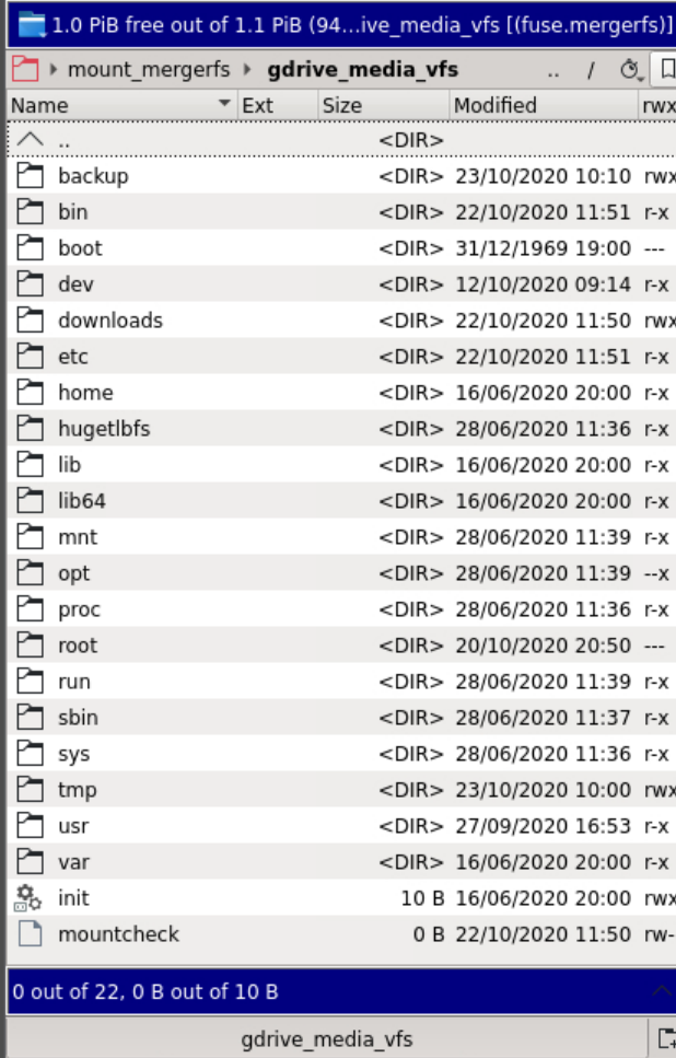

Just set this up using the new mount script (posted a few pages back by @DZMM) seems to working and uploading fine. Created two folders (via mount script backup and downloads) in gdrive_media_vfs crypt remote, and question is should I be seeing all these other folders in /mnt/user/mount_mergerfs/gdrive_media_vfs (attached images)? Thanks
