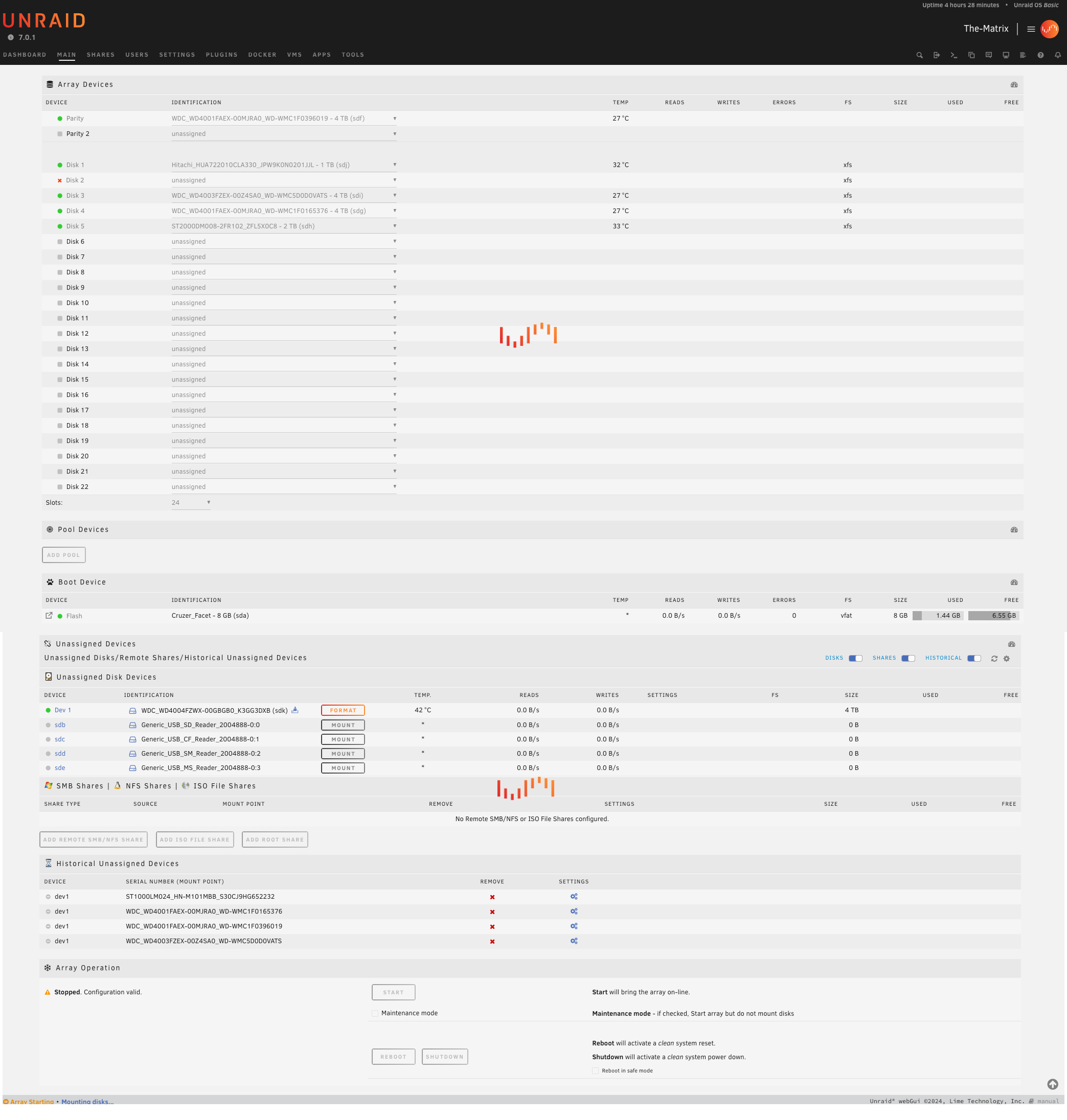

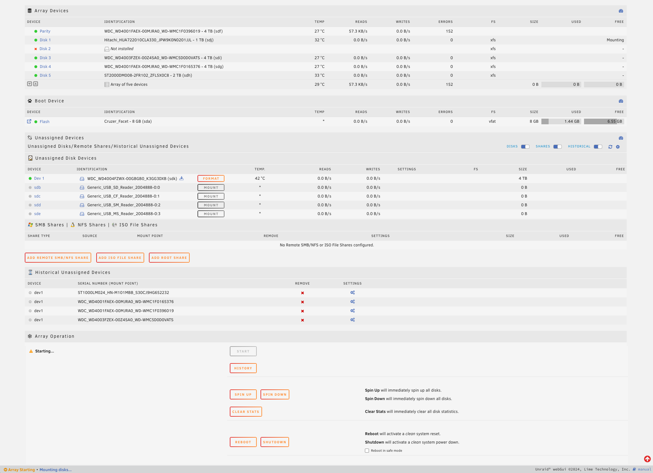

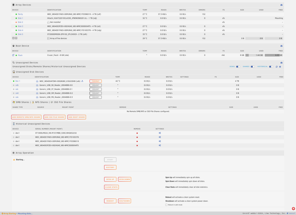

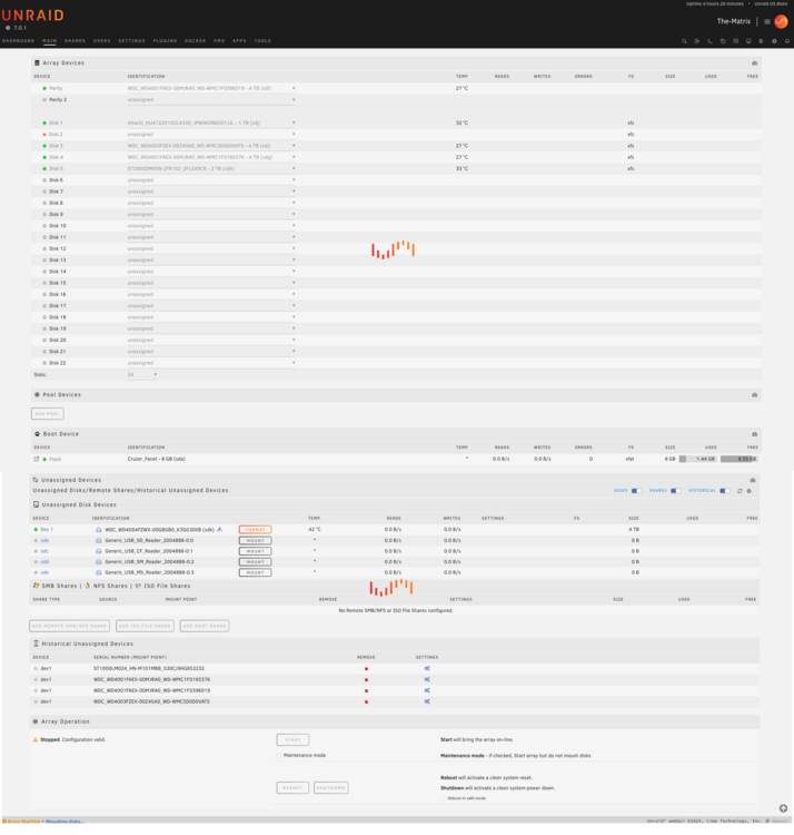

  7. If start the array, the little wavy logo animation shows and stays that way for over 30 minutes. Usually, that's when I refresh the page. It says the array is "starting" and that the 1tb drive is mounting. I have attached the diagnostic at that stage. I also attached a screenshot of the array starting and after I refresh it, I hope that helps. the-matrix-diagnostics-20250502-1407.zip
  8. The only way I can get the array to start is to remove that drive. Will that still provide useful information?
  9. I am replacing a 1tb drive with a 4tb to increase capacity. When I try to start the array to rebuild the data for that drive, I have a separate drive that I have not previously had issues with, the drive won't mount so the array never starts. It kinda locks up the system as I can't restart or shutdown since it is still trying to mount the drive. I have hard restarted and started the array in maintenance mode, the xfs status comes back with no errors, and the long SMART test comes back with no errors. Where do I go from here?
