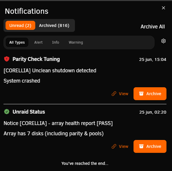

  1. No more unclean shutdows so i can confirm the scheduled TRIM job was the root cause. Thank you all for your feedback.
  2. Update: TRIM was scheduled for 2:00 AM. A manual TRIM took 2–3 minutes, which perfectly matches the timing of the unclean shutdowns on my NVMe cache pool. I have rescheduled TRIM to run at a completely different time, far away from the shutdown window. Last night, the script executed the server shutdown perfectly. The server started manually this morning with no errors, confirming that the overlapping schedules were the root cause. I'll monitor the system and the new TRIM schedule for a few days to make sure it's fully resolved. New diagnostics added. corellia-diagnostics-20260626-1106.zip

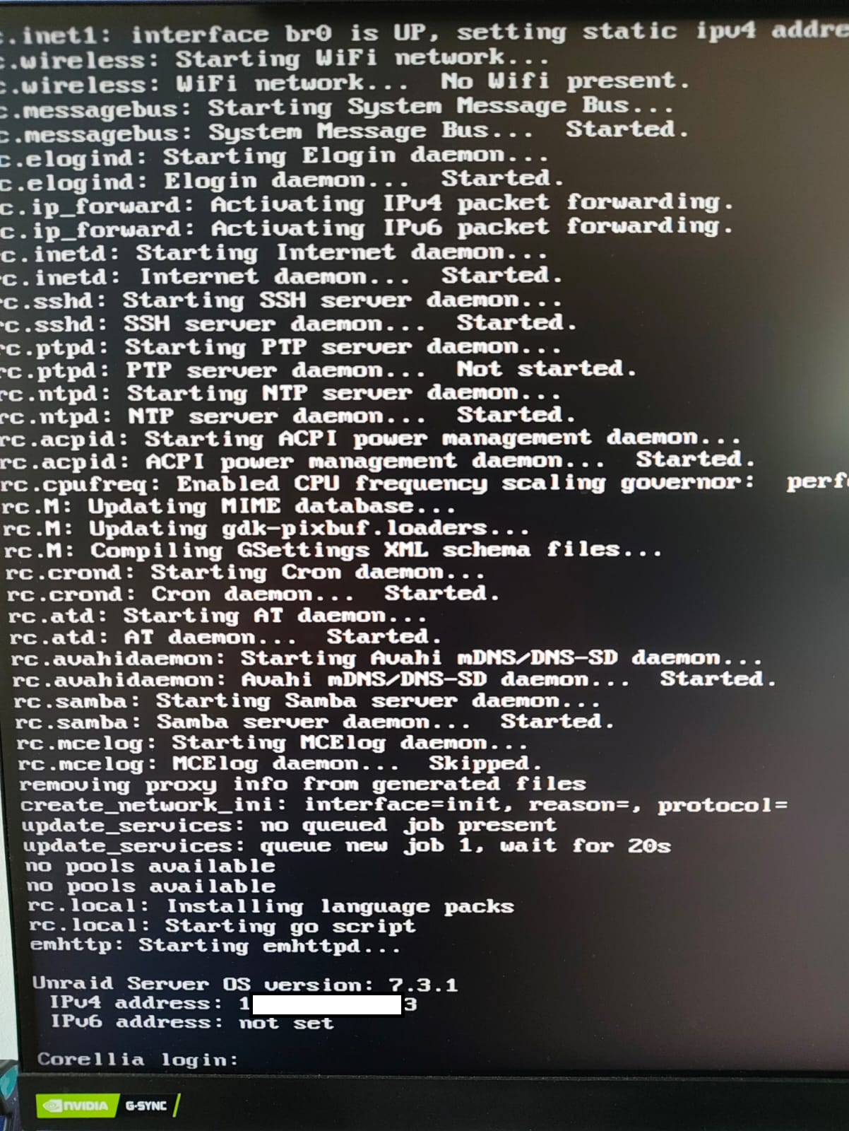

  3. Hi, sorry for the delay. Today I finally had time to check the scheduled BIOS power-on. With a monitor hooked up to the server, I followed the whole startup process and didn't notice anything wrong. The server took about 3 minutes in total from power-on to the login prompt, and nothing looked abnormal (attached is a screenshot of the boot screen). The boot finished at 15:03, but the server error occurred at 15:04, even though it never rebooted itself or failed during that time. Once again, however, the same notifications appeared. I also performed a manual shutdown and boot, and it didn't return any errors. I even tried turning the server on in the morning before the scheduled time, and there were also no errors. Everything was running as usual—just a few containers and plugins, and no VMs. corellia-diagnostics-20260625-1516.zip

  5. Hi all, Two days ago, I noticed a notification reporting an unclean shutdown, which triggered a parity check as expected. However, for the last three days, including today, I have been receiving the same notification. My server is configured to power on every day at 3:00 PM through the BIOS and shut down every day at 2:00 AM, except on Friday and Saturday nights, using a basic custom script: /usr/local/sbin/powerdown Cron schedule: 0 2 * * 1-5 Everything was working correctly until Monday. Based on the notifications, it does not appear that the scheduled shutdowns are failing. The unclean shutdown alert is being generated about four minutes after startup, around 3:05 PM. On Tuesday, I started the server manually, and it shut down four minutes later, just as it does when it starts automatically at the scheduled time. One thing worth mentioning is that after the unclean shutdown notification, the server appears to start normally. All services seem to work as expected, and the parity check is automatically triggered, just as it should be after an unclean shutdown. From a functional standpoint, everything looks normal apart from the repeated unclean shutdown alerts. To be honest, I can't find anything useful in the logs, so I'm sharing the diagnostics in the hope that someone can identify the root cause of this issue. Thx in advance! corellia-diagnostics-20260610-1624.zip
