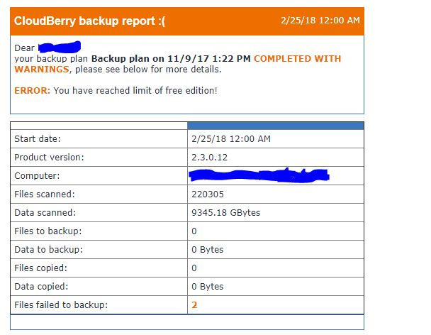

  7. Hi All, Sorry if this is in the wrong spot, please let me know if it is. Have been a very long time unraid user and finally took the plunge and added a P2000 after getting a wicked deal on a used one. Everything is working great but there is some fan noise. While playing with nvidia-smi I noticed that when idle the fan is at 66-67%. I was looking at different switches and noticed that if I ran nvidia-smi -l and let it cycle, by the 3rd refresh the fan is down to 48% and the noise is gone. Since the server sits next to my desk, I've gotten in the habit of opening a terminal window and just letting it run minimized. Works good but I'm thinking I'm really not fixing anything. Any ideas on: why the command slows the fan? or Any other way to permanently slow the fan? or Any way to fix the fan (as I don't want to return the board). Thanks for any suggestions. when idle Sun Jan 31 13:17:18 2021 +-----------------------------------------------------------------------------+ | NVIDIA-SMI 455.45.01 Driver Version: 455.45.01 CUDA Version: 11.1 | |-------------------------------+----------------------+----------------------+ | GPU Name Persistence-M| Bus-Id Disp.A | Volatile Uncorr. ECC | | Fan Temp Perf Pwr:Usage/Cap| Memory-Usage | GPU-Util Compute M. | | | | MIG M. | |===============================+======================+======================| | 0 Quadro P2000 Off | 00000000:01:00.0 Off | N/A | | 67% 36C P0 18W / 75W | 0MiB / 5059MiB | 0% Default | | | | N/A | +-------------------------------+----------------------+----------------------+ while running nvidia-smi -l Sun Jan 31 13:16:49 2021 +-----------------------------------------------------------------------------+ | NVIDIA-SMI 455.45.01 Driver Version: 455.45.01 CUDA Version: 11.1 | |-------------------------------+----------------------+----------------------+ | GPU Name Persistence-M| Bus-Id Disp.A | Volatile Uncorr. ECC | | Fan Temp Perf Pwr:Usage/Cap| Memory-Usage | GPU-Util Compute M. | | | | MIG M. | |===============================+======================+======================| | 0 Quadro P2000 Off | 00000000:01:00.0 Off | N/A | | 47% 35C P8 4W / 75W | 0MiB / 5059MiB | 0% Default | | | | N/A | +-------------------------------+----------------------+----------------------+
  8. Thanks djoss. I thought that may be a limit for public storage which makes no sense since this version doesn’t include that. However, I was backing up 290gb for maybe 6 weeks then bumped it to just shy of 1tb until this week (you can see my plan is from nov). They worked fine. Guess I’ll buy a license, but want to make sure that’s the issue. Thanks again.
