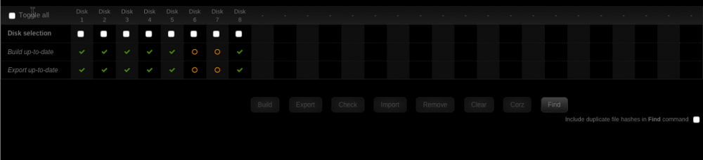

  6. Hi all, Finally decided to transition my MacOS Devices from AFP to SMB connections and I'm noticing randomly disappearing folders after they've been connected for awhile (usually about 6-12 hrs the folders start to disappear). It tends to happen more on shares with larger file counts, but it's basically making SMB unusable for my use case where I'm serving media files via Plex (on a Mac, not docker). I'm going to try to disable SMB Cache enumeration, but that shouldn't affect machines running macOS High Sierra or newer (and doesn't in my FreeNAS environments). Thanks
  7. It looks like I was mistaken with the "Save new hashing results to flash" being the cause of my issue. I woke this am to some drive over heating warnings as this plugin was again walking through every file on my array, even though all my builds were showing up to date (and the disk it was currently walking through had no media added to it). I did still have "Automatically protect new and modified files on", however, if this is supposed to only generate and check for hashes on new content, does this need to scan of every item in the array?
  8. After doing some more testing, it looks like the setting "Save new hashing results to flash" is what is causing the the system to rescan every file every day, rather then just updating the previously exported hashes. Once I disabled this setting, I'm no longer getting the hours of reads on my drives. Looks like I'll just need to export my hashes manually if I want them on the flash key. Thanks!
  9. Thanks, Looking at my Processes that are running, I'm seeing Bunker scanning files and inotifywait running with the following: root 32155 21440 0 11:30 ? 00:00:00 /bin/bash /usr/local/emhttp/plugins/dynamix.file.integrity/scripts/bunker -Aq1 -b2 -f /boot/config/plugins/dynamix.file.integrity/saved/disks.export.20180814.new.hash /mnt/disk1/TV/File1.m4v root 32173 32155 3 11:30 ? 00:00:01 /usr/bin/b2sum /mnt/disk1/TV/File1.m4v root 32392 21440 0 11:30 ? 00:00:00 /bin/bash /usr/local/emhttp/plugins/dynamix.file.integrity/scripts/bunker -Aq1 -b2 -f /boot/config/plugins/dynamix.file.integrity/saved/disks.export.20180814.new.hash /mnt/disk1/TV/File2.m4v root 32723 21440 0 11:30 ? 00:00:00 /bin/bash /usr/local/emhttp/plugins/dynamix.file.integrity/scripts/bunker -Aq1 -b2 -f /boot/config/plugins/dynamix.file.integrity/saved/disks.export.20180814.new.hash /mnt/disk1/TV/File2.m4v root 32744 32723 3 11:30 ? 00:00:01 /usr/bin/b2sum /mnt/disk1/TV/File3.m4v root 19889 2 0 11:31 ? 00:00:00 [kworker/u8:1] root 21439 1 0 Aug13 ? 00:00:05 inotifywait -dsrqo /var/run/hash.pipe -e close_write --exclude ^/mnt/disk[0-9]+/(.*docker\.img$|.*\.AppleDB/|.*\.tmp$|.*\.nfo$|.*\.temp$|.*\.itdb$|.*\.DS_Store$|\.Trash\-99/|docker/|.*\.AppleDB/|.*\.DS_Store$) --format %w%f /mnt/disk1 /mnt/disk2 /mnt/disk3 /mnt/disk4 /mnt/disk5 /mnt/disk6 /mnt/disk7 /mnt/disk8 root 21440 1 0 Aug13 ? 00:01:25 /bin/bash /usr/local/emhttp/plugins/dynamix.file.integrity/scripts/watcher A -b2 (.*docker\.img$|.*\.AppleDB/|.*\.tmp$|.*\.nfo$|.*\.temp$|.*\.itdb$|.*\.DS_Store$|\.Trash\-99/|docker/|.*\.AppleDB/|.*\.DS_Store$) /mnt/disk1 /mnt/disk2 /mnt/disk3 /mnt/disk4 /mnt/disk5 /mnt/disk6 /mnt/disk7 /mnt/disk8 root 22768 21440 0 11:32 ? 00:00:00 /bin/bash /usr/local/emhttp/plugins/dynamix.file.integrity/scripts/bunker -Aq1 -b2 -f /boot/config/plugins/dynamix.file.integrity/saved/disks.export.20180814.new.hash /mnt/disk1/TV/File4.m4v root 22789 22768 3 11:32 ? 00:00:04 /usr/bin/b2sum /mnt/disk1/TV/File4.m4v root 23381 2 0 11:27 ? 00:00:00 [kworker/1:2] root 23931 2 0 11:27 ? 00:00:00 [kworker/3:2] root 24814 15807 0 11:19 ? 00:00:00 [afpd] And if I look at the integrity tab, it is showing Drive 1 as Up-todate though Bunker appears to be parsing it (with drive 6 and 7 not up to date, even though they were about 30 minutes ago and no media has been added or modified). See attached Thanks for your help!

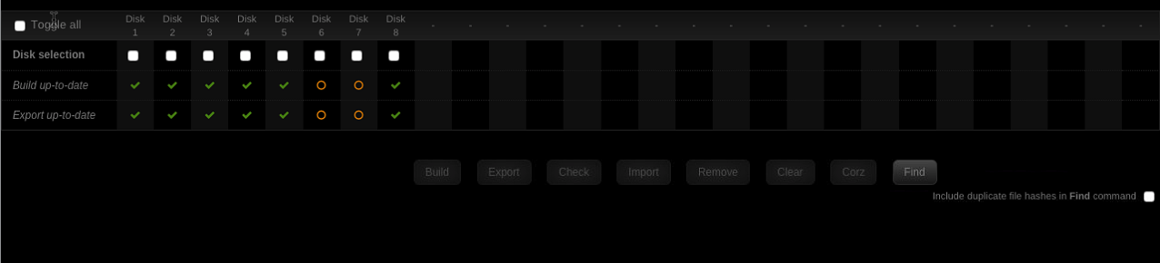

  10. Thanks Benson. It seems every day I'm getting the "O" on random drives in the array, even if no new files are added, and I'm getting a lot of reads on drives for hours in the background since enabling the "auto". Is there a way to see what the plugin is doing when run automatically in the gui? I know I can see manually run operations but can't see anything in the log regarding an auto run. Thanks
  11. Hi When "Automatically protect new and modified files" is turned on, is the entire drive that the new file is added to scanned and recalculated, or just the new/modified file? Also, I'm noticing that the "build up-to-date" on a few of my drives is showing "O" even with the auto protect option turned on. Thanks!
