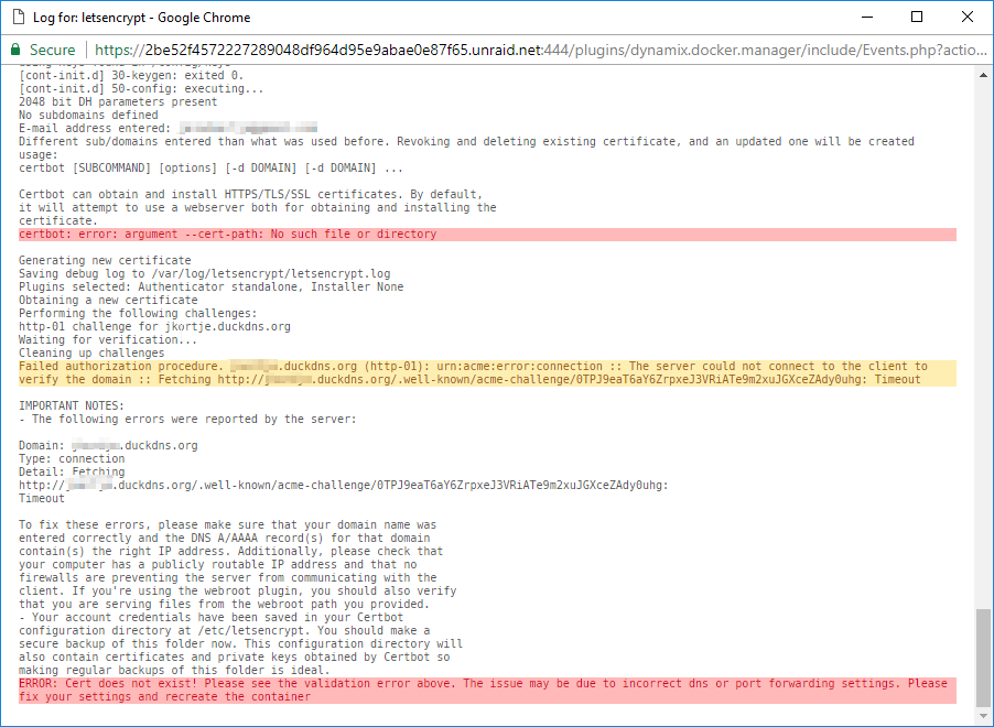

  9. 443 is forwarded. If there is no input for Int (Internal port), then it uses the same port (443). Regardless, I added 443 just to be safe. No luck. As you suggested, I modified the DOMAIN NAME to include my subdomain, I removed the SUBDOMAIN(S) variable, changed 'ONLY SUBDOMAINS' to 'false' and restarted the docker. Same results. I just did what you suggested and still no luck...
  10. I'm really struggling with this as well guys. Been doing all the required reading and browsing through everyone's comments without luck. I've done the following: Upgraded to 6.4.0 (was previously on 6.3.5 and it wasn't working then either) Due to 6.4.0 upgrade, I changed the default SSL port for UNRAID to 444 Ensured HTTPVAL is set to true. Removed and re-added http container port Changed container http container port to 8083 Ensured port forwarding is working for port 8083 via telnet What am I missing guys? This shouldn't be this difficult...
