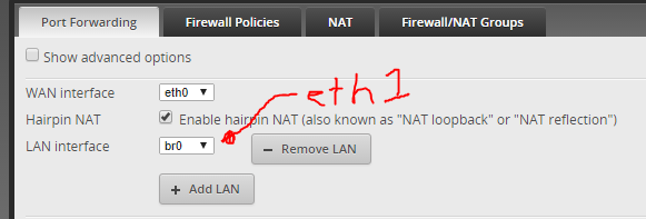

  13. Thanks all, I just figured it out. I have an Ubiquiti ERL and even though I had NAT reflection checked my LAN interface was set to eth1. I changed that to br0 and everything started working! Attached is a screenshot for all the n00bs out there like me!
  14. trajpar started following Docker Containers
