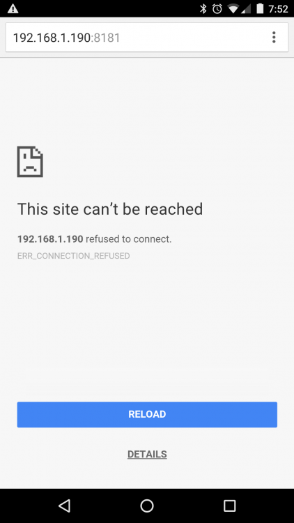

  16. Yes, I am on the same network. I get the same error when using my laptop. I have five other dockers that are working fine, and I am able to connect the there respective app gui's. Attached are the logs. Thanks again for the help! plexpy.txt
  17. Thanks for the reply. I gave it a try and still received the same error.
  18. Hello all, For the life of me I can't figure out why I am unable to access Plexpy from my web browser (Chrome). I keep getting a connection refused error. I don't have any other dockers running on port 8181 that I know of. Any thoughts?
