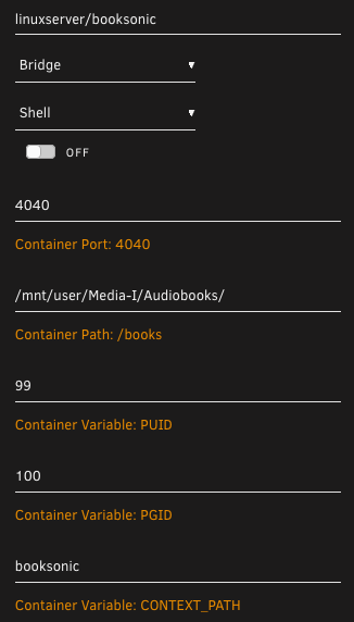

Hi.
I seem to have an issue connecting to the server.
This is my configuration:
I have the docker container running on port 4040.
In my my router port 4040 is forwarded to my server.
When I try to add a server in the app I add the following:
Server address:
http://[mypublicip]:4040
Local network address Http://192.168.1.2:4040
But when I test the connection the following error message appears:
Connection failure. Resource not found, please check the server address.

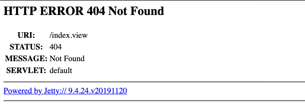

If I enter the URL
In my browser this appears:
Error 404 - Not Found.
No context on this server matched or handled this request.
Contexts known to this server are:
favicon.ico Powered by Jetty:// 9.3.14.v20161028
If I enter the URL http://[mypublicip]:4040/booksonic
In my browser I connect to the admin page just fine.
Do you have any suggestions to what I'm missing?
/L
Thank you for suggestion.
However after I added "booksonic" to the URL it worked.
(Local network address Http://192.168.1.2:4040/booksonic
And
http://[mypublicip]:4040)
Removing context path would mean you don't need to add booksonic to your path, that's why I suggested it.....
Thanks again man, I didn't know that... Now I do ?
