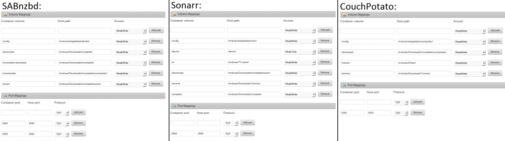

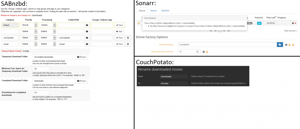

  6. Hi, I am having problems with Sonarr and moving them to my TV folder after SABnzbd finishes the download. My setup works 100 % for CouchPotato, but Sonarr refuses to move the finished downloads. I get the following error message in Sonarr when it tries to move the download SABnzbd has finished: "No files found are eligible for import in /sonarr/(Series name)" I have attached a screenshot of my unRAID volume mappings for SABnzbd, Sonarr and CouchPotato (I included the CouchPotato setup because it works). I have also attached a screenshot of my settings within SABnzbd, Sonarr and CouchPotato. Does anyone have any idea why Sonarr fails at importing the finished downloads? Edit: Is there any point in using separate folders for Sonarr and CouchPotato, or should I just keep it simple and use a Downloads/Complete folder for both? The reason I set it up this way is because of my old setup on my Windows server, which followed this guide: http://www.cuttingcords.com/home/ultimate-server/newsgroups-and-sabnzbd - If you have any default or standard setup you would rather recommend that I use, feel free to enlighten me :-)

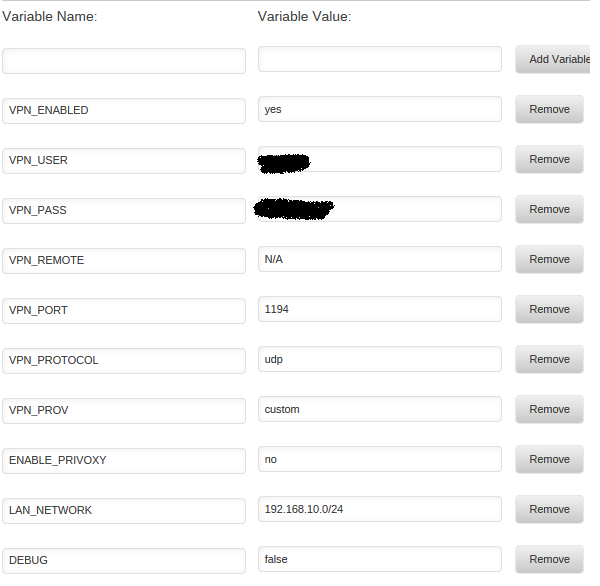

  7. Thanks binhex, I tried your suggestion (remove remote setting, delete the files in the openvpn-folder and replace with new ones directly from Newshosting). Same error (AUTH_FAILED), even though I am 110 % sure that the password and username is correct. See attached image of my new settings (with remote removed) and attached log with the AUTH_FAILED error. No idea what I am doing wrong. Note: I have also tested DelugeVPN with VPN_ENABLED=no, just to check if I am able to access the webUI without the VPN. That works perfectly, so it seems like the problem is my VPN settings... EDIT: I solved the problem, I had to add "@newshosting" to my username to successfully log in. Easy solution. Thanks for quick replies to help me out! Now I'll just have to test and see what kind of speed I can get with the Newshosting VPN... EDIT2: Thanks again for helping me, the setup (and speeds) is working exactly like it did on my old Windows-based server :-) DelugeVPN_log1.txt

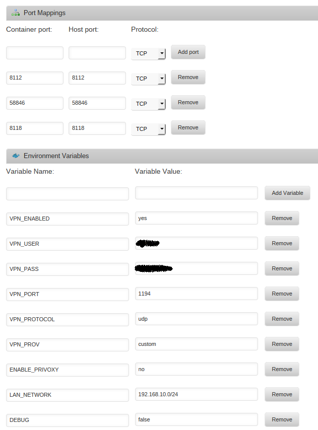

  10. I have tried to change my password 2-3 times, but I keep getting AUTH_FAILED no matter what password I use (and I only use a-z and 0-9), last time a total of 12 letters. I have attached my docker settings (image), and this is the log: [info]Starting OpenVPN... 2016-02-14 13:56:03,904 DEBG 'start' stdout output: Sun Feb 14 13:56:03 2016 OpenVPN 2.3.9 x86_64-unknown-linux-gnu [sSL (OpenSSL)] [LZO] [EPOLL] [MH] [iPv6] built on Dec 24 2015 Sun Feb 14 13:56:03 2016 library versions: OpenSSL 1.0.2f 28 Jan 2016, LZO 2.09 Sun Feb 14 13:56:03 2016 WARNING: file 'credentials.conf' is group or others accessible 2016-02-14 13:56:03,904 DEBG 'start' stdout output: Sun Feb 14 13:56:03 2016 Socket Buffers: R=[212992->212992] S=[212992->212992] 2016-02-14 13:56:04,238 DEBG 'start' stdout output: Sun Feb 14 13:56:04 2016 UDPv4 link local: [undef] Sun Feb 14 13:56:04 2016 UDPv4 link remote: [AF_INET]81.171.71.67:1194 2016-02-14 13:56:04,249 DEBG 'start' stdout output: Sun Feb 14 13:56:04 2016 TLS: Initial packet from [AF_INET]81.171.71.67:1194, sid=c5a8c828 d9257952 2016-02-14 13:56:04,249 DEBG 'start' stdout output: Sun Feb 14 13:56:04 2016 WARNING: this configuration may cache passwords in memory -- use the auth-nocache option to prevent this 2016-02-14 13:56:04,325 DEBG 'start' stdout output: Sun Feb 14 13:56:04 2016 VERIFY OK: depth=1, C=US, ST=VPN, L=VPN, O=VPN, OU=VPN, CN=VPN, name=VPN, emailAddress=VPN 2016-02-14 13:56:04,325 DEBG 'start' stdout output: Sun Feb 14 13:56:04 2016 Validating certificate key usage Sun Feb 14 13:56:04 2016 ++ Certificate has key usage 00a0, expects 00a0 Sun Feb 14 13:56:04 2016 VERIFY KU OK Sun Feb 14 13:56:04 2016 Validating certificate extended key usage Sun Feb 14 13:56:04 2016 ++ Certificate has EKU (str) TLS Web Server Authentication, expects TLS Web Server Authentication Sun Feb 14 13:56:04 2016 VERIFY EKU OK Sun Feb 14 13:56:04 2016 VERIFY OK: depth=0, C=US, ST=VPN, L=VPN, O=VPN, OU=VPN, CN=vpn, name=VPN 2016-02-14 13:56:05,327 INFO success: webui entered RUNNING state, process has stayed up for > than 1 seconds (startsecs) 2016-02-14 13:56:05,327 INFO success: deluge entered RUNNING state, process has stayed up for > than 1 seconds (startsecs) 2016-02-14 13:56:10,420 DEBG 'start' stdout output: Sun Feb 14 13:56:10 2016 Data Channel Encrypt: Cipher 'AES-256-CBC' initialized with 256 bit key Sun Feb 14 13:56:10 2016 Data Channel Encrypt: Using 256 bit message hash 'SHA256' for HMAC authentication Sun Feb 14 13:56:10 2016 Data Channel Decrypt: Cipher 'AES-256-CBC' initialized with 256 bit key Sun Feb 14 13:56:10 2016 Data Channel Decrypt: Using 256 bit message hash 'SHA256' for HMAC authentication 2016-02-14 13:56:10,421 DEBG 'start' stdout output: Sun Feb 14 13:56:10 2016 Control Channel: TLSv1, cipher TLSv1/SSLv3 DHE-RSA-AES256-SHA, 2048 bit RSA Sun Feb 14 13:56:10 2016 [vpn] Peer Connection Initiated with [AF_INET]81.171.71.67:1194 2016-02-14 13:56:12,885 DEBG 'start' stdout output: Sun Feb 14 13:56:12 2016 SENT CONTROL [vpn]: 'PUSH_REQUEST' (status=1) 2016-02-14 13:56:12,897 DEBG 'start' stdout output: Sun Feb 14 13:56:12 2016 AUTH: Received control message: AUTH_FAILED 2016-02-14 13:56:12,898 DEBG 'start' stdout output: Sun Feb 14 13:56:12 2016 SIGTERM[soft,auth-failure] received, process exiting 2016-02-14 13:56:12,899 DEBG fd 9 closed, stopped monitoring (stdout)> 2016-02-14 13:56:12,899 DEBG fd 14 closed, stopped monitoring (stderr)> 2016-02-14 13:56:12,899 INFO exited: start (exit status 0; expected) 2016-02-14 13:56:12,900 DEBG received SIGCLD indicating a child quit Can you see anything I might have to change? I can also attach the supervisord.log if needed. Is there any other information, other than username/password, that I should remove from the log file before posting it here?
