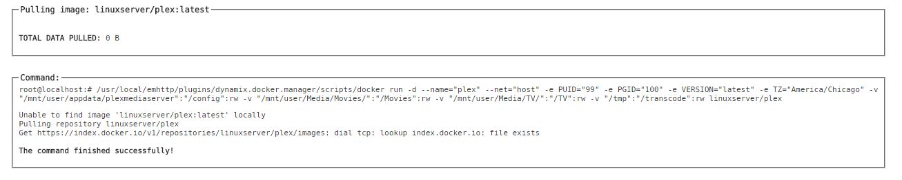

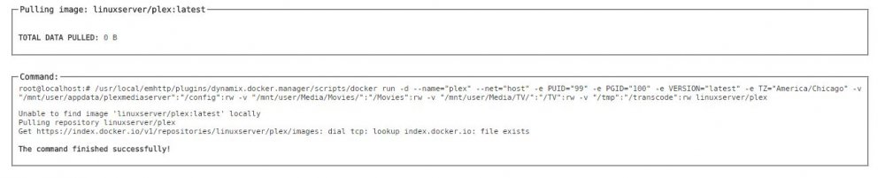

  20. I have a question, and I can't seem to find an answer anywhere. I was having issues with my Plex Docker earlier, and went to delete the image and re add it, as this has fixed the issue before. However when I went to add it back, it would show success but it wouldn't be in the list of docker apps. I ended up deleting the entire docker image planning on readding everything with my previous templates, but they all do the same thing now. This is what it shows when I attempt to add a container:
