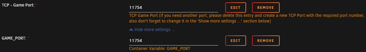

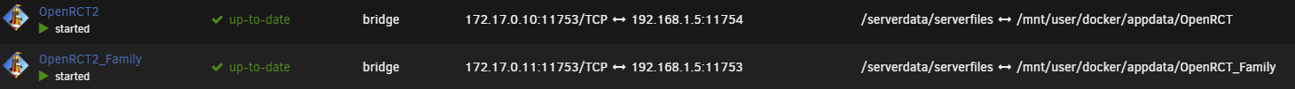

  3. @ich777, appreciate the speedy response! Thanks for clarifying that I had to physically delete the port variable: I was under the impression that all I needed to do was delete the main entry from the unraid GUI. All that really needs to be done is to edit the TCP - Game Port Configuration and modify both the host and container ports so they're the same. My only suggestion for this Docker container is to change the language in the description to clarify to remove the a parameter TCP - Game Port and create a new port configuration variable or even just clarify to modify the port configuration for both host and container. Anyways, I just created three different instances and it's all up and running now. Thanks for your help!
  4. Has anybody had any luck running multiple OpenRCT Docker instances? I can get one running with the default port settings but when I start create another instance and change the default ports, say for example in the picture below: I get the "Unable to connect to server" error when trying to connect to the game on my internal network. FYI, I do have port forwarding set up already for all the ports I've specified for OpenRCT. Are there any additional settings that I need to modify such as the config file? FYI, here are my docker container settings: and the docker command:
