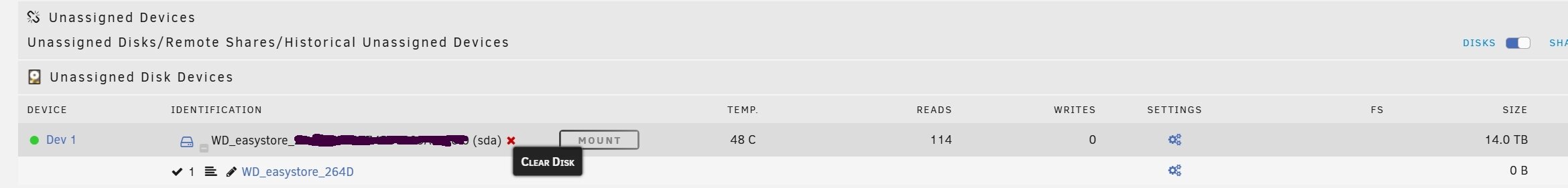

  6. Thanks. Do I have to click the X mark and "Clear Disk" before I get the "mount" button? (Currently greyed out) (See screenshot) I plan to add this disk to the array later to replace a smaller drive and that's why I thought of preclearing it. But now it appears "clear disk" will remove the pre-clear signature and unraid will "go through the lengthy perocess of clearing it again"when I add this to arary later. All I want to do now is to copy data from the smaller drive in the array into this so that I can change the file system of that drive from RSF to xfs and copy data back. After that I want to replace that smaller drive in the array with this one. My understanding is copy data this way is the only way to change FS since I don't have any space left in the array and no extra drive bays. Any suggestions?
  7. I successfully precleared an unassigned disk attached via USB but after that I don't see an option to mount it. Used the unassigned devices plugin.. what am I doing wrong here? I wanted to mount this outside the array and copy data from an array disk into it so that I can change the file system on the array disk and copy the data back into it.
